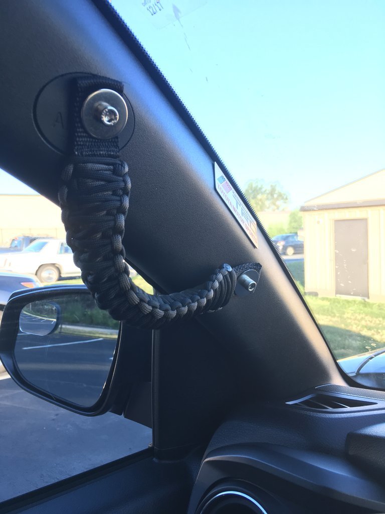

    Some NutSerts would work in those holes.

    didn't think about that. that'd be perfect. something to think about for a possible ram ball mount too. which way does the airbag deploy? that might hurt.

    Looks like the top hole might already be threaded by were that Panel is attached, at about the 47 second mark in the video you can see.

    yeah. the top one is threaded. that's how the a pillar stays attached. under the airbag logo cover thing.

    Think it's hard for a company to make something due to a airbag being so close to that area. A company might be liable if the handle somehow interfere with its deployment. Tundra doesnt have the handle to.

    This was my fix for the drivers side grab handle...
    Parts list-
    Grab Handle:Bartact TAOGHRPBG - Jeep Wrangler JK Rear Side Sound Bar Paracord Grab Handles (PAIR) - Made in USA - BLACK/GRAPHITE
    Nut Sert: 1/4-20 from Lowes
    Socket cap bolt: 1/4-20x 1-3/4" -2" Length may vary. from Bolt Depot
    Socket cap bolt: 6mm x 1.0mm x 35mm. from bolt depot
    Washers: 1/4 x 1" from bolt depot
    Spacers:
    Rubber 1/4" x 1/2"x 3/4"
    Rubber 1/4" x 3/4" x 3/4"
    Spacer size may vary

    What did you use and what did you have to do to mount it? Thanks
