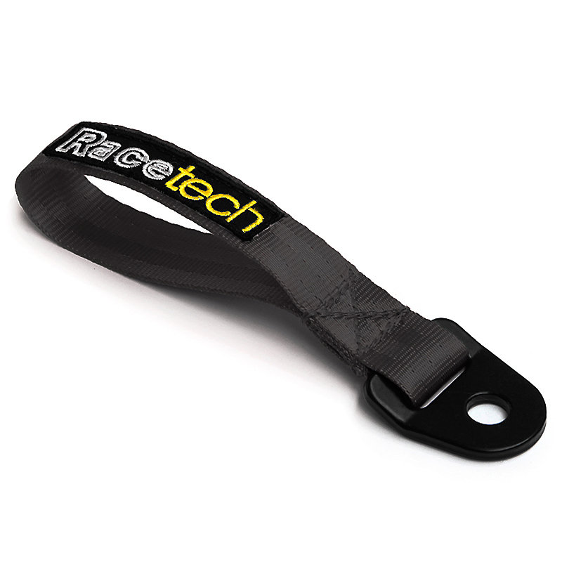

    I am a Toyota Quality Control Engineer for all 2017 Tacomas. Don't use threaded fasteners. That would be dangerous going into the airbag. Use this. We use a lot of this shit.

    I was thinking of something like this...

    That would be good for the single bolt we do have. Good find!:thumbsup:

    I didn't want to be the first with trial and error.maybe someone can do one and start a thread how to
