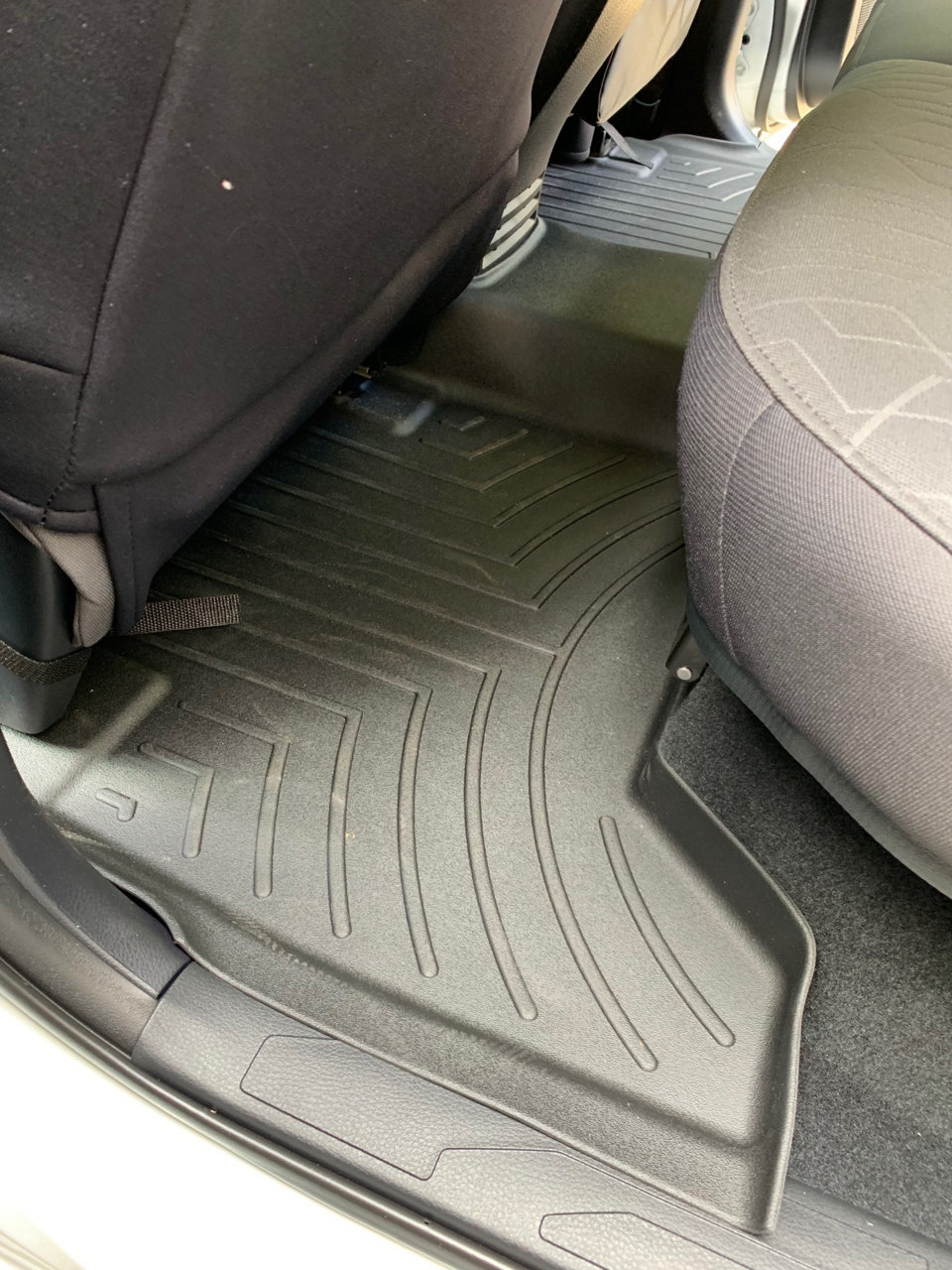

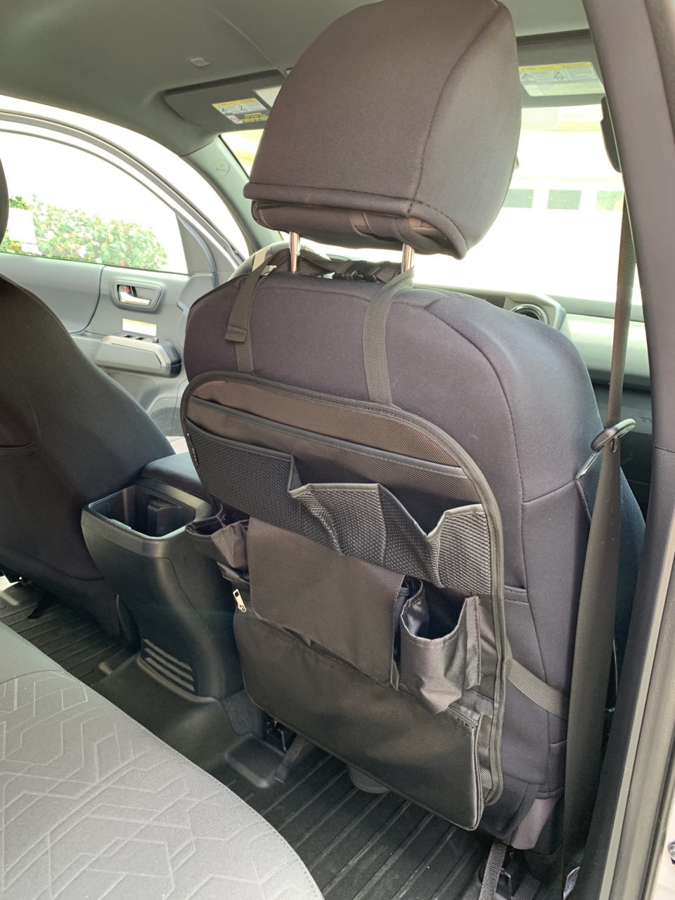

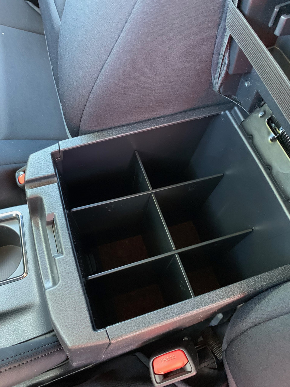

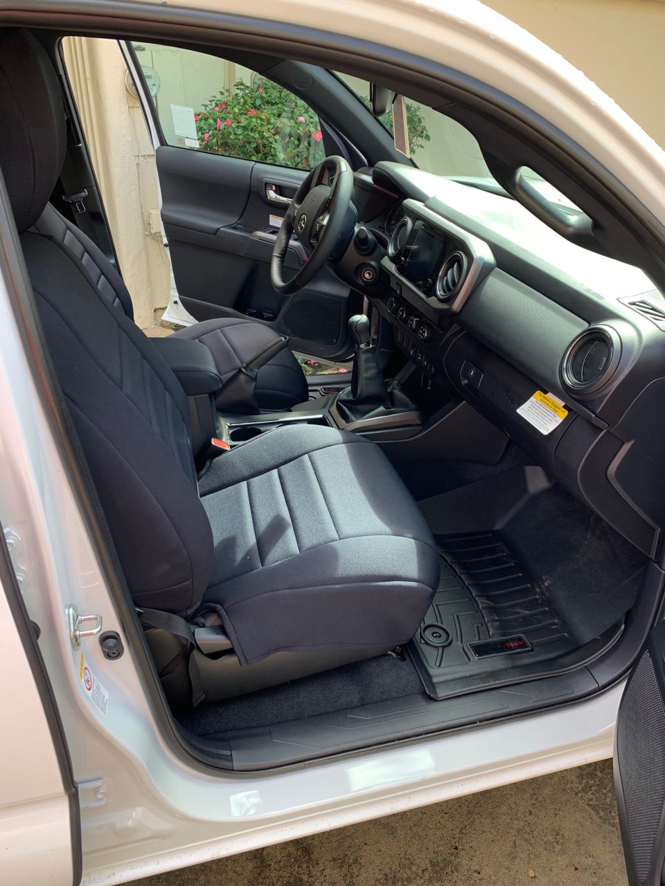

    Finally had a chance to start in on some modifications today...
    1. First up was the TRD Pro grille as this really improves the look over the stock setup.

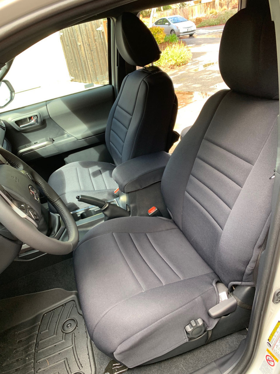

    2. Next was the Wet Okole Seat covers. These were a bit difficult to install due to their tight fit and finicky straps however the once they you get them lined up properly the fit great and have excellent fit and finish. I feel confident that these will be able to take some abuse.

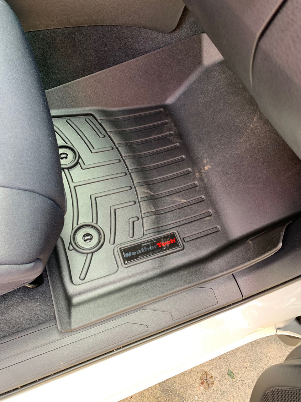

    3. For floor protection we went with the Weathertech fitted floor mats (which even have special design to accommodate the cloth pedal on MT models). The fit is superb and I can't wait to see these covered in Siberian mud.

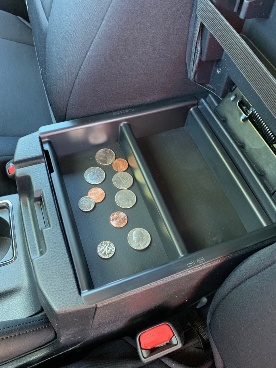

    4. To help arrange many small items such as chargers, battery packs, adaptors, etc we went with the Vehicle OCD glovebox organizer and tray. I really like the design which makes the most out of the small space by having so many separate compartments. The fit and finish is also top notch so we will also be adding the vehicle OCD glovebox organizer in the future.
    5. We found a seat back organizer on Alibaba for a fraction of the cost of the "overland" organizers and decided to give it a shot. We were pleasantly surprised by huge sturdy this thing is so we will likely use it on at least one of the seat backs.

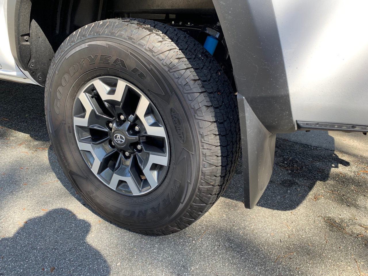

    6. Finally we added some OEM mud flaps which are made of hard plastic. I'm not sure if these will rub when I get the 33in KM3s so I may need to cut them down in the future or get some rubber ones.

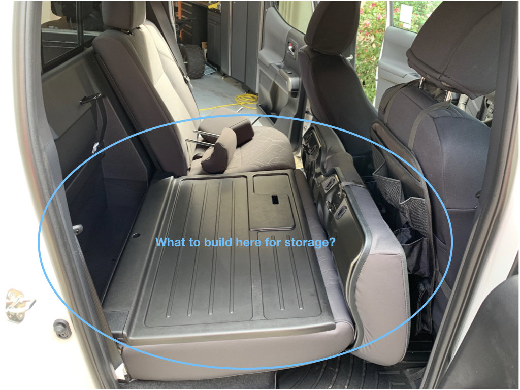

    7. I am planning on removing the 60 portion of the rear seats leaving only the single rear seat on the driver side...Does anyone have idea how to best utilize this space for storage of heavy items such as tools, drinking water, camping gear, recovery gear, etc? See a picture of the space I am referring to attached below
    Til next time...

    Excellent! Do keep in touch as I think it would great to swap stories if our routes/ timelines cross.
    Wow another one! Our rough route was put together with Google Maps stringing together the places that we wanted to see combined with areas that are able to be traversed / borders than can be crossed. We will map out detailed off road sections closer later on using Garmin Open maps, HEMA maps, Google Earth, etc (depending on the country)
    True, we needed a US vehicle to build here and bring back to the states after our journey.

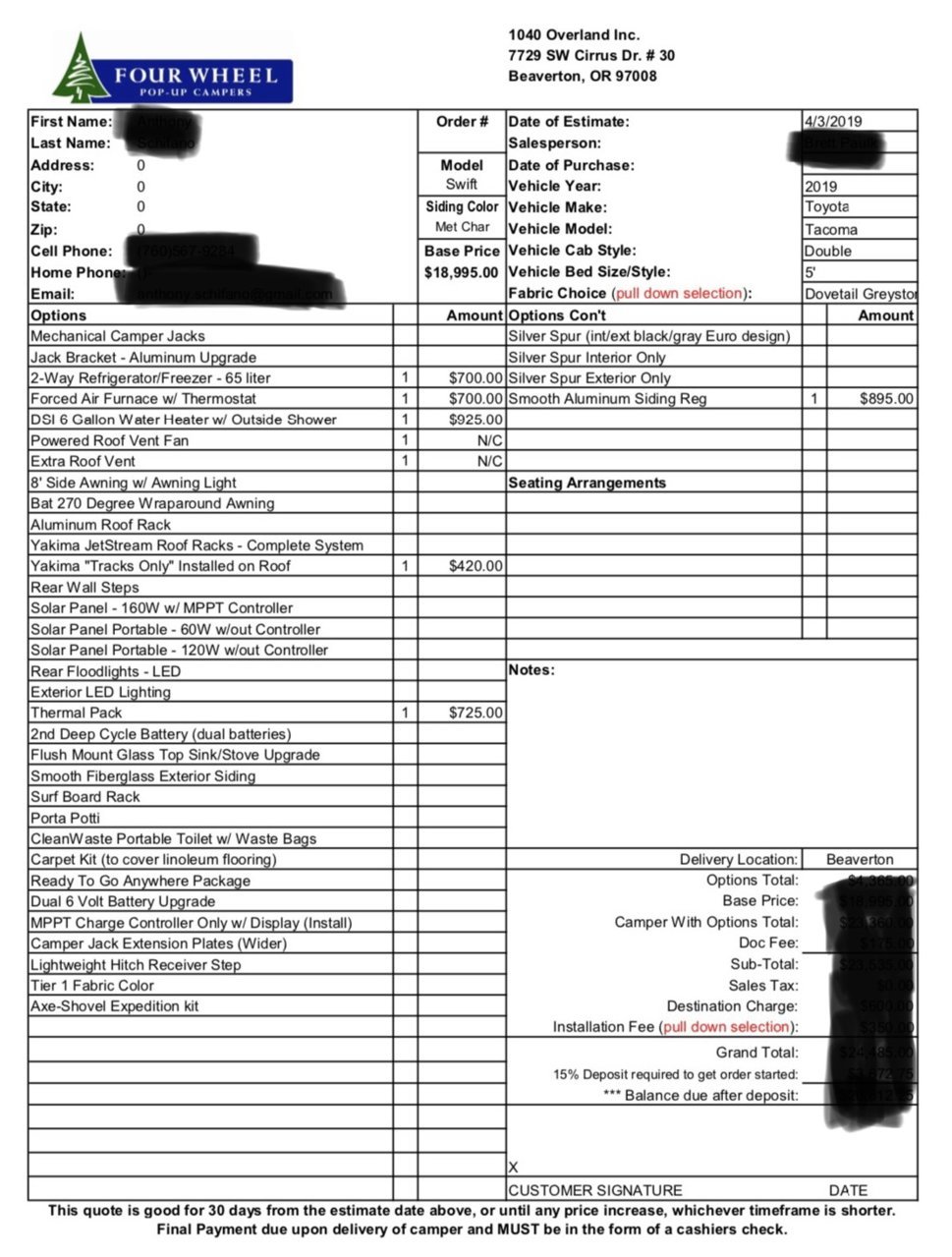

    Update! We just placed the order for our Swift Four Wheel Camper! We decided go with the two roof vents, thermal pack, hot water heater with outdoor shower, and forced air furnace in order to improve general comfort over a wide range of temperatures that we will encounter and to have the ability to wash up while on the road. The two way 65 liter refrigerator also gives us more space to store perishable food while using a relatively low amount of electricity.
    In addition to the options spec'd from FWC we will be adding our own second 12v deep cycle battery in the camper with two 160 watt solar panels, a 400w solar charger controller, an ARB awing with wall attachments, a water filtration system, and some jerry can holders attached to the steel jack mounts.
    Let me know if anyone has any other suggestions for FWC modifications in order to improve general livability, storage, etc.
    PS during the 40% off TRD sale we also managed to purchase the '19 TRD Pro wheels (gloss black) which should look great in combination with our charcoal FWC.

    Look into the red arc DC to DC chargers. They work really well and there’s a lot of people starting to run them. I ran one in the trailer I had and it seems to be the way to go for aux battery charging.

    Congratulations on your order. We put our order for a flatbed Fleet about 4 weeks ago. I would suggest the 2 vents be power vents. It will be hot, you can set one to blow in and the other to blow out. Also, we deleted the solar panel option and went with 3 aftermarket thin film 160 watt panels. Cheaper and more power. Also the Yakima roof rack is still free. We also are using one lithium battery which replaces the 2 factory deep cycle batteries, saving 100 lbs. Finally, we also pleaded with the factory to have 360゚of powerful floodlights. You definitely want that before you step outside in the dark in Africa. Our round the world trip with our Tacoma starts June 1st of next year in Eastern Europe. Let's keep in touch

    Interesting, I will look into this although I am not sure how necessary it is when the standard 12v batteries are wired in parallel with the battery separator thats comes in the FWC. More research needed.
    As far as the vents go yes one of them is a power vent in order to keep air moving through the camper. Can you please provide more details about your Lithium ion setup? This seems interesting as the weight savings would be quite useful.
    For lighting we were also going to add a few of these:
    https://www.amazon.com/dp/B01553D9X...colid=SVLPTP4SYN4U&psc=0&ref_=lv_ov_lig_dp_it
    Yes please do keep in touch! Have you laid out your rough route/ schedule?
