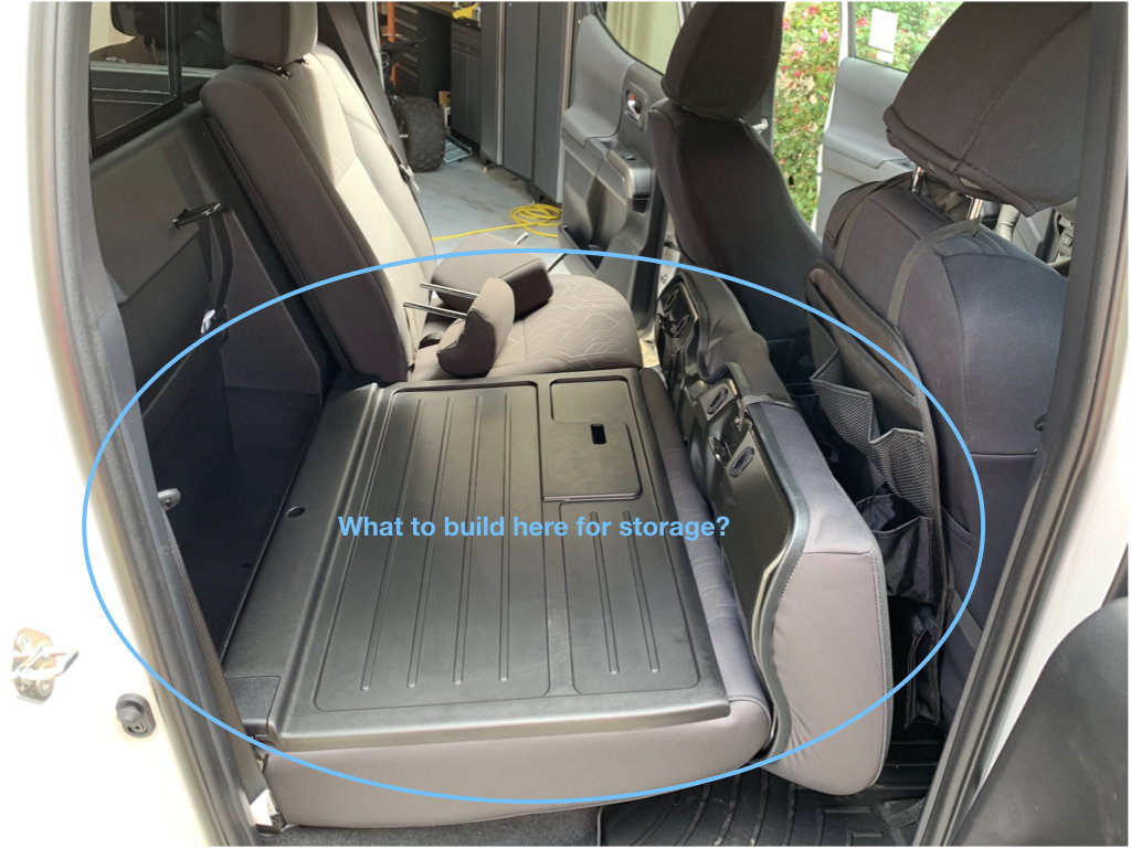

    I like the idea of removing the plastic storage hatches under the seats and replace them with a hatch in the plywood deck. You could also put the plywood deck on a hinge if you don't want have access to a router to get the holes in the plywood deck.

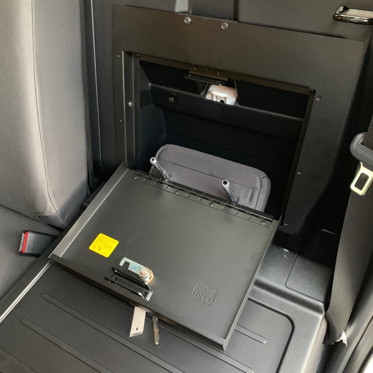

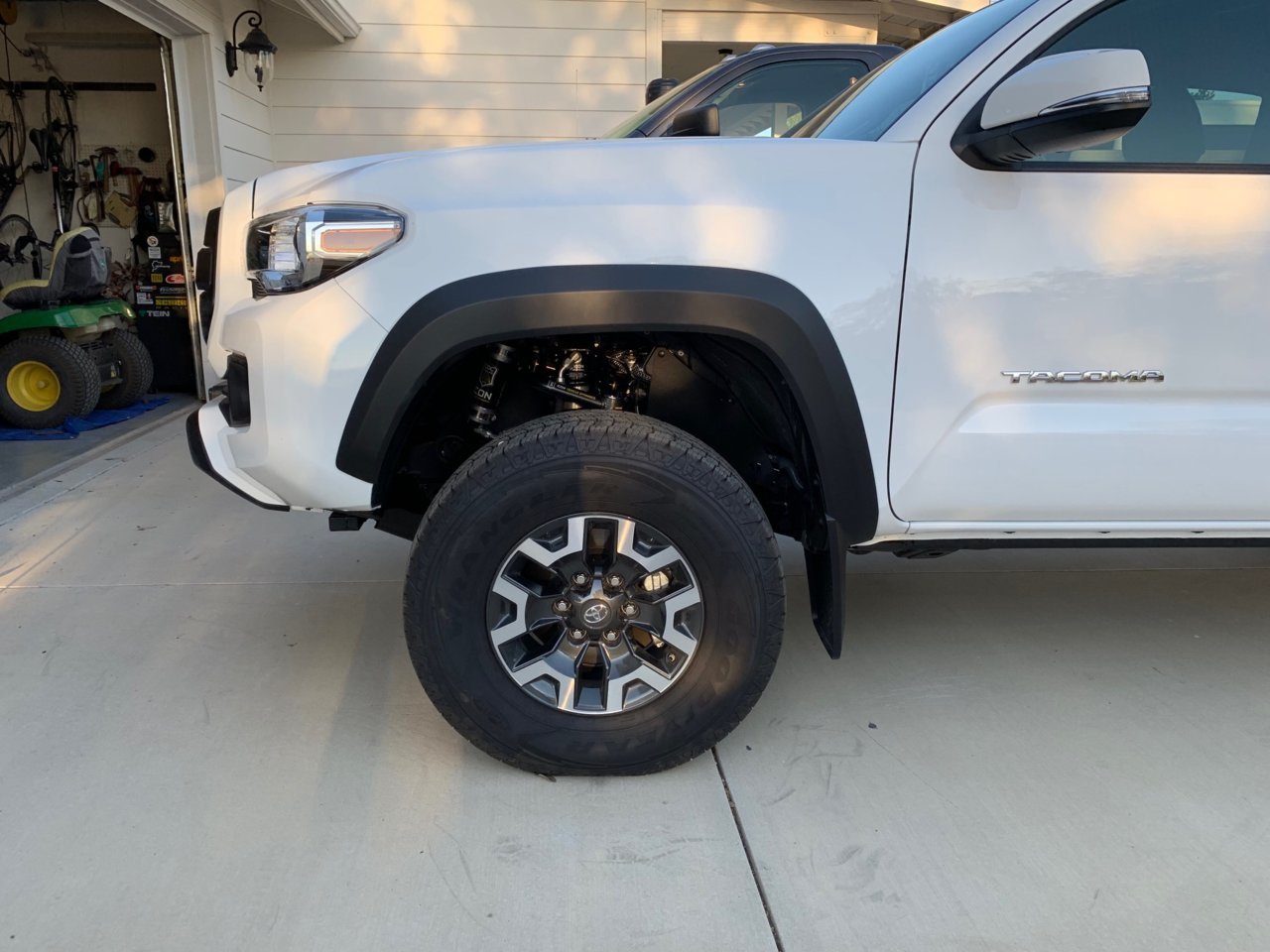

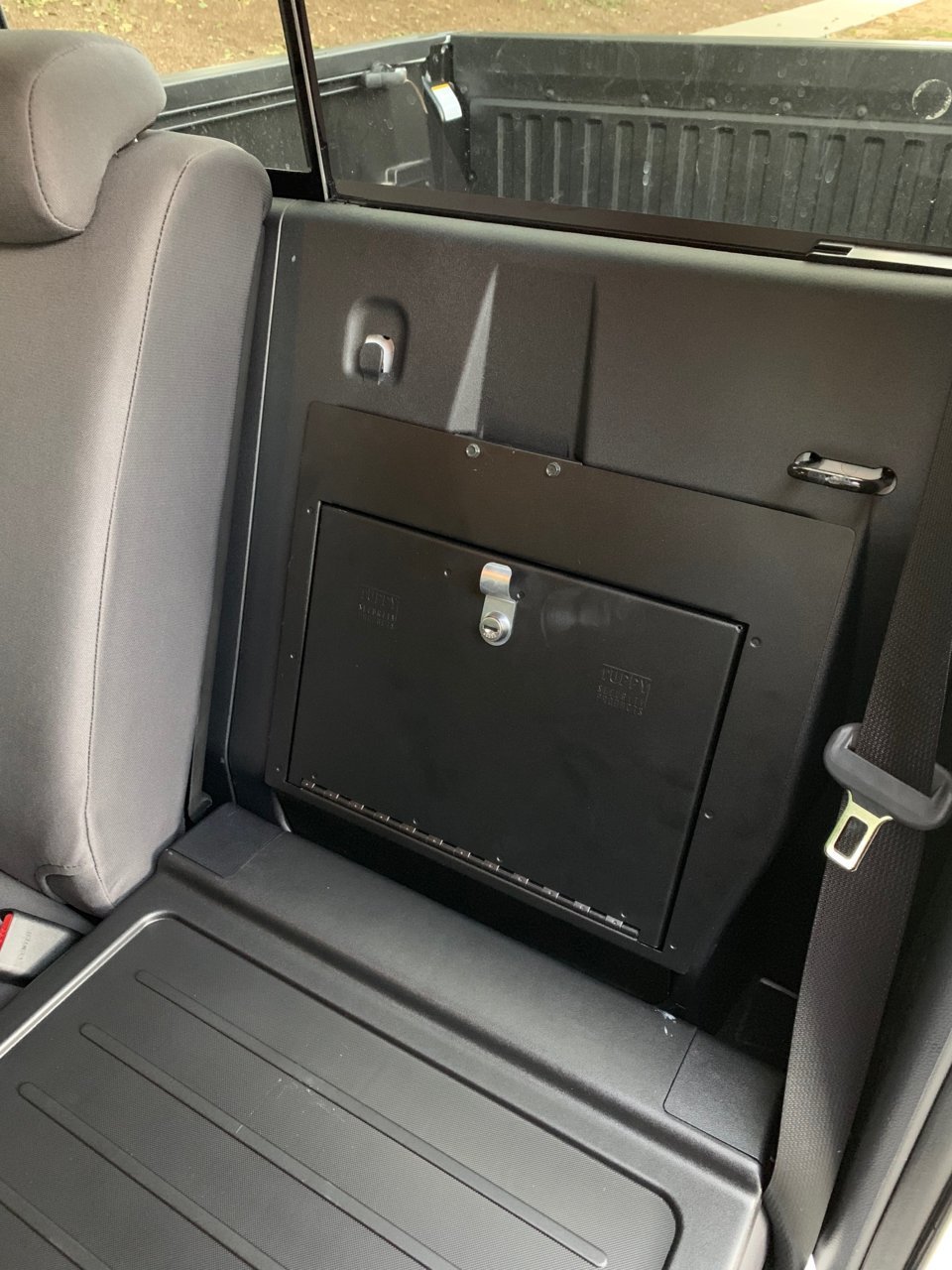

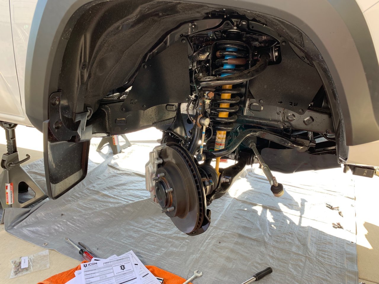

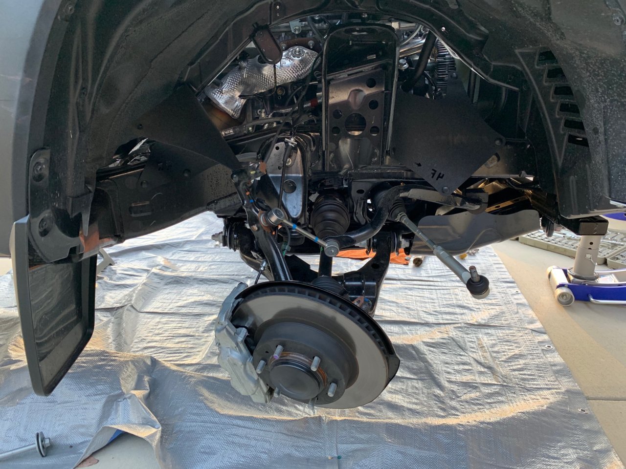

    Update 5/13/19
    I have finally had some time to resume work on Sasha, our 'Round the World Tacoma.
    First up was + 2" stainless steel brake lines from Wheelers Offroad. Installation was straightforward however I ran into some challenges when attempting to bleed the brakes. Despite trying the standard brake bleeding procedure and a bleeder pump, I was unable to get a steady of brake fluid to come out of the bleeder valves. Afters hours of frustration I used my AAA tow for the year to bring the truck to my local Toyota dealer (who was surprise to see a car in service with 400 miles on it [​IMG]). Apparently on my '19 TRD 4x4 Off Road MT an OBD2 scanner with interface is needed to disengage the rear brake solenoid and ABS to follow the brakes to be bled. Obviously this is a huge issue me if I ever need to bleed the brakes on the side of the trail so I am actively looking for a manually override...let me know if anyone knows of one.
    Next up was the Tuffy Security Cubby Cover. The cover mounts easily over the rear storage cover located behind the drive side rear seat and acts as a lockable safe to store important items. I am very impressed with the stealth design as well as the fit and finish.
    The final big job was installing the Icon Stage 6 suspension. Unfortunately I didn't have the bushings needed to mount the OME Dakar heavy rear leaf springs (with +1 add-a-leaf) so I had to settle for bolting up the Icon 2.5in rear shocks with external reservoirs as well as the Icon 2.5 front shocks, tubular UCAs, and external reservoirs. The process was time consuming but relatively straightforward and I only ran into some snags removing and inserting the UCA mounting bolt. I am extremely impressed with the quality of the Icon components and they look like they should hold up well to the punishment of our around the world adventure. The truck rides relatively stiff now but I think that should go back normal once the camper is attached. I also purchased some shock rebuild kits and nitrogen refill needle as I am considering having the shocks refreshed in Europe (our half way point).
    Once our Swift Four Wheel Camper arrives in June I will purchase the BFGs (still trying to decide between KO2 and KM3s) and set the final ride height once I get a better idea of how the truck will sit under load.

    -Custom storage solution in place of rear seats

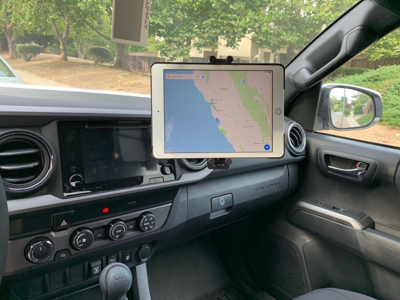

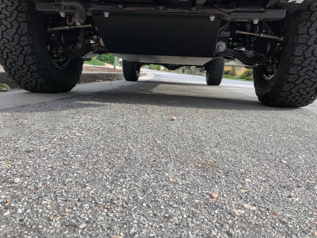

    -Update 6/9/2019
    Finally had some free time to get down to business and get some more installations done! First up was the Toyota OEM garnish for TRD Pro Grille. I would highly recommend for anyone with a 18+ Tacoma with a replica TRD Pro Grille as without this you will likely get a warning message from the collision detection system every time you drive they truck. If your grille already has the proper cutout the installation is as easy as snapping out the out piece and pressing in the new garnish.
    For navigation and central control unit purposes I then mounted the Hondo Garage Tacoma Tablet Mounting Bundle. I initially had some doubts about how sturdy the mount would be but after getting it clipped on the air vent ring and bolted up it was much stronger than I expected. The dexterity of the mount is a huge plus as it can transition between navigation mode for the driver to entertainment mode for the wife in a few second by loosening the knob on the RAM mount elbow.
    Next up was the IFS skid plate from BAMF. I decided to only run the front IFS skid instead of the trilogy due to weight concerns but I love the peace of mind having burly 0.250in thick steel protecting the lowest hanging and most sensitive parts of the underbelly. Installation is also fairly straightforward but I would suggest using a jack to support the plate while you get it into position and bolt it up.
    Lastly was the wheels and tires. After much contemplation and deal shopping I decided to go with 265/75/16 (31.6in diameter) BF Goodrich K02s on TRD Pro Wheels. I heavily considered going with KM3s but given the fact that that the majority (75%+) of the miles we will do on our 'Round the World Trip will be on tarmac I decided the improved drivability and fuel economy of an all terrain is worth the trade off for slightly worse mud performance. As far as the TRD Pro wheels they may be slightly lighter and stronger than the stock alloys but honestly we mainly bought them for looks :).

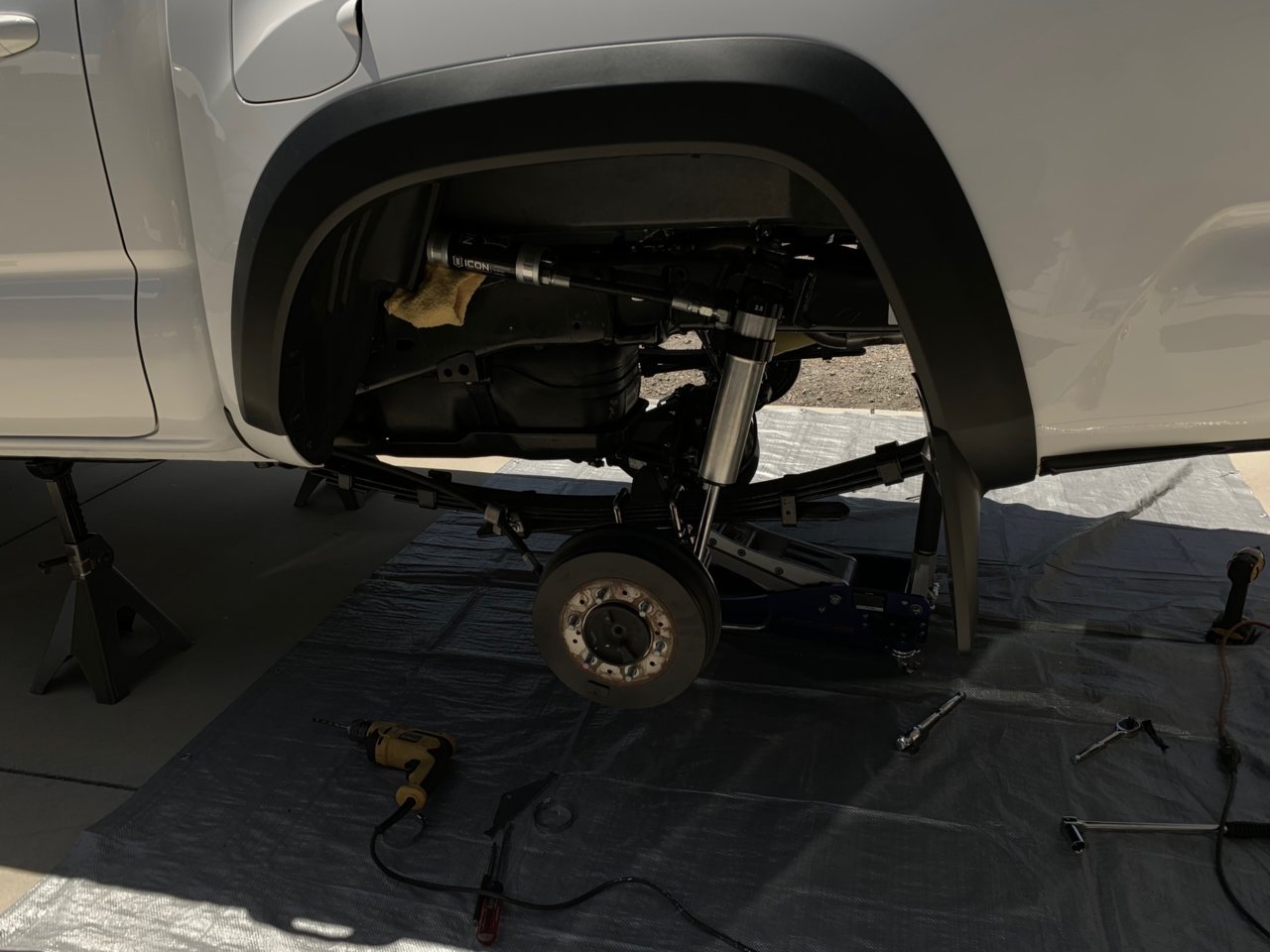

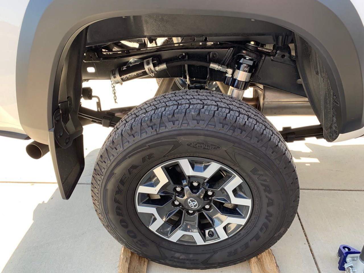

    We are continuing to make progress on our build as time allows and finished some critical items before our camper gets installed this coming week.
    In order to handle the extra weight of the camper we installed the OME Dakar heavy leaf springs with +1 add-a-leaf along with polyurethane bushings and bump stops. The OME leafs springs are significantly heavier and thicker than the OEM springs so the installation was a bit challenging and required some strategic use of ratchet straps in order to get them oriented correctly. As the truck sits without any weight in the bed there is about a 4 inch lift in the rear compared to about a 1.25inch lift on front, resulting in a laughable rake :rofl:. However, with the truck loaded up the ride height should be much more balanced front to rear.

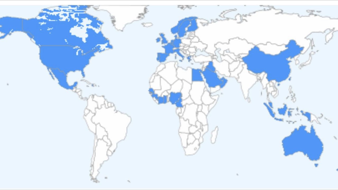

    Sorry if my post sounds kinda like a downer. But my mostly up to date map below gives you an idea of where I’m coming from. (I’m non military but get around)
