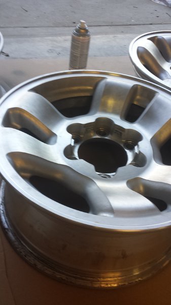

    Thanks for the advice man. The stuff I'm I already purchased is Rustoleum but it states that it cane be used on Aluminum.

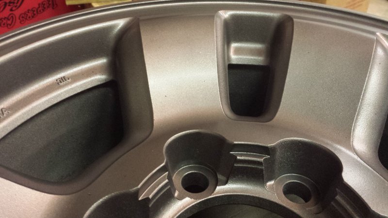

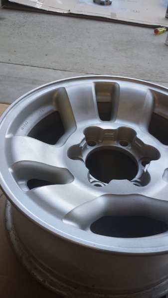

    Here's my progress. I've been undecided on color so Ive only painted one wheel. Stripped old clear with aircraft stripper, degreased, sanded, scotch Brite pad, degreased, 3 coats of self etch primer, 3 base and 3 clear.
    This is the only way I know how to photoshop. :)
    I'm still not sure about the color. Im putting 265/70r16 Toyo At2 on once I get the wheels figured out. Wheels on the truck now are 15's.

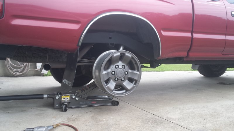

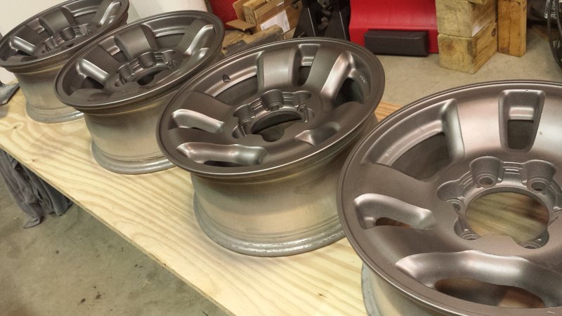

    Finished painting them tonight. I going to give these another day of drying and hope to mount the Toyo AT's on Wed.
    I'm pretty impressed with the Duplicolor paint. It seems pretty tough. I would have prefer a bit more sheen in the clear, but all I had to choose from was matte and gloss(I chose matte).
    I ended up doing 3 coats of etching primer, 2 coats of silver, 3 coats of graphite, and 3 coats of clear. I managed to get by with 1 can of primer, one can of silver, one can of graphite and one can of clear. I have a little bit of each left. I only painted the wheel fronts and center caps. Plenty of paint sprayed through the holes in the front of the wheel that it coated the areas of the wheel that show through the holes. I was wanting to do front and back side of the wheels, but I'm ready to get these things on.

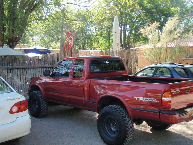

    Was the last picture taken in Monument, CO? Woodmoore center right?
  10. May 31, 2017 at 4:42 PM
    #30
    boostedka
    boostedka Well-Known Member
    Sep 29, 2011
    #64367
    5,997
    James
    NM
    2013 DCSB 6MT, 2004 4runner
    That sounds right. It was a few years ago but IIRC it was at Pikes Peak brewing parking lot

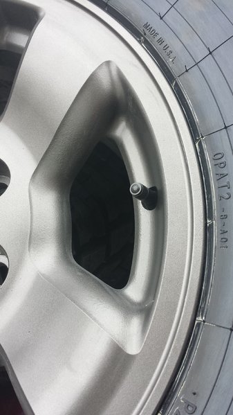

    I know it's silver but Matte Graphite
    TRD4WD likes this.
  15. Jun 1, 2017 at 12:20 PM
    #35
    rybern
    rybern [OP] Well-Known Member
    Apr 3, 2017
    #215281
    2,451
    N Alabama
    2023 TRD OR & 2000 SR5
    5100's & 3AAL, 265/70r17 Toyo AT3
    That looks great. Is that Duplicolor? Looks lighter than graphite but I really like it.

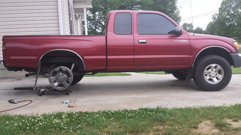

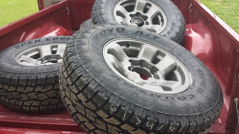

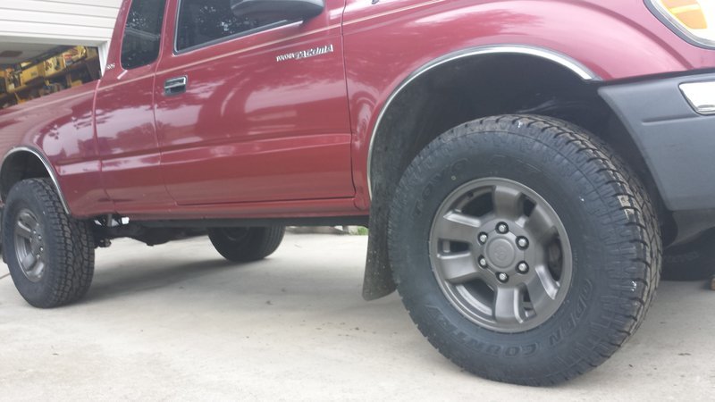

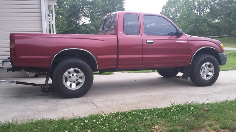

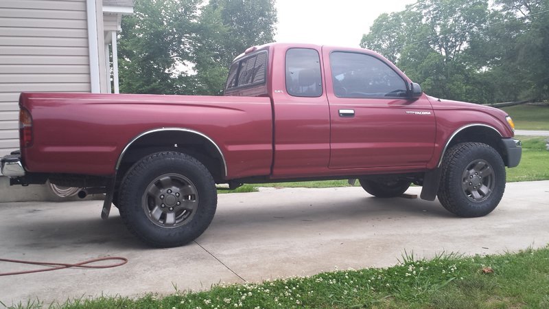

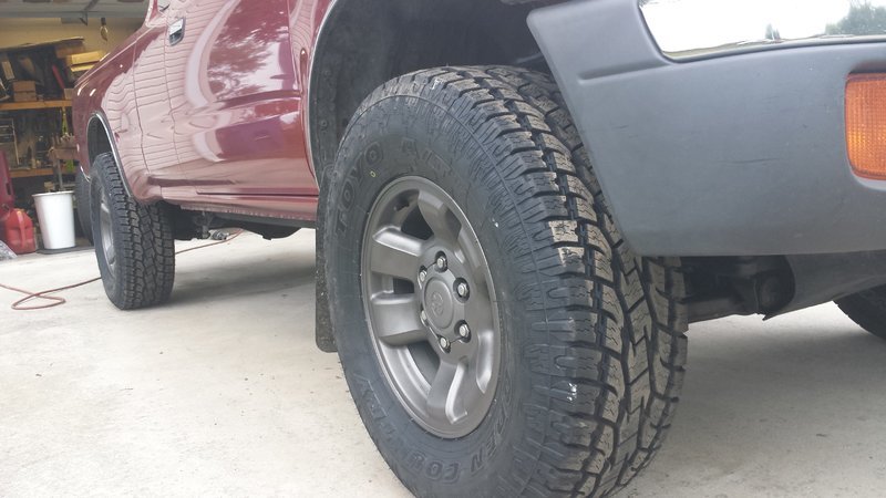

    I'm pretty tickled with wheels and tires. Here's before and after. Went from265/75r 15 Goodyear Wrangler SRA to 265/70r16 Toyo Open Country AT2 (P rated).
    For those just tuning in. This is Duplicolor graphite with Matte clear. Details are earlier in this thread.
    265/75r15 Goodyear SRA
    265/70r16 Toyo AT2

    DupliColor CustomWrap in Matte Graphite :D
    basically DupliColor's version of Plasti-Dip
