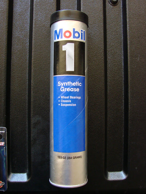

    I used the mobile 1 synthetic grease.
    Will do. Just a note, the zerks on the front drive shaft have a very viscous grease which looked like goopy black water when I greased mine for the first time.
    I have confirmed with my local Toyota dealers master technicians' that they do not use the NLGI grade #1 grease as the FSM calls for. Rather they use NLGI grade #2 for the front and rear drive shaft. This was good for me as I didn't want to have to maintain two sets of grease in my garage.

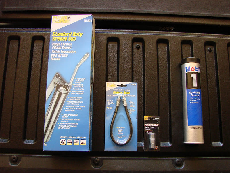

    In case anyone reading this has trouble greasing the front zerks - I always did - the solution is to use a small one hand grease gun. You can easily push coupling on to the zerks. I always had a hard time getting coupling to lock on with the larger two handed gun - the grease always shot out around the zerk instead of going in it.
