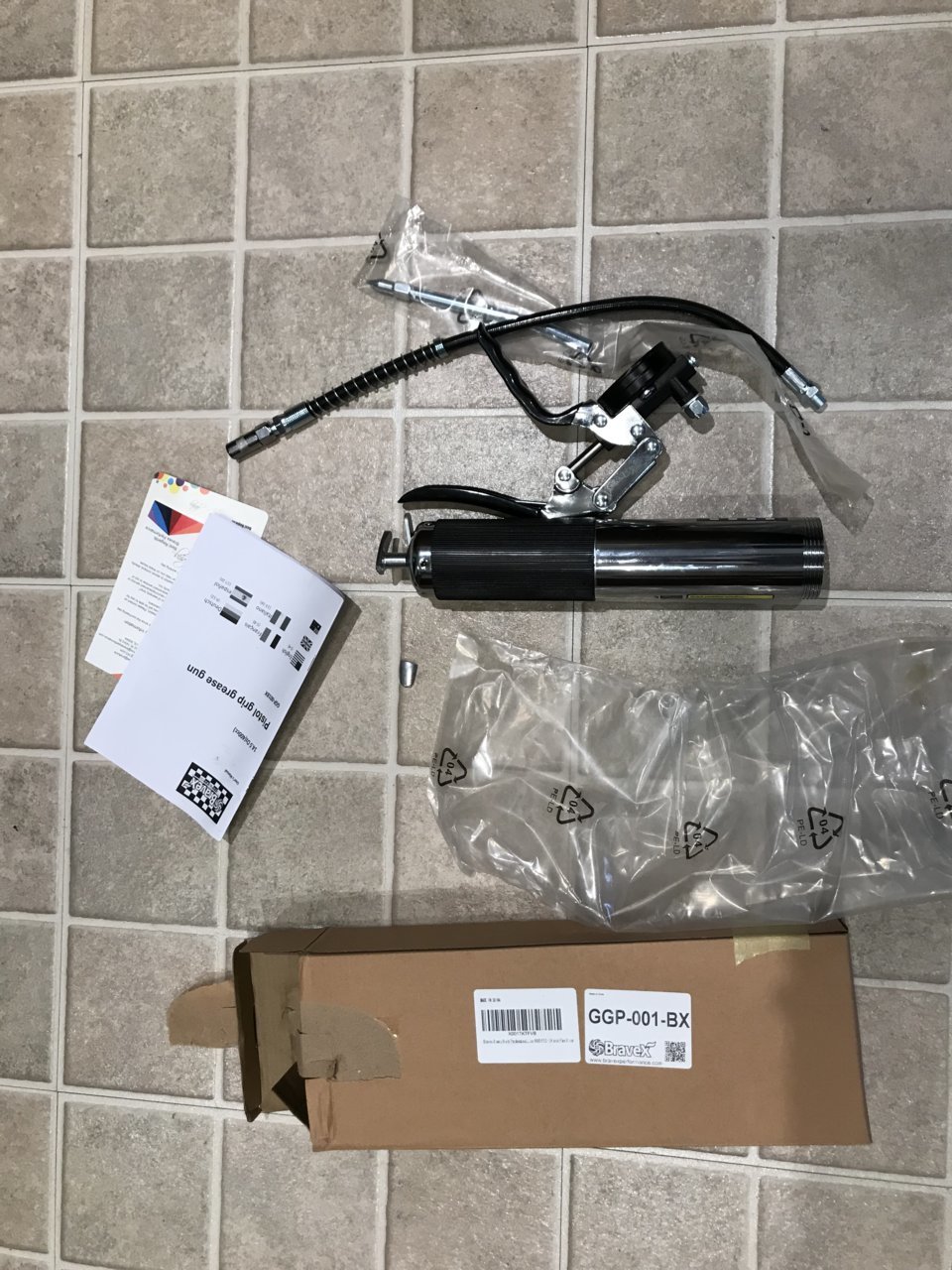

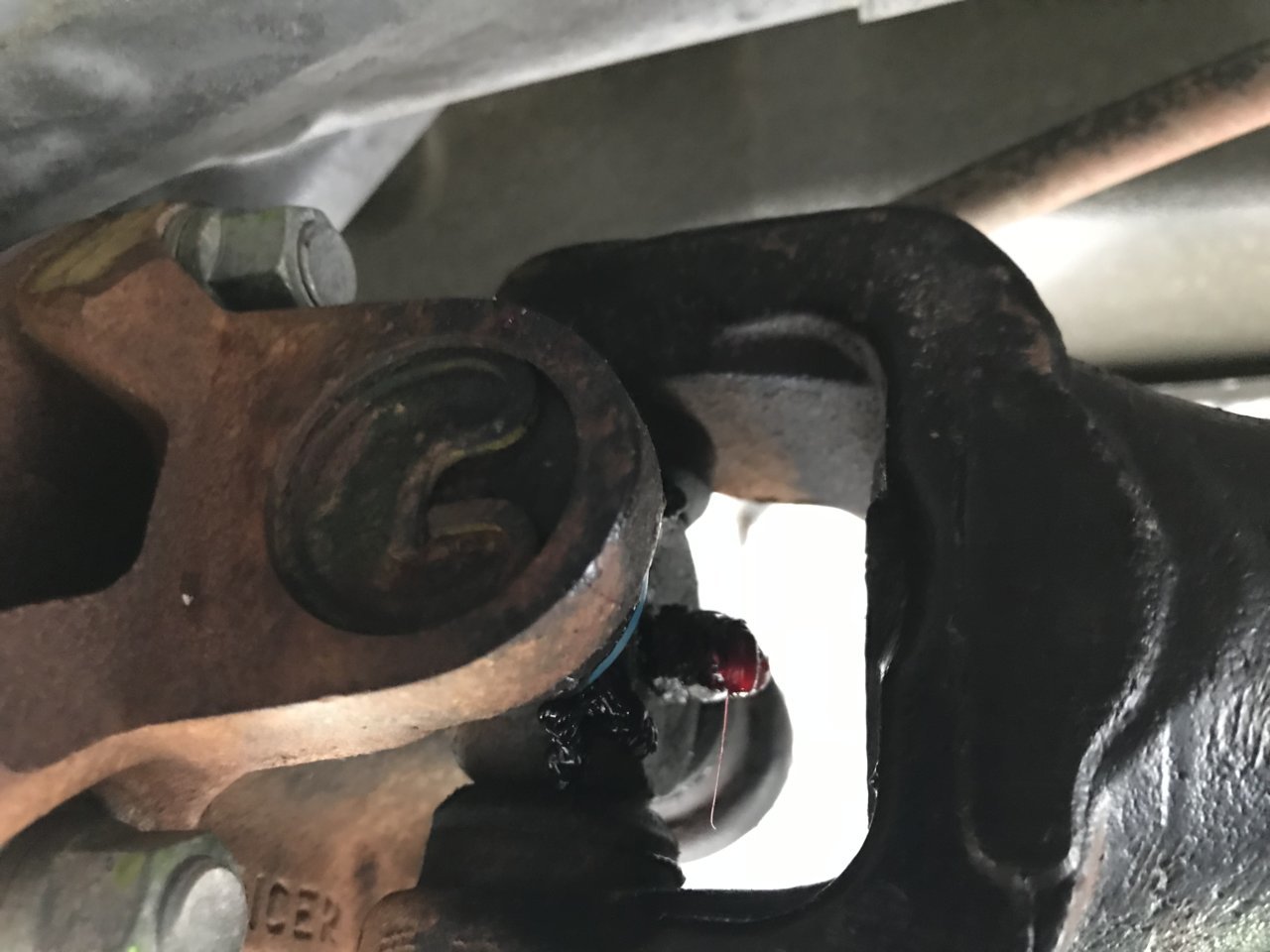

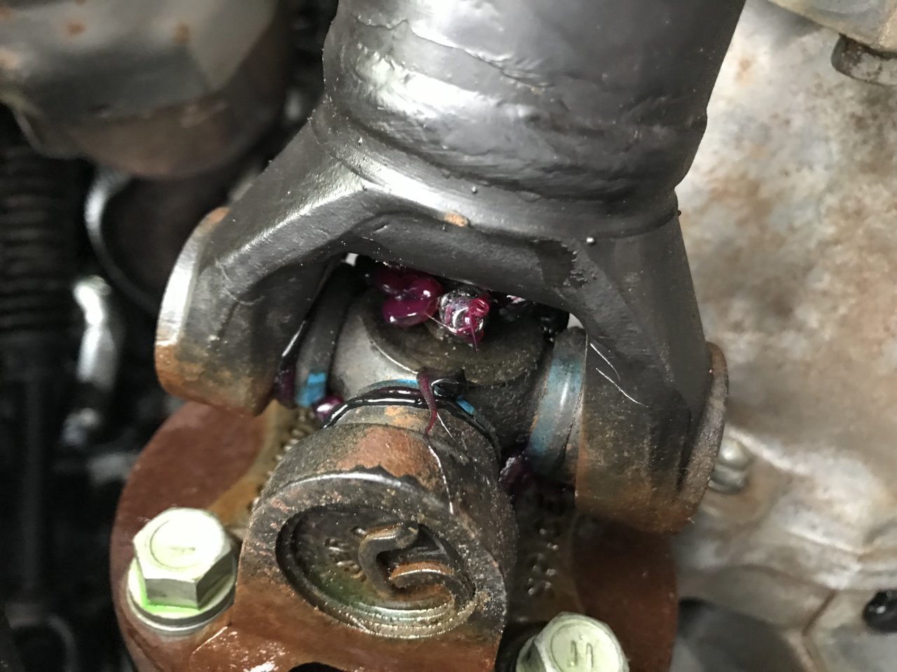

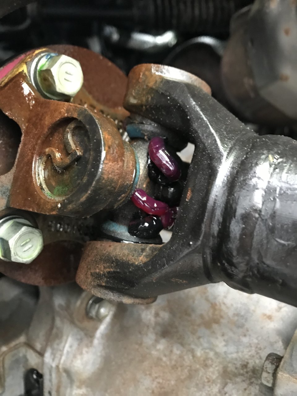

    i have never greased my 2017 OR DCSB before until it reaches 30k now. Learned from this forum and bought grease gun and grease. There are only 2 zerks so it’s pretty straightforward, although the grease gun’s nozzle was difficult to remove after greasing due to the narrow space in the U-joint. I pumped probably 7-10 times until I pushed out the old black grease. Unlike someone mentioned before that they were bone dry, there seemed too have plenty of old dirty grease. Although there’s an opinion that we should stop right after seeing the old grease coming out, I prefer to replace all the old grease. It’s not the slip yoke anyway so it won’t bring too much pressure. I plan to grease it at every oil change so it won’t dry out. F24AE70A-A2D2-4941-98E6-087FFDA77171.jpg FC6FAD1C-037C-4167-B578-8F5AA10FF29E.jpg 0ECA0FE8-6075-49DC-A667-0B5E9CC2D89E.jpg 976B5908-0581-46EB-91CF-F5C83647FCB5.jpg

    One thing to note, is that black grease you purge from the U-Joint is black to begin with. It’s some supper tacky and extremely slippery stuff they place in there at the factory.
    I’m a bit of a grease guru due to my profession, which requires 12 different greases to do my job properly, and I have never found anything quite like that stock black u-joint grease. So tacky, yet so slippery! If I could get my hands on a tube of it, that’s what I would pump in there.

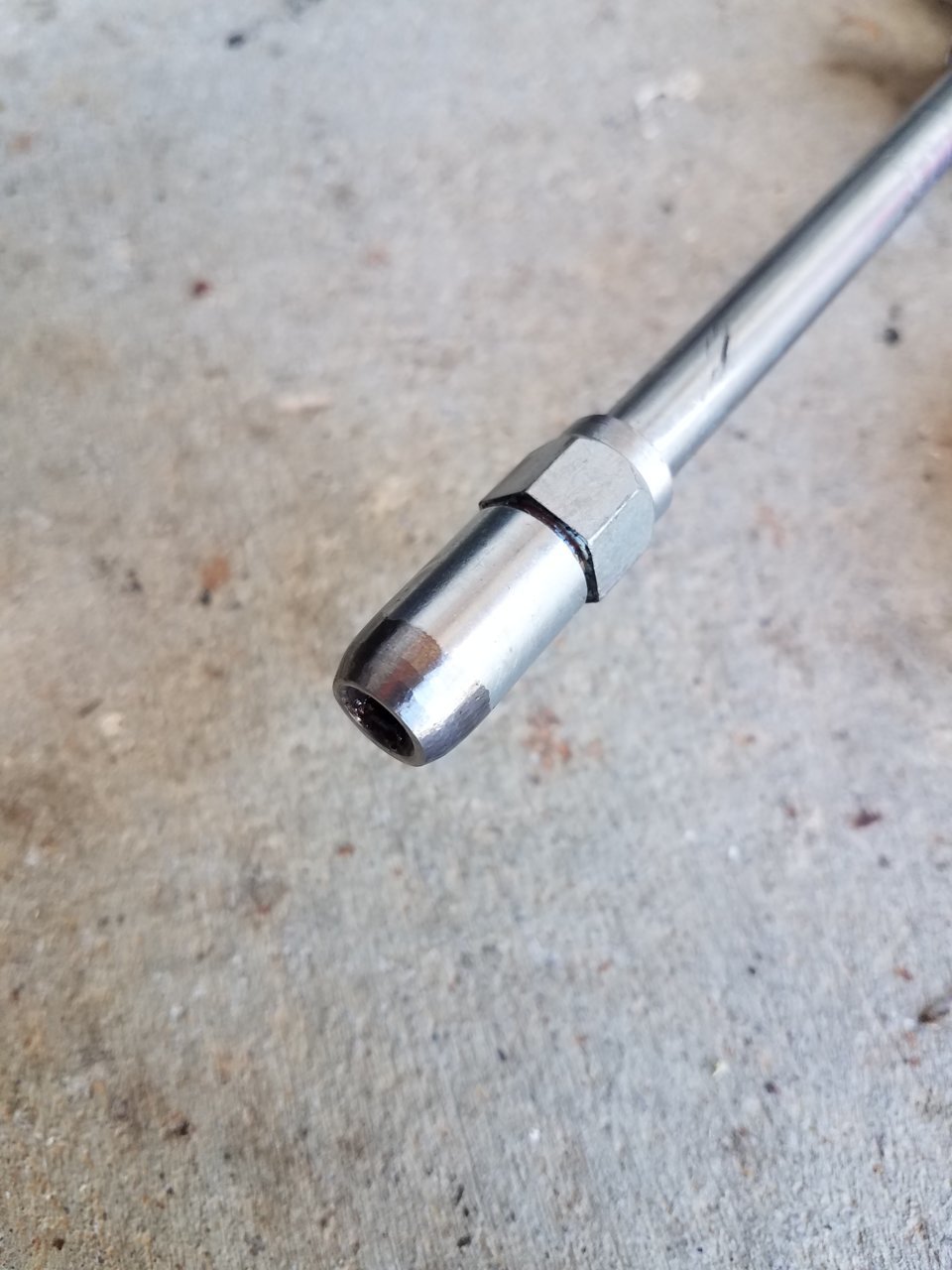

    I grinded the tip down a little, makes a big difference getting to those 2 front zerks
