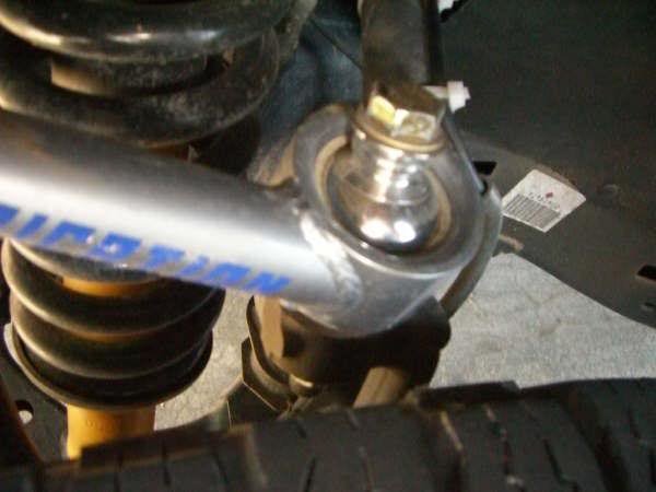

    Thanks again Chris! Just put the first "coat" on... :eek:

    Whew! Good. Let me know how its workin out for ya. :)

    This may be a very simpleton question, but how will I know "how it's workin out for me"?
    Also, I noticed this before I sprayed the PB Blaster yesterday but there appears to be some surface rust on the top of the uniball. Do I need to worry about this?

    Well, just let me know if they start to squeek, or get a "loose" feeling.
    The Uni's should have a nice "mirror" look to them where they cycle. Rust any place on top, shouldnt be an issue.

    So, dry teflon lube is what I need if my UCA 'creaks' upon backing up and going uphill? I'm sure it's the UCA and just want to make sure I put something on it that will make the noise stop and won't hurt things.
    Also, with the Light Racing UCA's, how do you grease the bushings? Is an uninstall and new alignment required? Any photos would be appreciated. :cool:

    Yes. Use a Teflon spray lube on the uniballs. If you dont have grease zerks, your gonna have to take them off to grease them. No need for an alignment though.

    So I researched zerk fittings and now know what they are. I also saw this and see that the noise probably isn't the bushings (based on what the add says). My guess is that it is the ball joint so I'll follow your advice Chris and report back in a week or so when I get back from vacation. THANKS for the advice!
