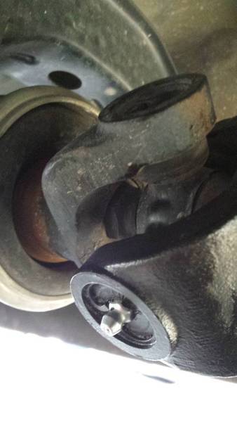

    I was on the 30k service and it I can only find 3 zerk fittings. I pumped and pump and nothing would come out of my u-joint. And I know that the grease is entering the zerk because I could push on the center of the zerk and grease would come out
    Am i filling the right zerk? i didn't see any other zerks on the u-joint
