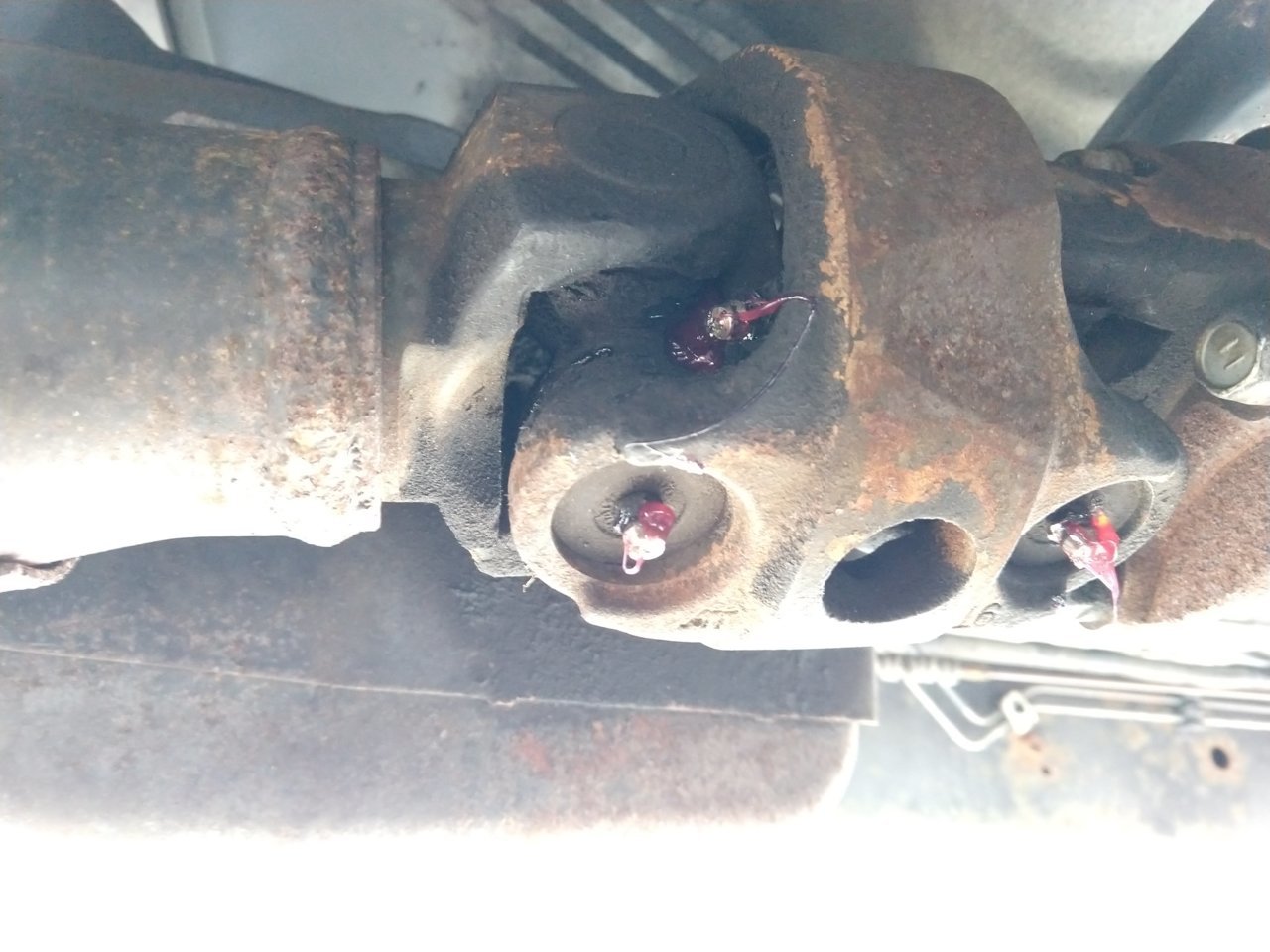

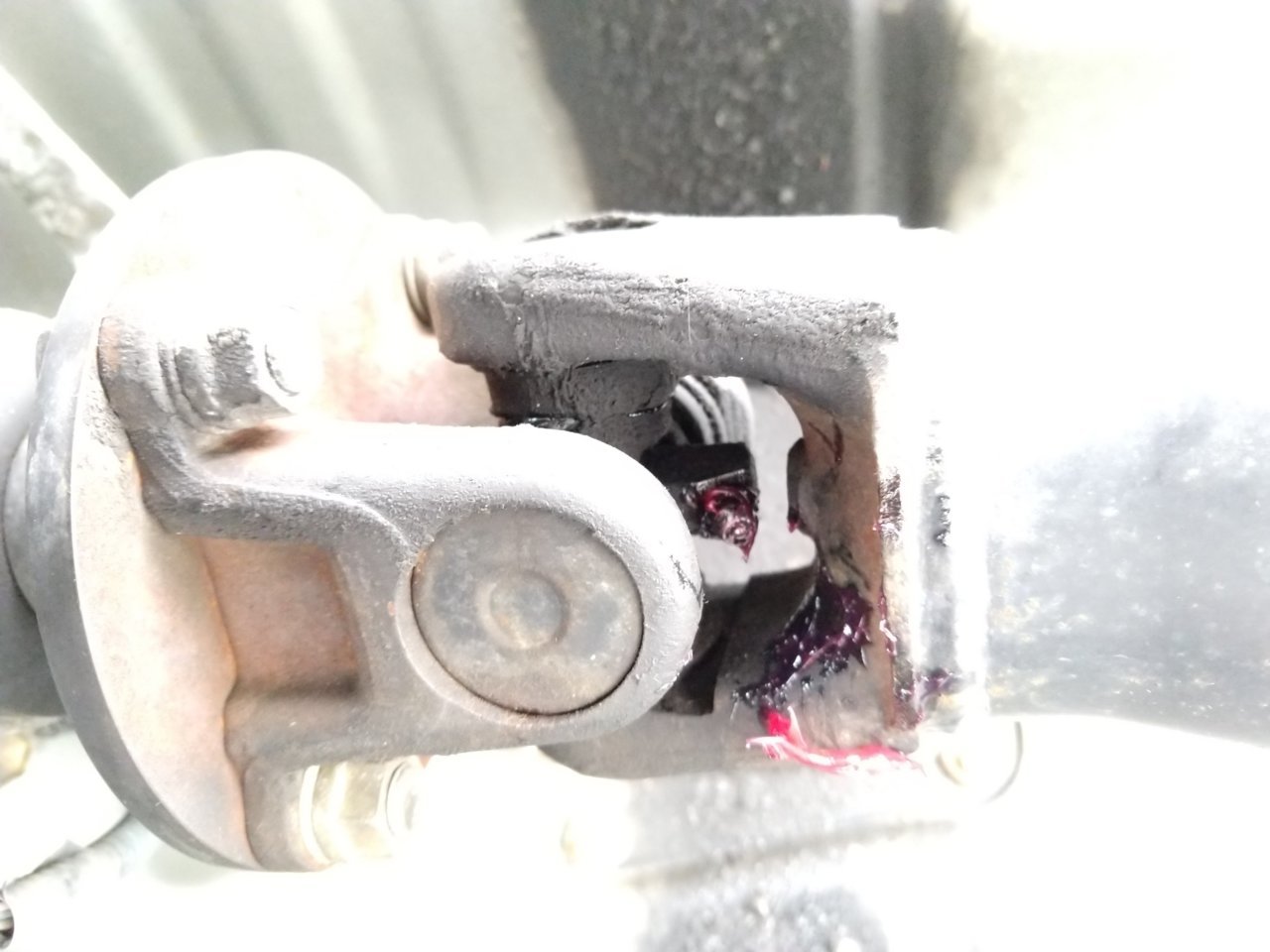

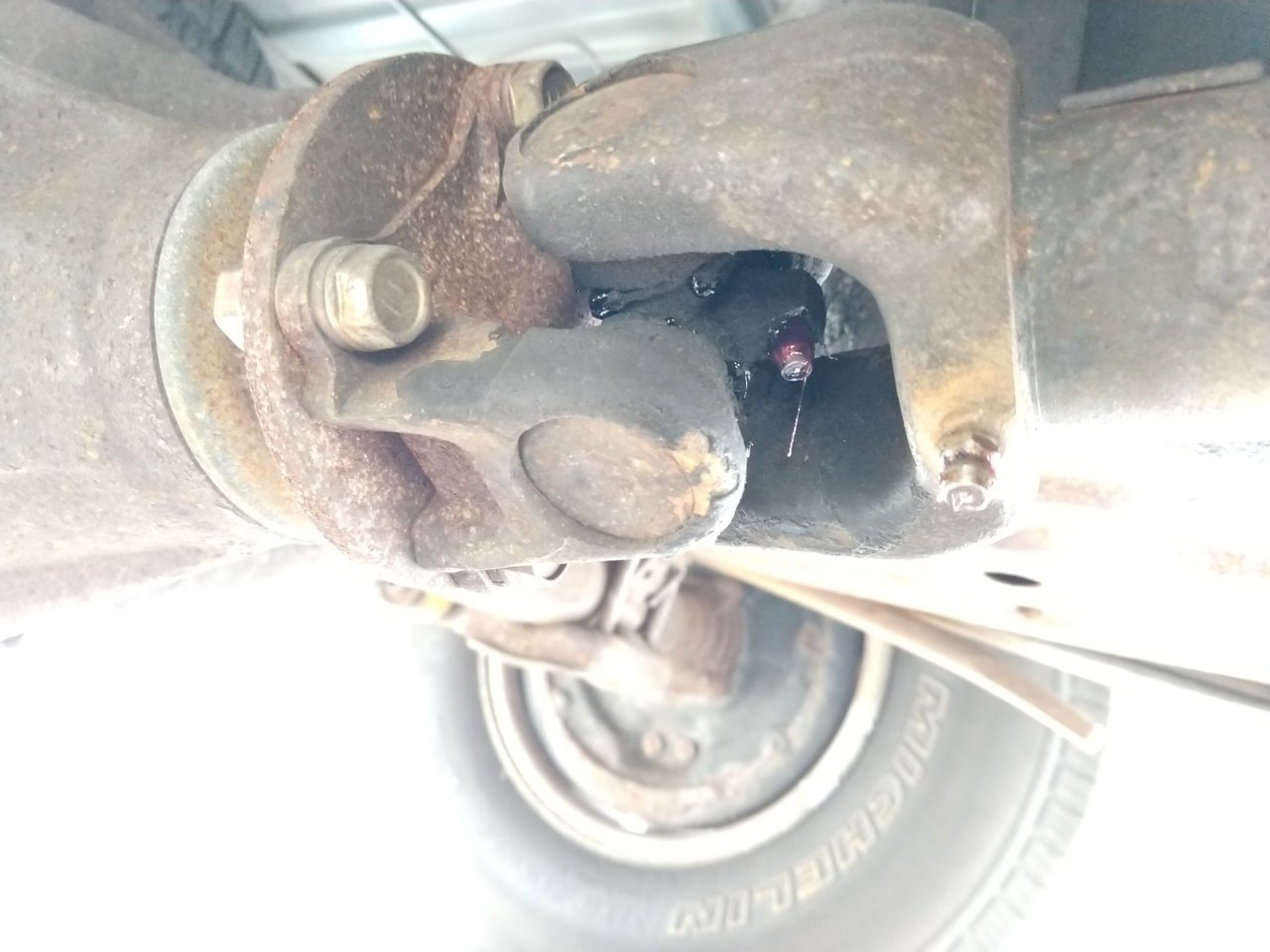

    Thanks for the great write-up and informative thread! I had trouble finding information on what I should look for specifically on first gen PreRunners (though reasonably assumed it would be similar/identical to 4x4s). So, in case anyone else is looking for that info, on my 1998 PreRunner XtraCab, there were six zerks. From front to back:
    • One zerk on the driveshaft coming from the transmission
    • Three zerks on the cardinal joint in the middle
    • Two zerks at the end of the shaft leading to the differential
    Photos below - apologies in advance that I took these before I cleaned the excess grease off.
