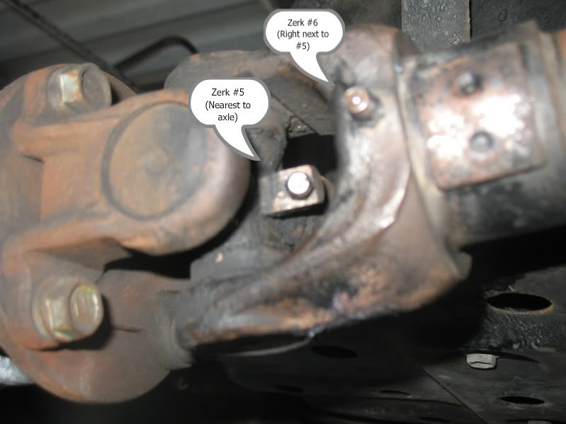

    I saw this thread posted on TTORA and thought it'd be a good time to check up on the drive shaft u-joints. On a nice Sunday morning...with the football games on, cold beers, wrenching with your better half = priceless. I also received an early xmas gifts with new suspension (leafs, shocks, and coils...buh bye King) setup to install so today is a good day. :D
    *Write up on that will be posted later when I'm not lazy.
    I tried to take clear pics of where the zerks are so hopefully it'll make it easier for you to find/identify.
    You'll need:
    1.) grease gun
    2.) your favorite grease
    3.) rags
    4.) brake cleaner
    5.) flashlight (maybe)
    Grease gun:
    Front of drive shaft (near tranny)
    Mid joints...there are 3 zerks, the third one is a bit hidden.
    And last two (near the axle)
    Once again, be sure to clean the zerks before apply the grease. You should be able to see the old grease coming out in dark color. It should be the same for all 95-04 Tacoma Xtra-Cab & DC but don't quote me on it. Take this write-up with a grain of salt, trash it or use it for all I care. :p

    Nice writeup....but I think you forgot one of them.
    It's in the last picture..... and to the right on the 'ear' near the base of the shaft - that's probably for the slip yoke. Always wondered where that one was. Never went and looked for it on my own truck. :rolleyes:

    Can someone update the first post to reflect the zerk #6 bubble?
    If you do a quote & preview, there's another bubble showing Zerk #6, but for some reason - it's not updating on the page.
    This is weird....cuz one minute I can see it, and the next time I look at it, I can't. Or is it just me?
  20. Nov 30, 2009 at 7:53 AM
    #20
    The Parts Whore
    The Parts Whore [OP] Slinging parts since '03
    Oct 2, 2008
    #9649
    209
    I did update it and it shows #6 for me. :notsure:
    Maybe try Ctrl + F5 to force a refresh.
