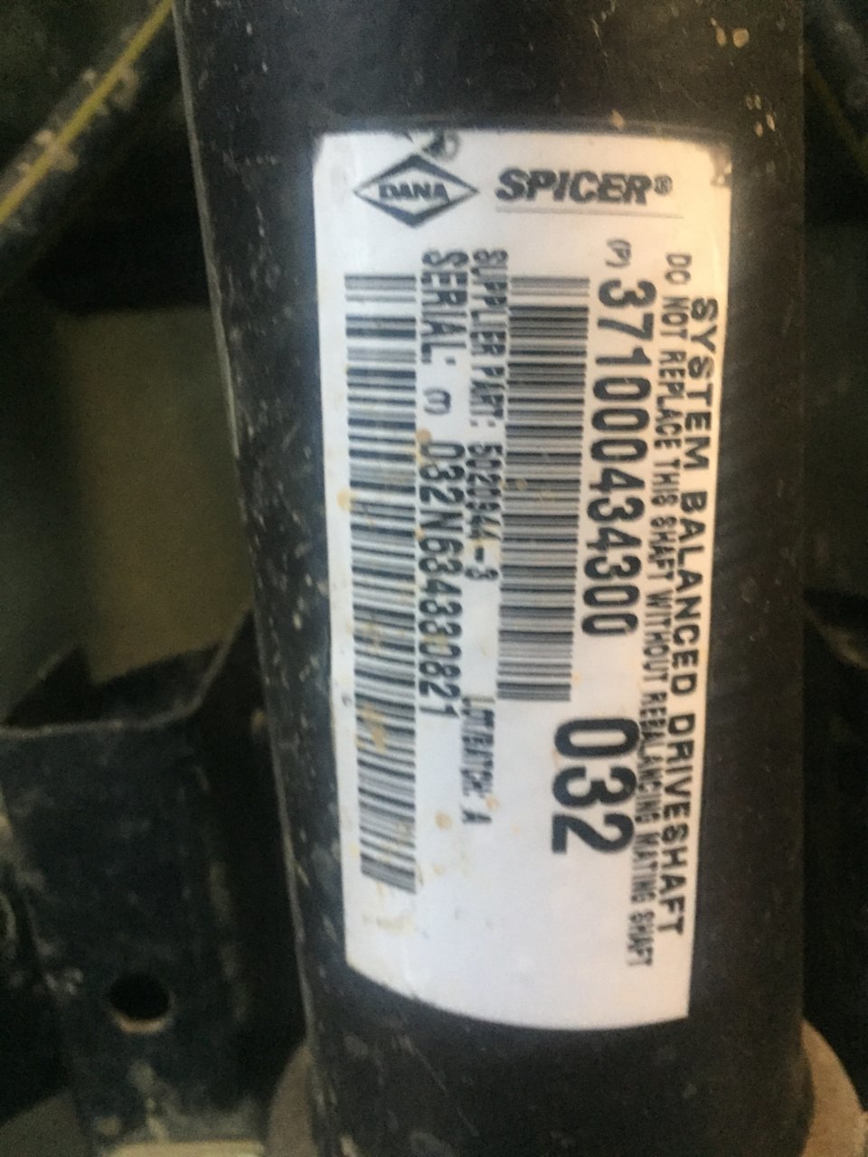

    Replacement drive shaft has NO ZERKS. Anyone come across this?
    Let me start by saying, I know what a Zerk is. I found the ones on the front drive shaft. I have turned the rear (replaced by warranty) drive shaft to search. But no ZERKS. WTF..
    I have searched. It seeemed a guy with a 2017 Tundra had no ZERKS from new.. Seems weird.
    How am I meant to lube her up?
    Attached is a pic of the replaced drive shaft sticker..
    Any advice is welcome, Do I just go back to the dealer and say “WTF” ? Politely of course

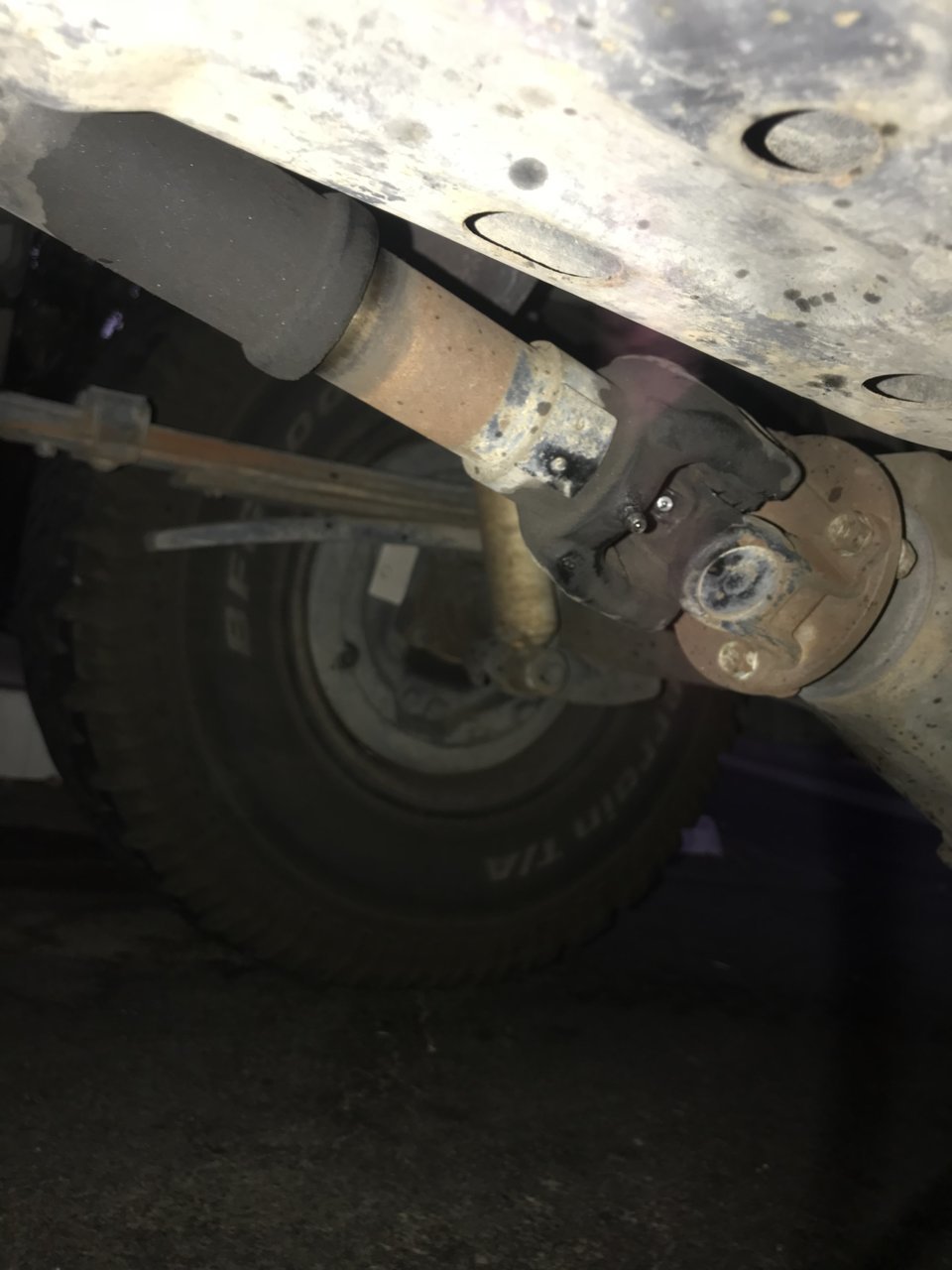

    I know this is a really old tread and my question is probably answered somewhere lost in this tread. So my question is, i pumped like 20 times already on the zerk by the shaft that’s near the rear differential, that slides back and forth. (See picture) Somehow i still don’t see or hear that it’s getting full. For the other zerks, like the front, middle,i pump 3-5 times and i start hearing a tiny air pop and i see leaks of grease indicating it’s full. However on this one, ive pump 20+ times and it’s still not full ‍♂️? Is there an exit for the grease to come out somewhere? I mean, is that normal? Where does all those grease even went? Someone please clarify this to me. Thanks in advance.

    If that's the zerk I'm thinking of, for that zerk, the thread earlier mentioned that you pump until you see the shaft start to move (I believe it was called a yoke if you want a search term). I think if you're overpumping, it'll probably just squeeze out while you drive as the shaft goes in and out. Sorry I can't be more specific with terms and stuff, last looked at this a while ago and don't recall the specifics.

    Well i pumped about 20 times and call it good. Everything is good so far

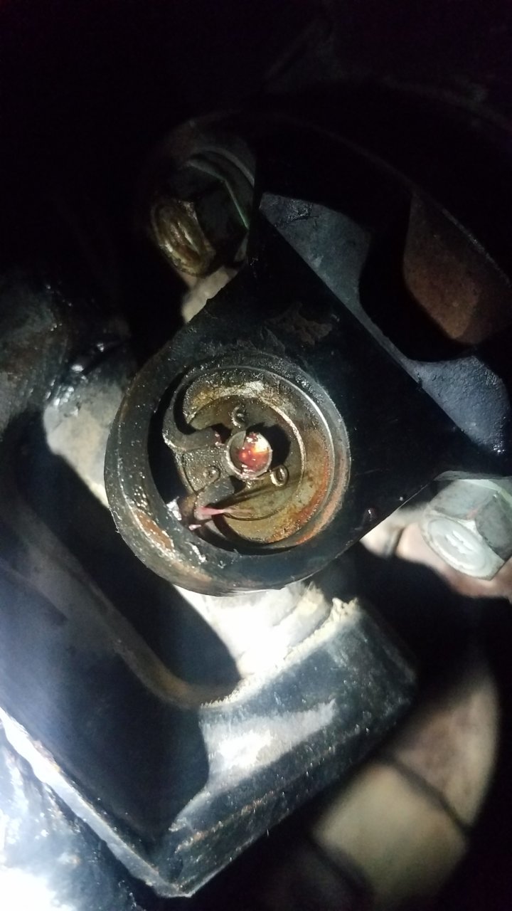

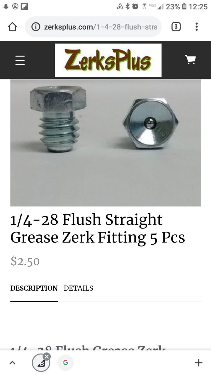

    Does anybody have the flush grease fittings on their Tacoma? I have a 2010 AC 4x4 TRD and there were regular zerks for the first 2 parts of the drive shaft up front, but for the center shaft I only found 2 grease fittings that looked like the picture attachedScreenshot_20190725-122501_Chrome.jpg

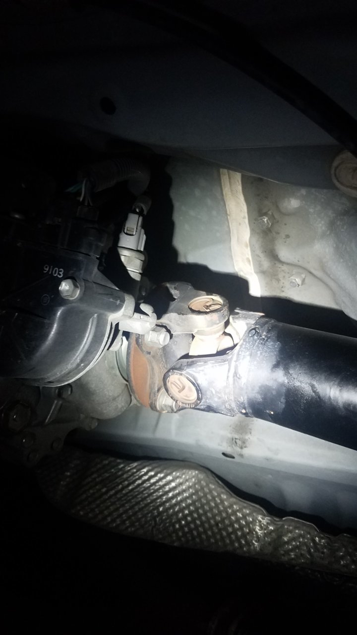

    This is what one of my u joints looks like. Second picture is a u joint with no zerks/fittings. Does this mean it was replaced at sole point? 20190727_205511.jpg 20190727_205700.jpg
