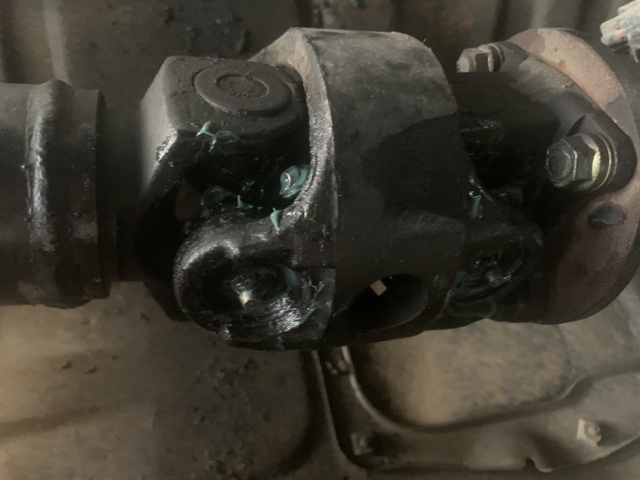

    I’ve got a 2000 PreRunner 4x2 I found 5 zerks and I pumped more than 3 pumps on the yoke what’s going to happen? If there is too much grease in the yoke? HELP 026F8931-3A73-42CE-9A23-0C6A1AD60532.jpg
    Black97v6MT likes this.
