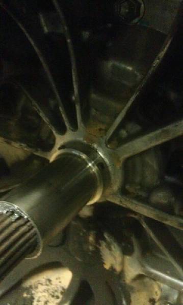

    I did this DIY over the past winter and went with the URD sleeve and replaced the clutch and pressure plate with the URD Stage II clutch kit while I was in there. Took me about 7hrs total with my Dad helping, he's 79 so it was more moral support but great help nonetheless:).
    I also adjusted the clutch afterwards per the link gearcruncher noted above.
    Works like a charm now! No squeaking, chirping etc and clutch is nice and smooth. The nose on the trans was definitely pretty scarred up and the TO bearing felt like it was on its way out as well.... Truck had 100k on itat the time of replacement. I now have 130k and no issues and buttery smooth clutch pedal as well.
