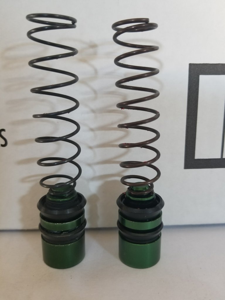

    Alright so I've spent the last hour reading more into various fixes and I figure I should try your method (for the cost what could go wrong? :D). I want to do this ASAP to try and prevent further damage... My question is this--- is this clutch rebuild kit what you would recommend I use? See here:
    Toyota Part No.: 04313-34011
    Or should I look specifically for a mid 90's f150 spring like you mentioned in your original thread? Thanks for your response!

    I don't know if the Toyota part will work because I didn't use it. To work, whatever you do will need to apply 3 to 4 lbs of force on the TOB arm. So you'll have to push the slave cylinder with that kind of force to get the SC mounting bolts in. I used the F150 spring because I had it and the collar worked well to hold the spring in place. Good luck.

    Thanks for the info. I'm gonna try the Toyota kit this time. Gonna compare the new spring vs the old and see how it feels. Getting to the slave is super easy on these trucks so if the Toyota kit spring doesn't seem any different I will look for an f150 spring.

    Getting a new SC is fine but it's got to have the right spring. I got a Beck/Arnley and the spring was even worse than the old OEM one. Once again, it's got to load the arm with 3 or 4 lbs. In other words you have to push hard to align it for the mounting bolts.

    Some food for thought... the new slave cylinder listed in the TSB has a longer pushrod and heavier spring.

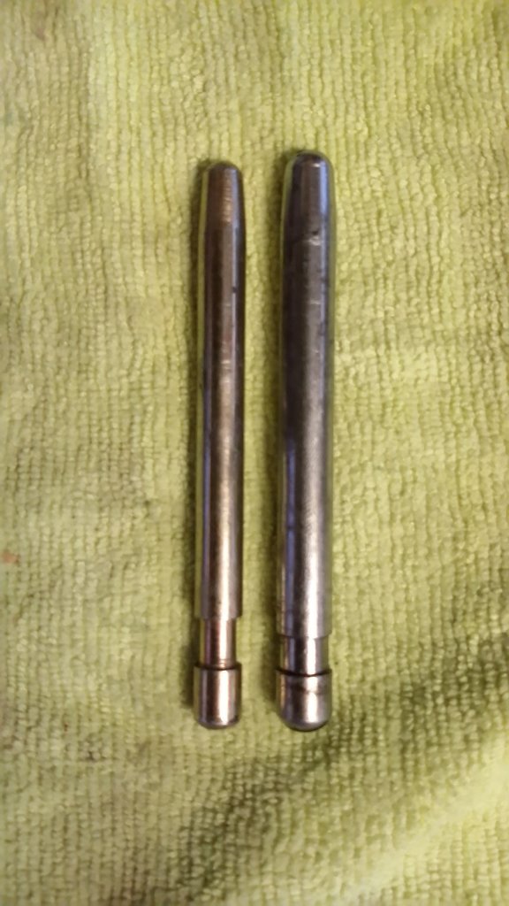

    Is this the cylinder kit you have pictured?
    Toyota Part No.: 04313-34010
    and the rod?
    Toyota Part No.: 31473-60160
    or did you buy the whole assembly?

    Just an update on this. I installed the post sb slave rebuild kit and it does indeed have a beefier rod (giggidy), the spring was the exact same as the one on my truck (it took a lot of force to get the slave in place pushing against the fork) however since mine is a 13 maybe they come like that (beefier spring). Well I already had the thing apart so I figured I might as well rebuild it. After installing and bleeding the system, the chirping noise vanished AT IDLE... after actuating the clutch a couple times and hasn't came back... at idle (lol). However now the same chirping noise can be heard while driving between 1700-2900 rpms. Its less obvious with the sound of the engine and tires and AC and music so I can live with it for now. I think I might be looking into the URD sleeve for my next chance to throw money at it xD (when I do my clutch) I am super OCD about noises on my vehicles and this chirp drives me slightly up the wall but I can sort of live with it for now. o_O

    If it took a lot of force to get the slave in means it is preloading the TOB which is what you want. (I had emailed Toyota about that time but I don't know when they changed the part.) Your higher rpm issue may be the result of the existing damage to the TOB and transmission spindle since this modification can't resurrect parts from the dead. I'd give it some time and see if it "settles down". A warning for everyone else, if you have this problem fix it sooner for a few dollars rather than leave it till later and then spend a lot.
