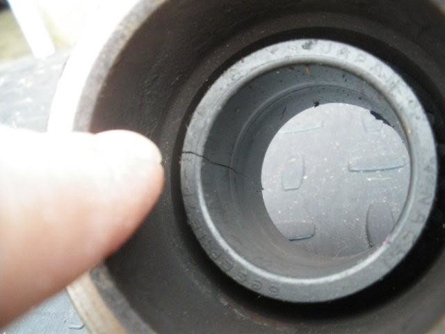

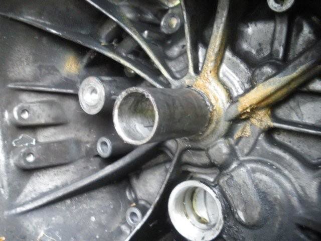

    EXCELLENT write up SnoBoarder. Thank you for taking the time and posting these pictures. I'm currently dealing with this same chirping noise myself that goes away when I engage my clutch. Even the slightest pressure of the clutch pedal makes the chirping go away. I have a 2008 Tacoma V6 4.0l 6speed manual with 41,000miles on it. It's still under warranty(60month 60,000mile powertrain warranty) but, I have an after market 2.5" lift that I installed myself. I just dropped the truck off this afternoon and the sales manager says if Toyota rules the "Throw out/Release Bearing" as a wearable part, then I will be paying for the repairs out of my own pocket. I'm a little anxious to see what they tell me tomorrow.
    If you have any other advice, I'm all ears man. Thank you again for the post.
