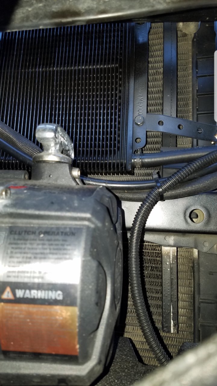

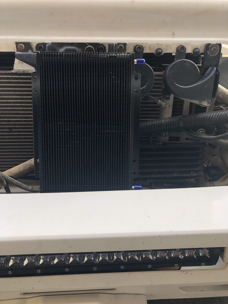

    @HolyHandGrenade can you show me how you mounted your trans cooler? I lost the link of your writeup

    Some Stuff

    Yes the connections. Does it matter if they face up or to the right?

    In that case, I read that as orientation isn’t important. It sounds to me, they’re just saying to aim them towards the OEM lines to make connecting the two easier.

    Screenshot_20180913-194636_Gallery.jpg only pic I could find of mine. Did you remove the SC cooler already? I used that strapping that came with it to make supports to the closest factory bracket.

    49,824
    David
    Ashburn, VA
    2010 TRD OR Access Cab
    Thank you very much!
    Supercharger comes off October 6th. I'll put the trans cooler on then too.
