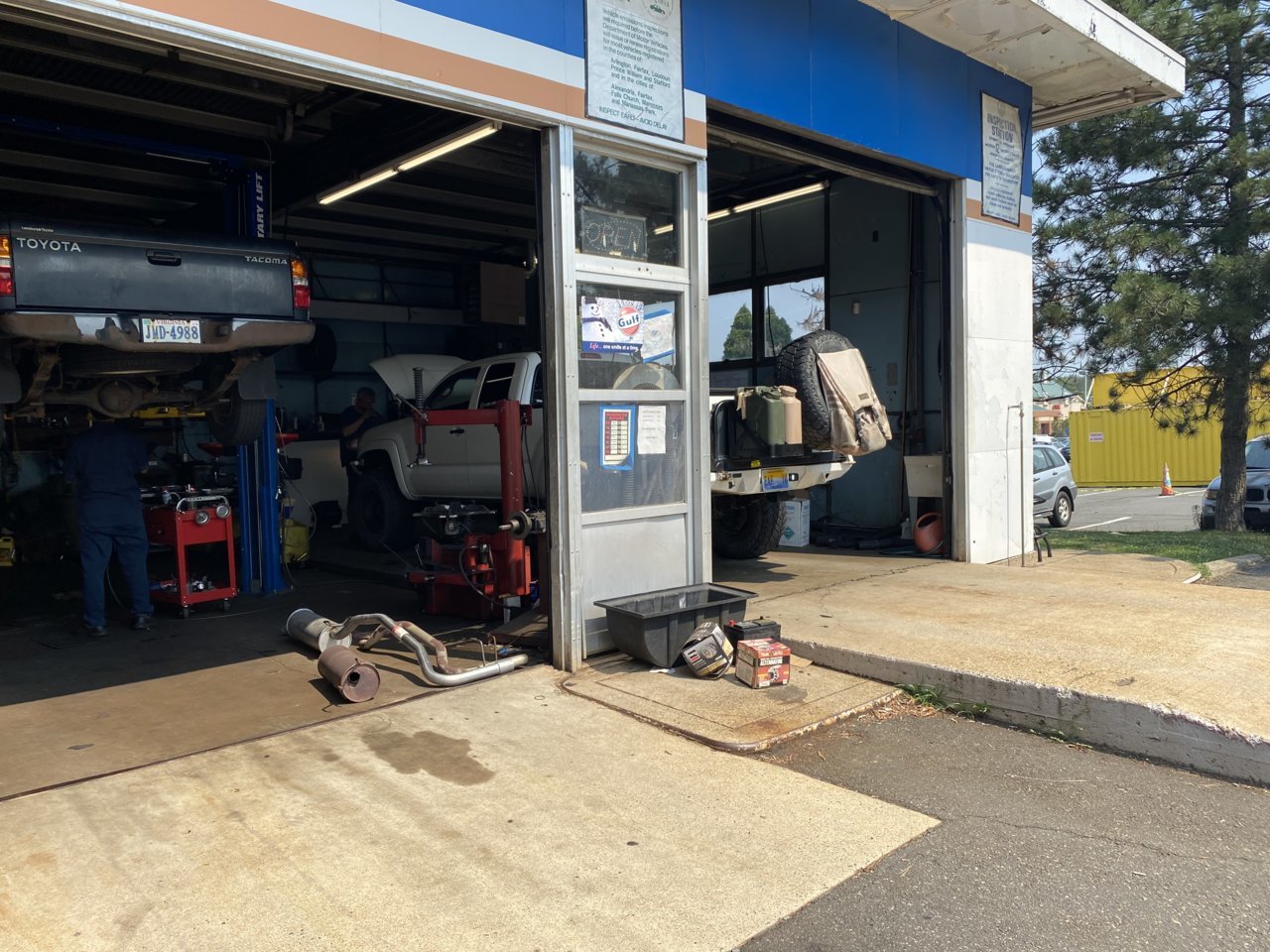

    Fingers crossed...I always dread inspection day, in PA they scrutinize your vehicle.
    What's up with the 1st gen next door?

    Looks like it's getting an exhaust put on. Im not sure though.

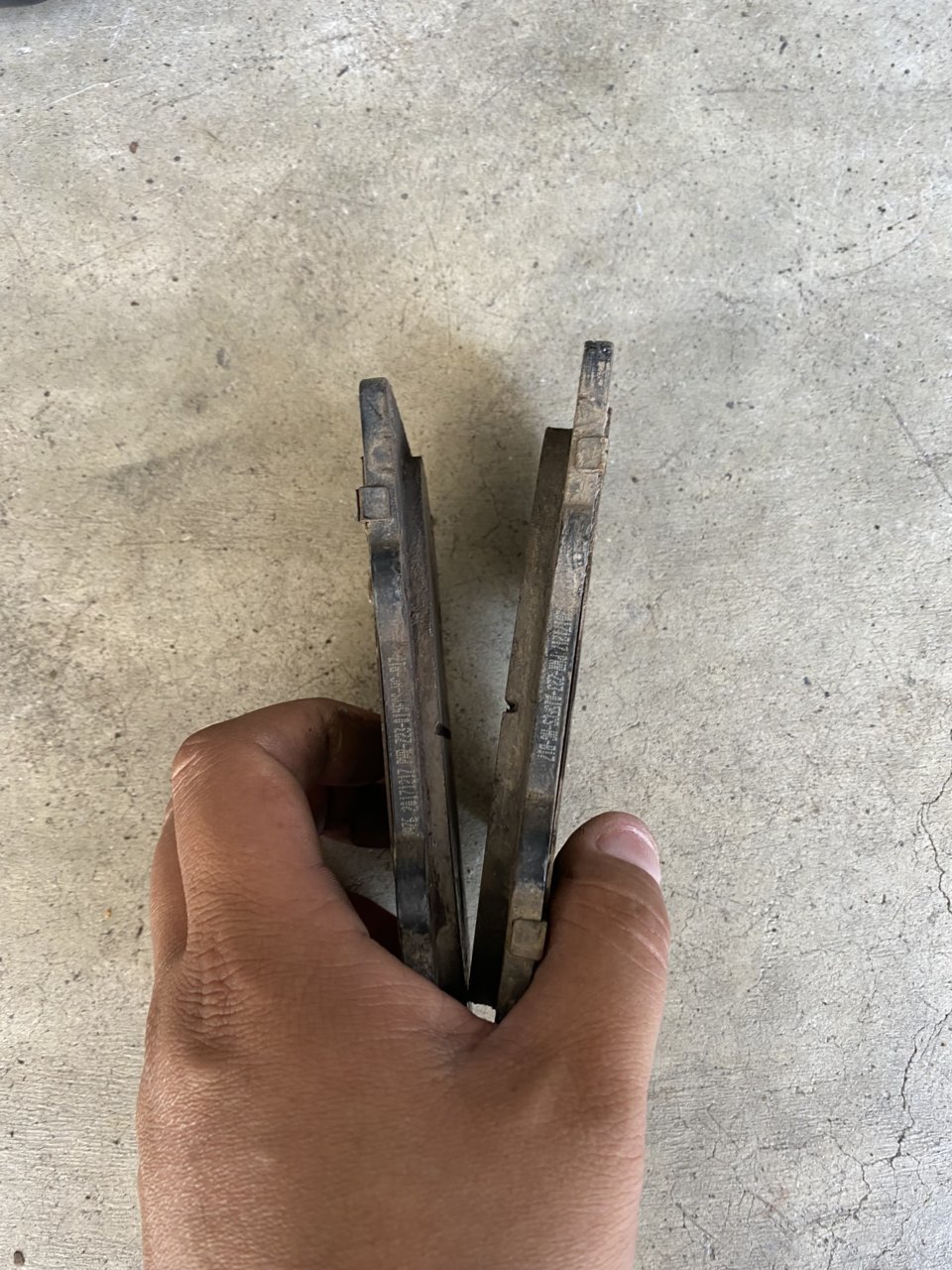

    But they didnt ship for 2+ weeks. So I canceled and ordered some Hawk LTS pads on prime.
    I think this is where my metal-metal grinding sound was coming from.
    Anyone know why the passenger side pad would be that low?
  17. Jul 14, 2021 at 7:16 AM
    Gunshot-6A
    Gunshot-6A Prime Beef
    Dec 29, 2009
    #28389
    23,595
    Conner
    Everett, WA
    '15 TRDOR / '17 Africa Twin
    Either a bad pad that wore down faster, or my more likely guess: stuck piston/dragging pad, that then wore it out faster. Notice a small drop in MPG over the last few months?

    Slight drop- but i dont drive that often. Only got 20k from these pads. Pushing that lower piston was a fight/slight pain. But its in now. Think I should replace the caliper?
    This is driver side:
  20. Jul 14, 2021 at 7:39 AM
    Gunshot-6A
    Dec 29, 2009
    #28389
    23,595
    Conner
    Everett, WA
    Shouldnt be a battle really, a little effort at most.
