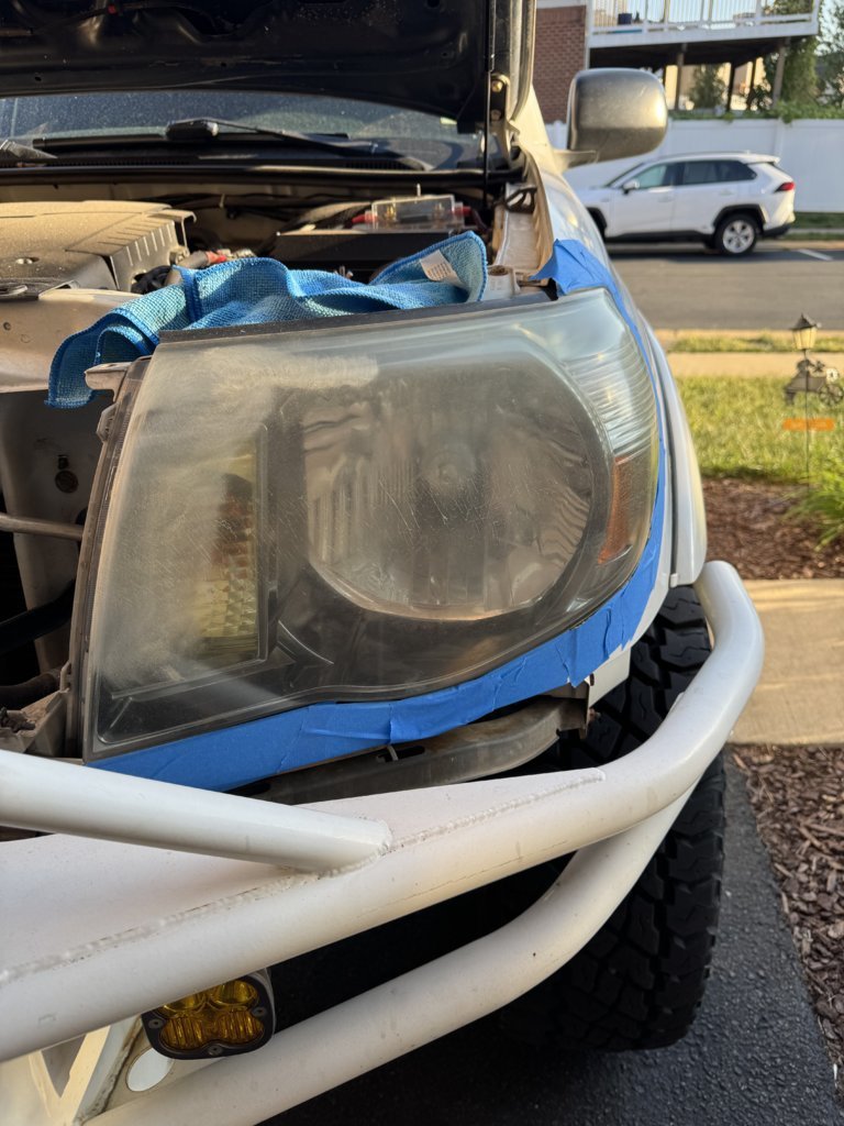

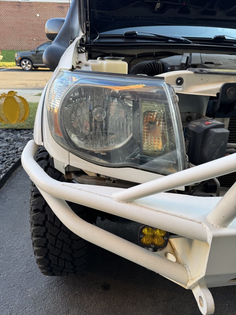

    Lost some motivation to do the ADD delete today. But decided to sand and clear my headlights. Turned out awesome!

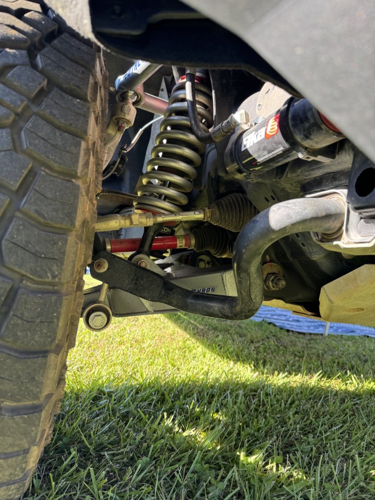

    Great weekend at the Rooftop Tent Rally in Gladstone VA. Saw some cool rigs. Got some bad (good/expensive) ideas. Hung out with some friends that I havent seen in a while.
    this new Tundra has TC LCA, but i cant tell if its LT. Either way, he only has a single shock, so Im still cooler :anonymous::
    All my friends have Alucabs now. Last one is a 2024 Tundra TRD Pro in Terra that i wish i took a better picture of. That guy just threw the $ at his truck

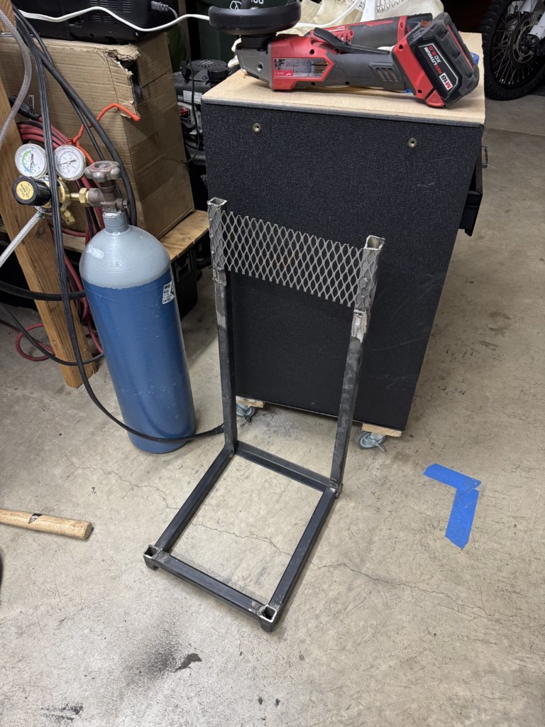

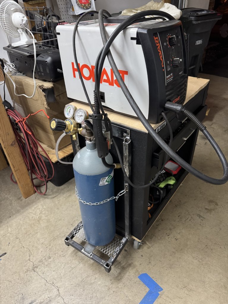

    In the forever quest for more space in my 20x10 garage, im chopping up my old welder cart, in order to attach it to this crappy old toolbox that Ive added wheels to. All my materials are owned, so Im $0 into the project. Winning!
    The welder will sit on top, and the gas bottle will hang off of the side on the L thing Im chopping.

    Raw, but it works. Ill take it

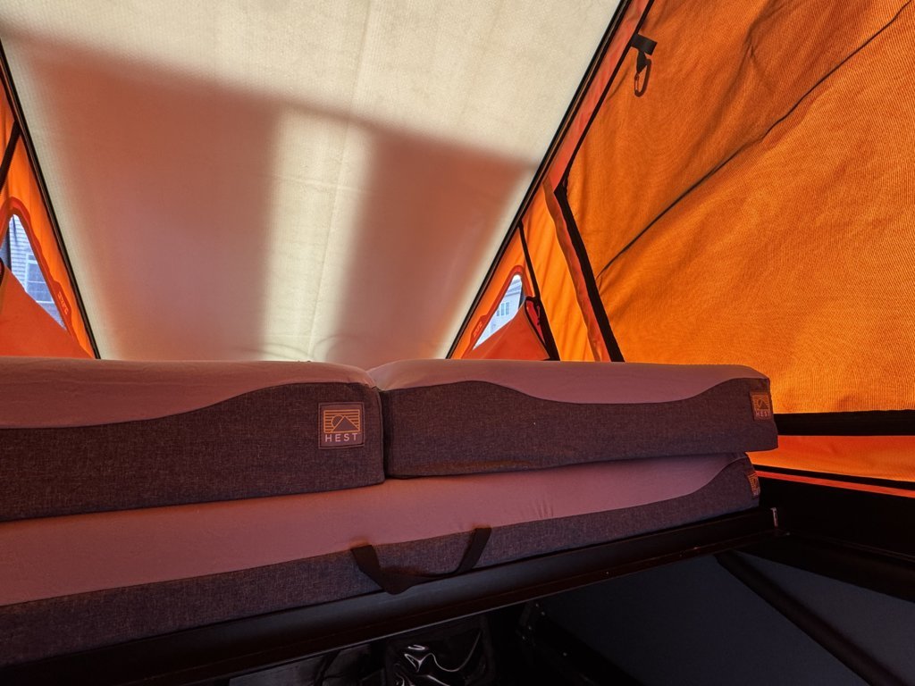

    Upgraded the GFC mattress again. This time using the Hest Dually Platform 50 that's meant for the GFC panels. 3" memory foam is so much more comfortable than my furniture foam replacement. Plus the cost to upgrade will make me camp more (supposedly)

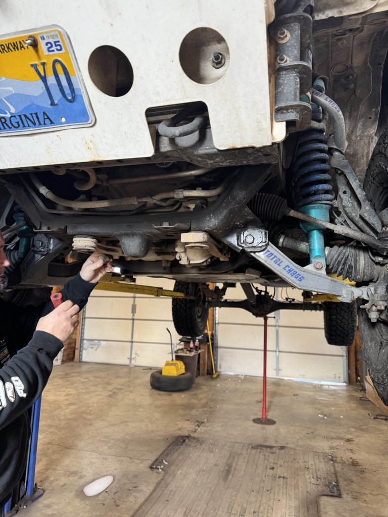

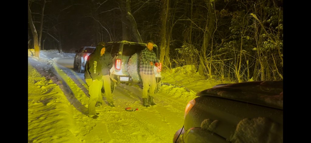

    Found out this laziness has lost me 4wd.
    Went out to play in the snow, and got stuck on an icy hill. Locker didnt help, just spinning. Learned that an open diff doesnt actually provide any "power" or traction to the one wheel that is spinning. Thanks to @ShimStack for the explanation.
    Also had to use my winch for the 2nd time in 8 years. Glad it was there

    Fixed my 4wd by jumping the pins on the front diff actuator, which made the fork move over.
    In the spring ill actually change to the FJ tube, and remove the actuator and wiring.
