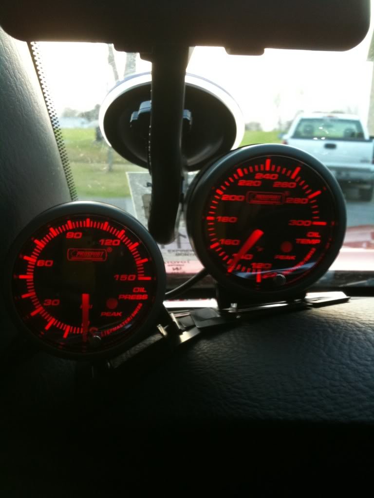

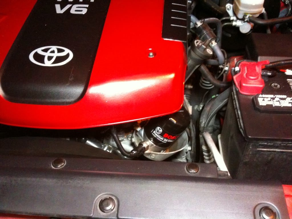

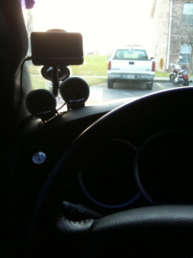

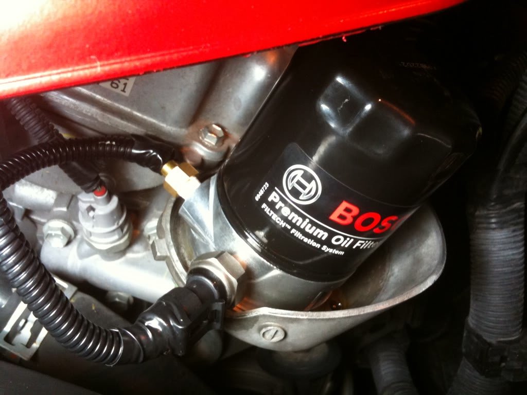

    This is for anyone that wants to run this setup. I have the greddy plate like the one in the above link.
    This is a temporary setup until my dual a pillar pod comes in. I called today and it is suppose to get painted tomorrow then shipped out. I have a prosport premium oil temp and premium pressure gauge with a greddy oil sandwich plate. I have the wiring connected through "add a circuit" connectors through the dash fuse box. Here are a few pix plus a vid if the opening and closing ceremony. And these were taken with my phone.

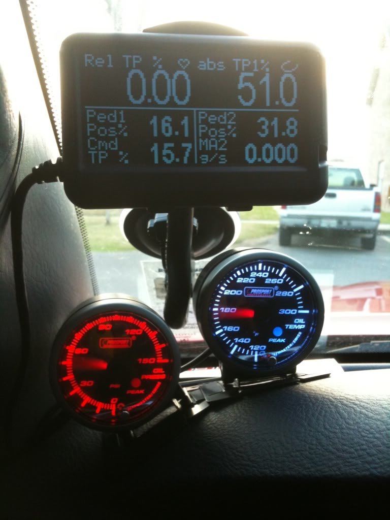

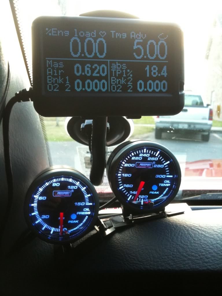

    So far I like them alot. They are white/amber gauges but turn red when the warning signals go off so I wanna see if there is a way I can wire them up to be red at night to match my odo LEDs instead of amber. I just installed them a few hours ago.
