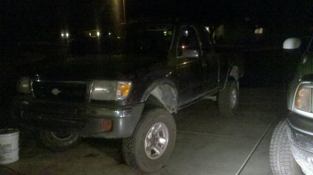

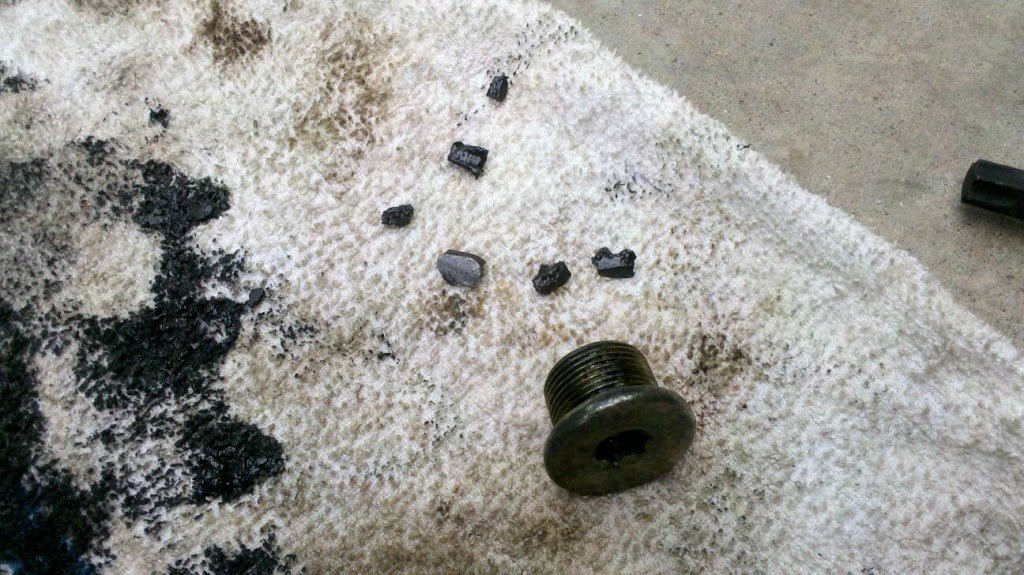

    Little update, this happened.
    backing out of a slot at frys food. Had to call for help, jacked her up, put in 4 bolts and drove her home. It busted the cv boots, and break lines.
    Had to retorque the damn bolts, but this time with loctite. That side was easy.
    The otherside was also lose, busted a head off of number three bolt. After a failed extraction i drilled it larger and put in a 16mm grade 8+ bolt. Then changed break lines, put in stainless woven lines. All in all helluva a oops.

    yeah. i suppose the hsock wont be to hard to change over, thank god not the leafs hahahah.
    I need a spacer though for the driver side. i definetly get some taco lean going on. And NOT just when my spindle pops off :D
  13. Sep 13, 2011 at 10:00 PM

    holy shit! yeah something is F'ed lol. that is some serious taco lean hahahaha. i dont know much about suspension. i just orderd some 5100's. going to be installing this saturday. not sure what to tell you about the shocks man. im sure someone else on here can help you with it lol. reguardless. good looking truck man. just need some bigger meats and it will look even better haha

    the lean in that picture is because of the spindle falling :D

    oh ok haha i was gonna say DAMN dude. haha

    how the hell did that happen??

    the 4 bolts holding the lower ball joint to the spindle failed.

    i hope that doesnt happen to me :eek:. where you driving when it happened??

    2 mph in frys parking lot. dont use cheap hardware, no loctite, and confirm everythings torqued.
