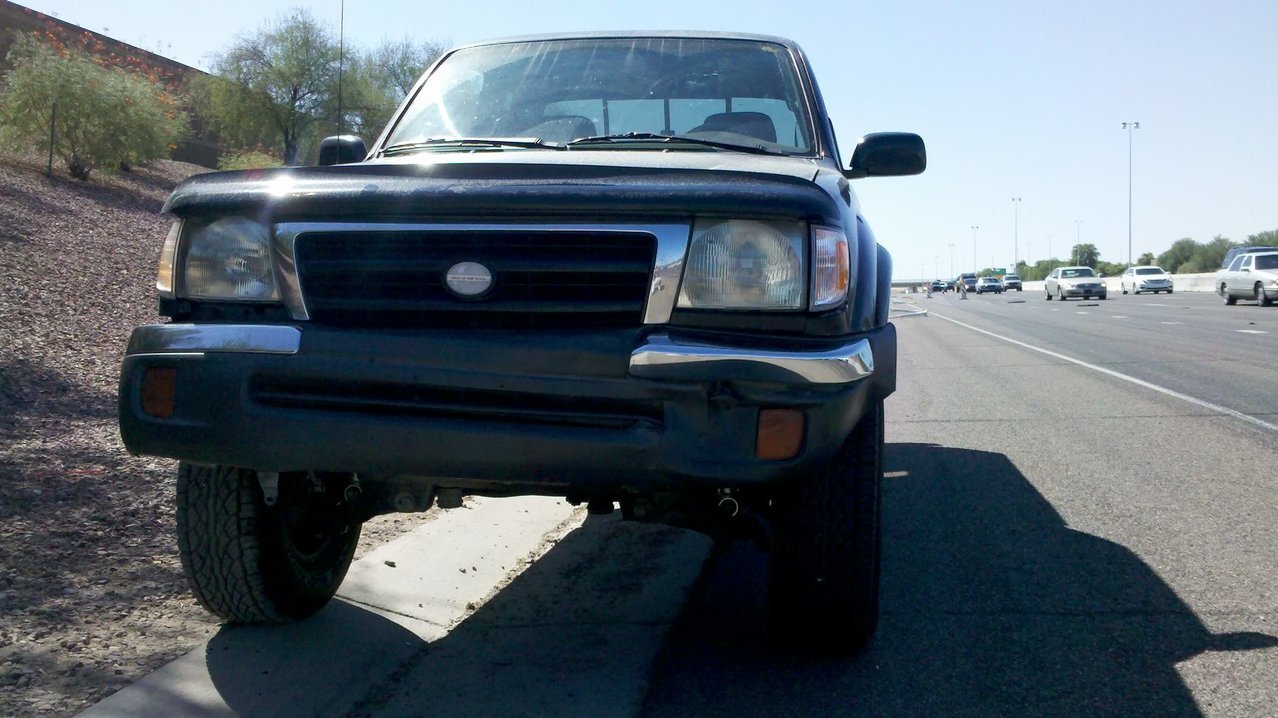

    no Loctite? why not? btw. head lights look way better. you cleaned the inside?

    Wasnt aware i needed any. i used red, the strongest.
    Yup, took em out, threw some water and shook em around.
    Poured it all out, shoved a papertowell inside and used the airhose to blow water all around, changed out papertowels, that got all the water out in a few minutes, now their awesome :D
