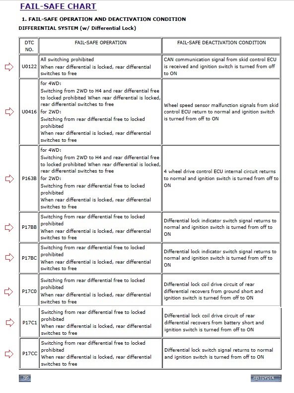

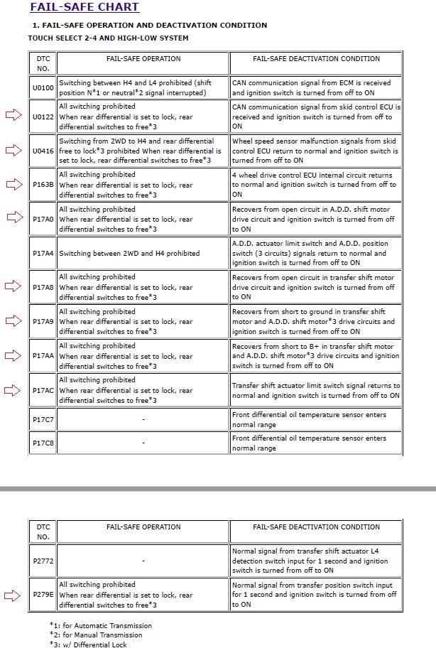

    Here are the fail-safes that need to be overcome.
    There's a reason the Bud's Custom 2wd locker anytime kit has a CAN-bus unit.

    The wheel sensor picks up a signal off of a toothed ring on the front wheel hub (inside). It must 'see' the teeth passing by at a rate that agrees with the road speed or it senses trouble, ie skidding, pending wheel lockup, etc.
