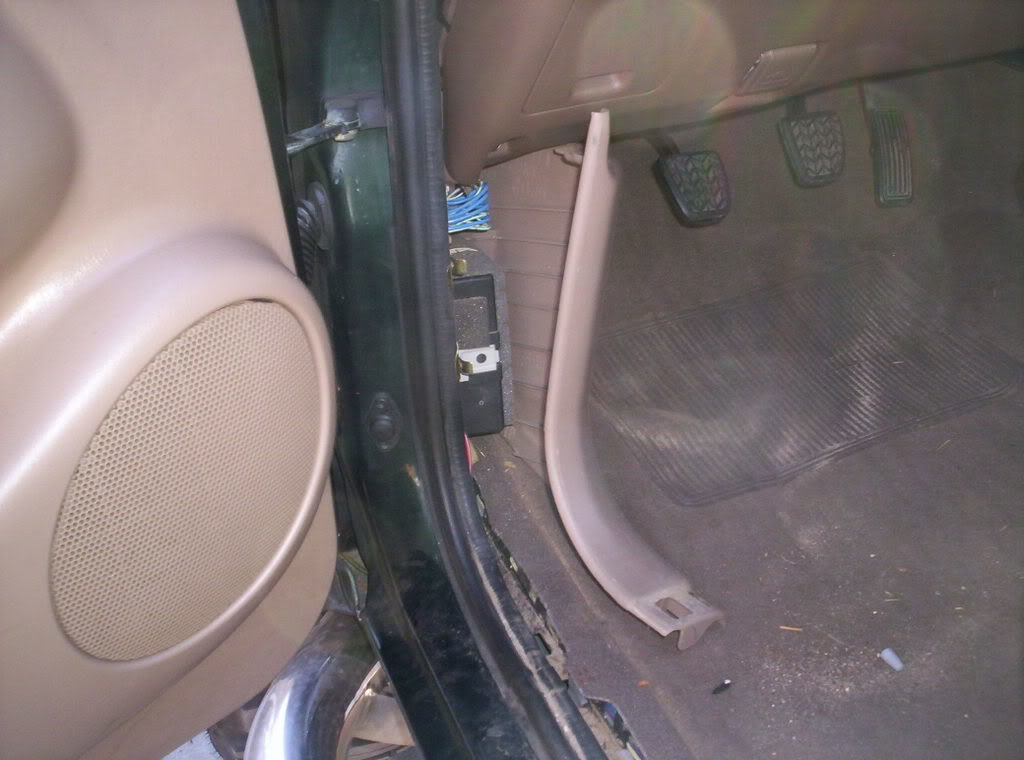

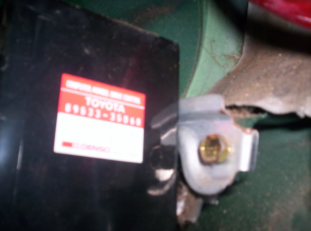

    this mod will let me use the locker in 2wd 4hi and 4 lo insted of just 4lo i have a 2003 trd 4x4 it worked on my truck and i am showing you how i did it dont blame me if you screw something up this is the gray wire mod i have seen it on ther sites but i decided to put my truck on the line and try it on my truck sorry for the spelling
    start with taking off a couple trim peices 4 screws and a little tug gets them off
    now locate the 4wd computer it stands out

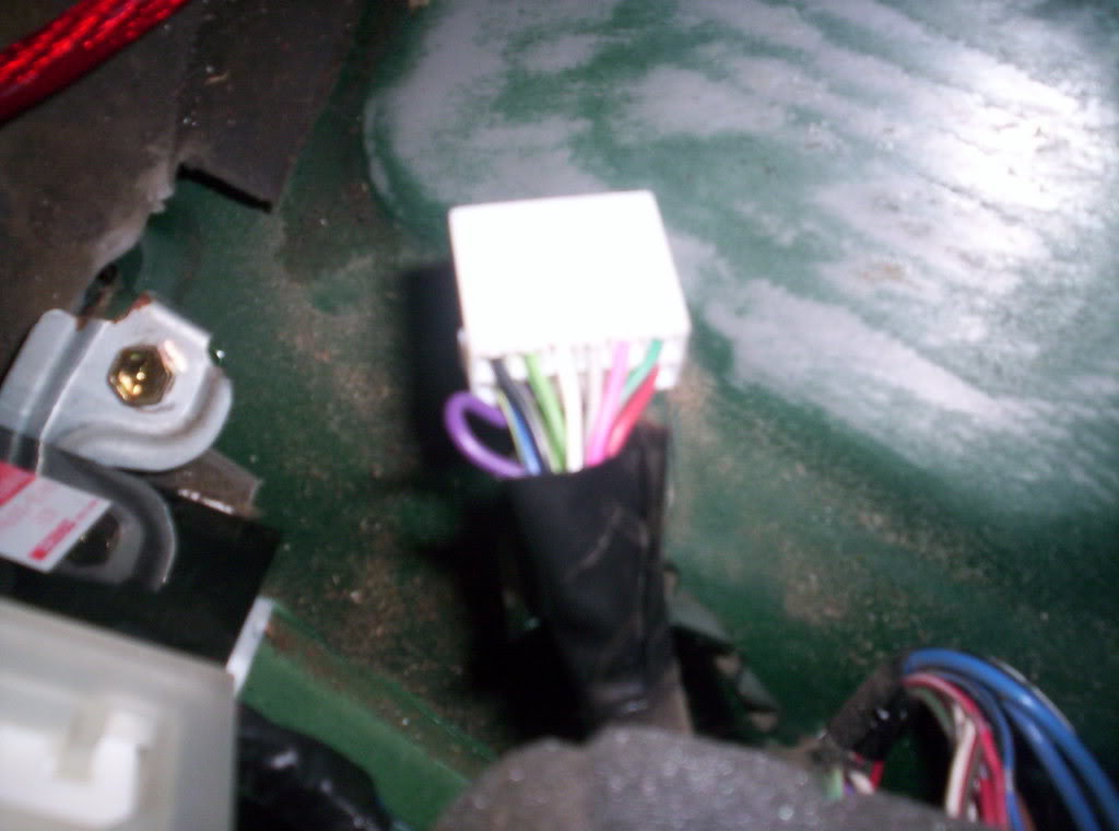

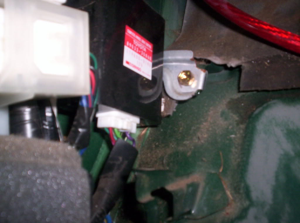

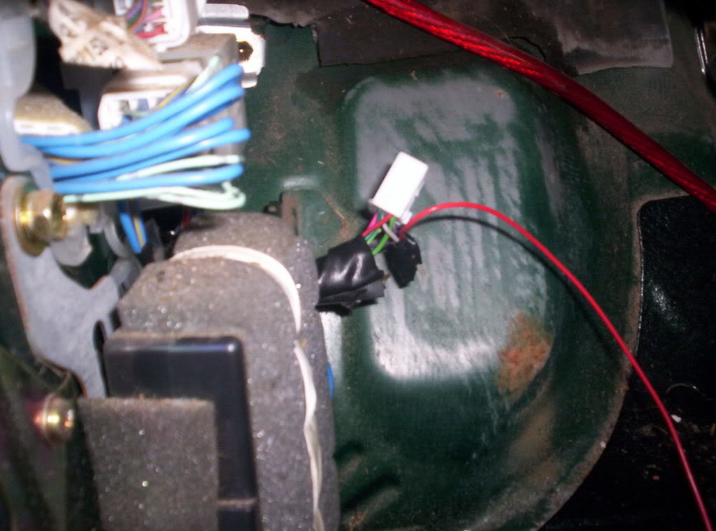

    there is a plug in the bottom unplug it and locate the gray wire i have heard on some trucks the color is diff

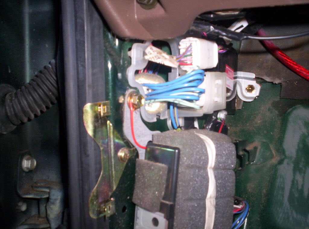

    now cut the gray wire about 6in from the connector and attach a peice of wire i used some red wire i had attach it to the part coming from the connector and then tape it up to make sure it doesnt come lose also tape the other end of the wire not being used anymore
    now i ran the red wire to a ground screw that was already there
    and thats it test it before you put every thing back together

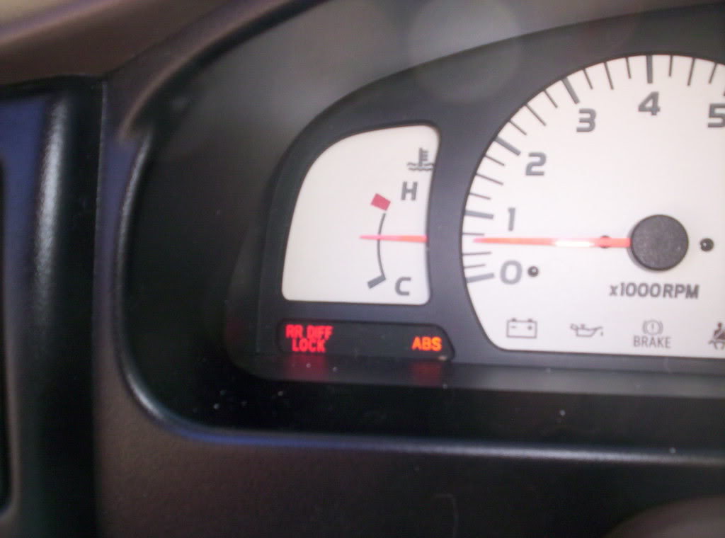

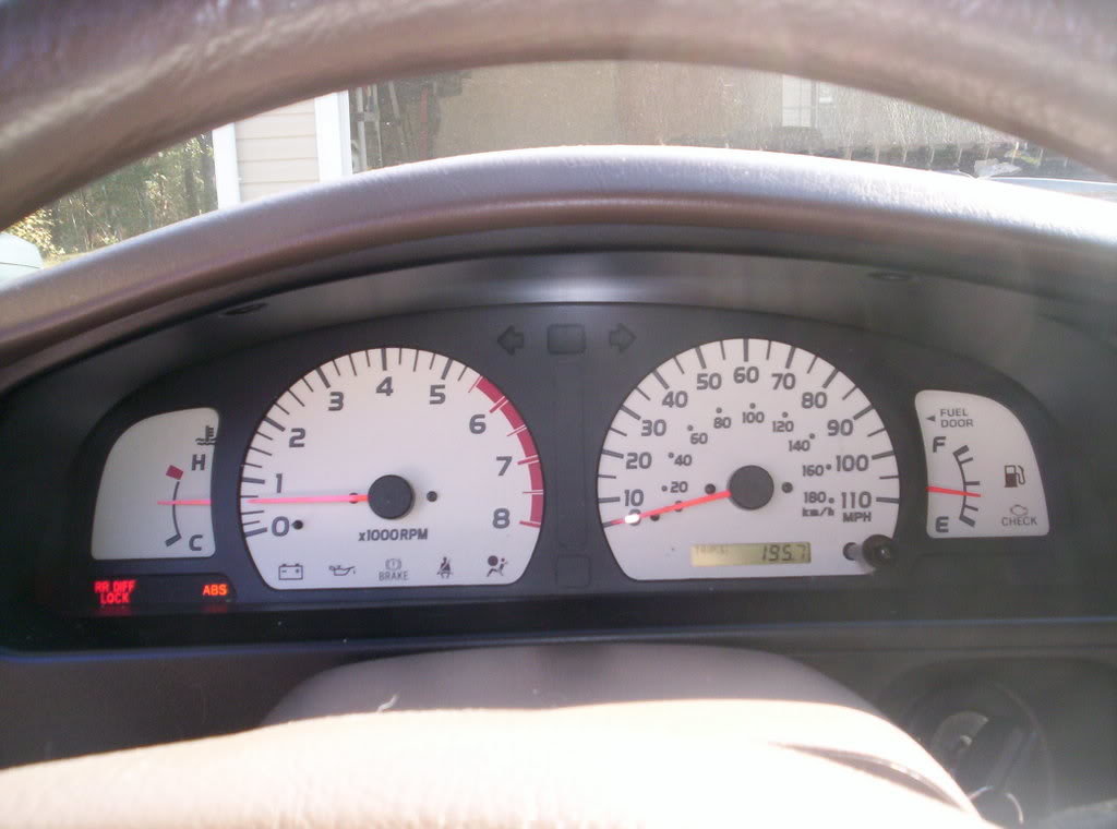

    notice the 4wd light is not on but the locker light is on
    now put everthing back together and go find some mud to try it out it took me about 30 mins to do it

    Hey thanks for the posted I went out and did this mod today. Very very easy but i was wondering about the rear locker indicater light on the dash
    when the locker is engaged does the light stay on or does it flash?

    mine stays on but i have to drive back and forth a couple of feet you should be able to hear it turning on

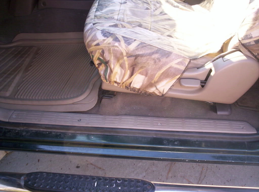

    Love the seat covers!

    thanks they were an ebay find

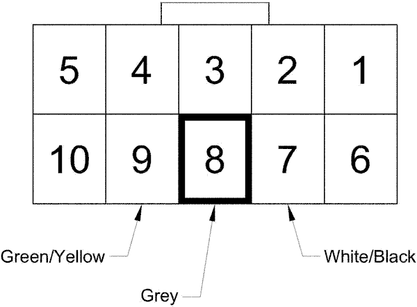

    In some rare cases, there is a different color wire used in place of the grey wire. The best way to identify the correct wire is to locate prong number 8. This wire is in the bottom middle of the plug, between a green/yellow wire and a white/black wire did you get the rite wire is it driving better since you hooked the wire back upgwlm-diagram_bd590a113481860208b2c8f287be27e35f367bf9.gif

    stucks did you hook your wire to the peice coming from the plug and not the one that runs up to the dash was it a good ground did you ever get the light to stay on instedd of just blink

    From the pictures it looks like GB just stripped the wire and wrapped it around the screw, IMO a crimp type connector should be used.

    thanks for backing me up on this one steves i should have use3d a crimp type but i was in such a herry to try it i will take it back apart this weekend and do it rite

    This is probably a crazy thought but the screw I grounded it out on had another wire grounded to it maybe the gray wire what shorting something out or something along theses lines lol ya i know way out there
    hopefully i will have time this weekend to mess with it somemore

    O shit im going to look really really stupid but i grounded the wrong end of the wire LOL i grounded the end of the wire that goes out to the truck i didnt ground the end of the wire that goes into the computer haha
    that should fix it
