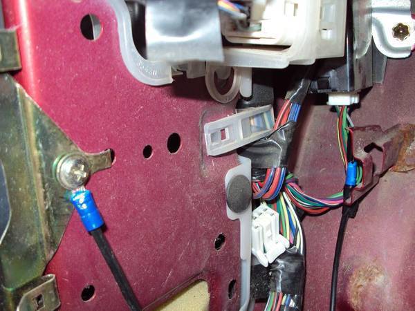

    Does anyone know the size of that ground bolt? I opened everything up and that bolt is missing
  15. Feb 2, 2011 at 12:10 PM
    #215
    4WD
    4WD cRaZy oLdmAn
    Jul 2, 2009
    #19185
    23,530
    Doug
    Lakeside, Ca / Gardnerville, Nevada
    2004 DC TRD 4x
    Grey wire MOD, deck plate, diff breather MOD, 2nd gen. OME 883# on Tundra 5100's, OMD custom 3" leafsprings, rear shock relocation, Ivan Stewart TRD rims w/285/75/16's, '02 bumper MOD, Famous Fabrications sliders , LED interior/exterior lights, bed bar, Custom tube bumper, Old school KC day lighters,Red Ring 8" HID flood, Kenwood vhf 2M.. umm some other shit I'm forgetting right now
    Ground bolt for what ?? Just use an existing screw close by like I did, I'll find a pic for ya..;)
  16. Feb 2, 2011 at 1:04 PM
    #216
    malander
    malander Well-Known Member
    May 6, 2010
    #36656
    2,421
    max
    01 limited trd 4x4
    deck plate mod,jba cat back,bilstein 5100's,ome 883 springs, Allpro expos, allpro U-bolt flip kit, 10" Bilstien 5150 shocks, custom lower shock mounts
    There are two screws but their pretty much inaccessible. There is one threaded hole without a screw that is in the perfect spot for me except that the screw itself is missing.
  17. Feb 2, 2011 at 1:08 PM
    #217
    4WD
    4WD cRaZy oLdmAn
    Jul 2, 2009
    #19185
    23,530
    Doug
    2004 DC TRD 4x
    Well its just sheetmetal , find one to fit or just pop another one near the spot missing...;)
  18. Feb 2, 2011 at 2:44 PM
    #218
    malander
    May 6, 2010
    #36656
    2,421
    max
    01 limited trd 4x4
    Yeah I'll figure it out thanks Doug. For now the grey wire is crimped and I'll be looking for another ground or that screw
