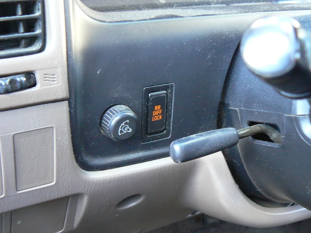

    Okay, maybe I didn't look good enough but when I went to do this a few months back I pulled back the kick panel and couldn't find the 4x4 computer? I know for a fact that I have a locker because it locks in when in 4lo.... Am I just dumb for not finding it or did they do something different with the 96 models?

    It locks in right when you put it in 4wd or you have a button :confused:
    Because if you don't have a button you don't have a E-locker

    If you have never pushed a button on the left side of the steering wheel you have never locked the rear. unless someone dropped in a lunchbox locker then your locking in 2wd too.
    This is the button if you don't have this you don't have a factory E-locker.

    Yeah, I don't have that button... :(

    Then you don't have a locker sorry bud :(
