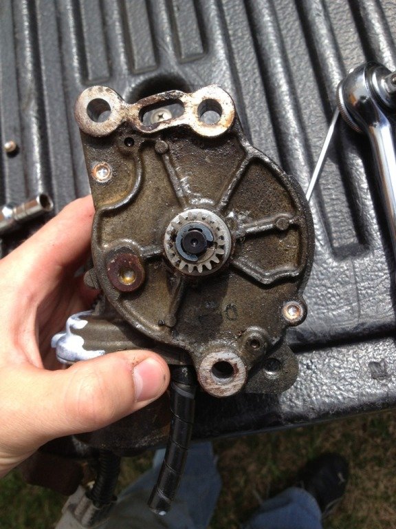

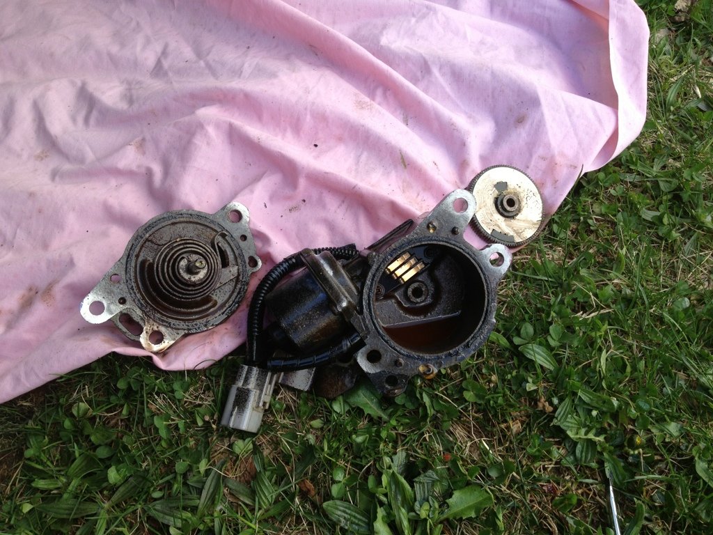

    It's not going well. I took it off again and took it apart. It was corroded and the arm couldn't even move. I got it moving again but it still doesn't work. I think the worm gear is also stuck. Ugh.

    Shit, sorry to hear man, its just getting worse as you get deeper into it & you say its stuck ? If you can't free it up , your probably done because both surfaces with be pitted/corroded/rusted/etc: does the servo motor still work ?

    I unfortunately and stupidly enough didn't try to run the servo unassembled to see if the worm gear moves freely. It's what I am going to do today. When I tested it assembled after I freed the arm I felt the servo get warm but no movement. We'll see what today brings.

    Same. This is as far as I got with the project:
    AFFF97A6-FFD2-4992-A992-B914200B379E-675_f612985a212b612164fcde8e0657f5c5c1ad746e.jpg
    97FC3A1F-4C64-489E-8CB2-9677457BA485-675_a4a31f02d19dd47a9173277d4ff3e9f34ddbda56.jpg
    Ran out of time that day and had to throw it back on till I can get time to play with it again.
