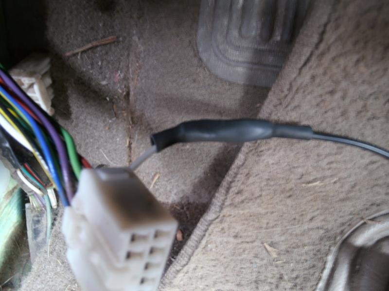

    I have a 12 pin on mine and had different colors on some of the pins. The pic you posted is a little blurred for me but if the third from the right and the top row is a gray wire and the second from the right is a green with white trace, you would cut the wire 3 from the right in the top row as we look at your pic...
    Also note this wire was a gray on my truck and it was a smaller size than the others on the plug. Least on mine it was. But it looks gray and I think the second one from the right looks green with a white trace. So I pretty sure your third wire from the right on the top row will be the one man.

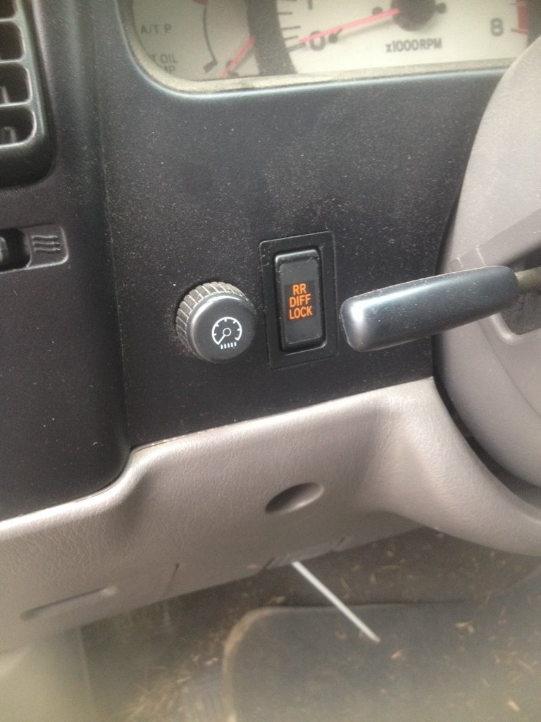

    I have an 02' v6 double cab 4wd SR5. Will the grey wire work on my truck? Also, will I still be able to shift into 4 hi while moving?

    If you not have a E-locker then the gray wire mod does not apply. But if you do then yes, you will still be able to shift into 4 hi while moving. This doesn't effect that.

    If you have a factory locker you will have that button.

    Yes, if you have the E-locker (with switch as shown in the photo above).
    Yes, the behaviour does not change with the grey-wire going between 2-Hi and 4-Hi while moving.

    Finally got this done. My wire colors are a little different than the OP shows. Also if you cut the grey wire 4 or 5 inches from the connector you can ground it back to the same screw that the 4WD controller is connected to without needing a separate wire.

    I did the "Gray Wire Mod" today. I may post some pictures tomorrow. I used quick connectors so I can return it to the stock configuration if I ever want to. So far it works great!
