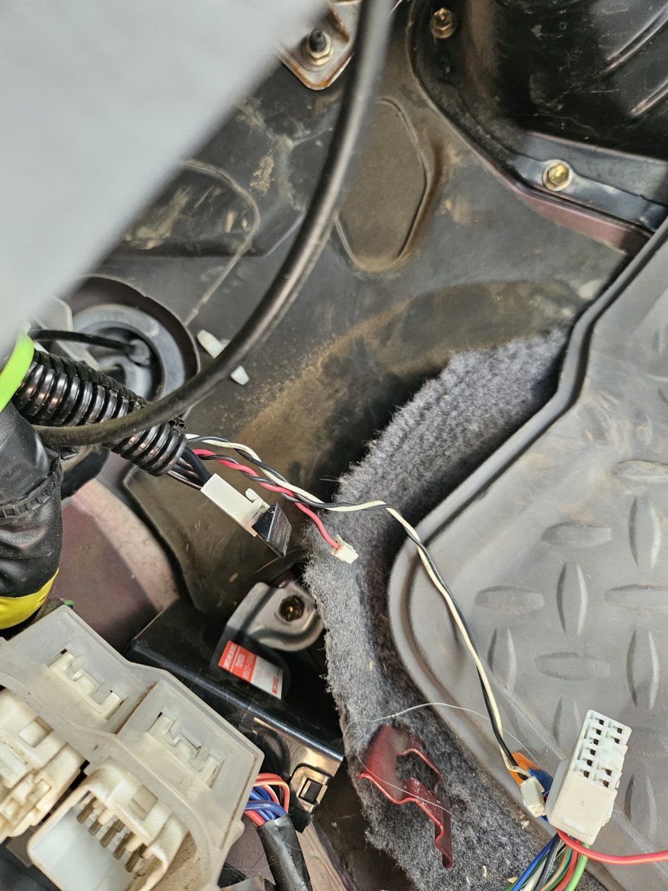

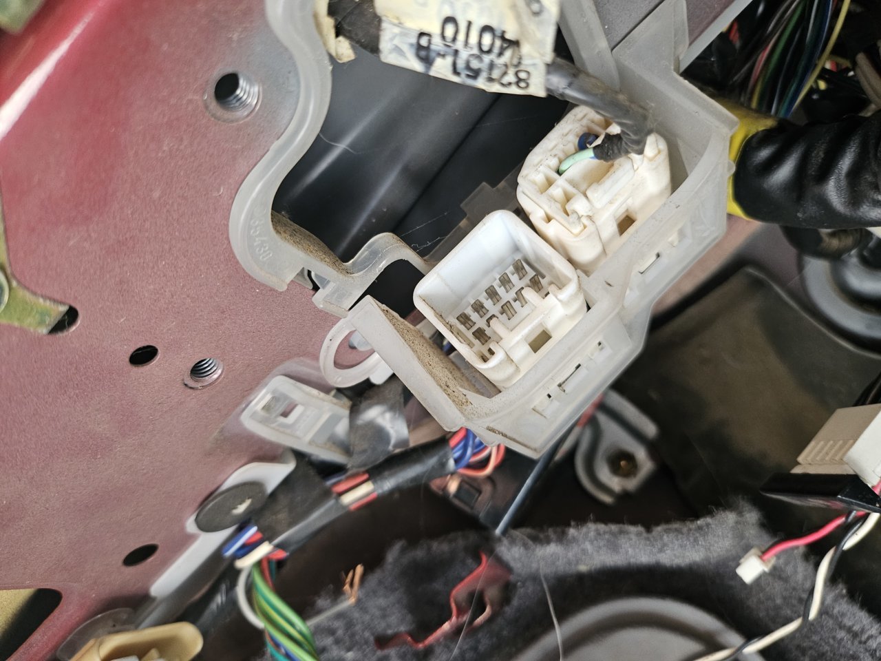

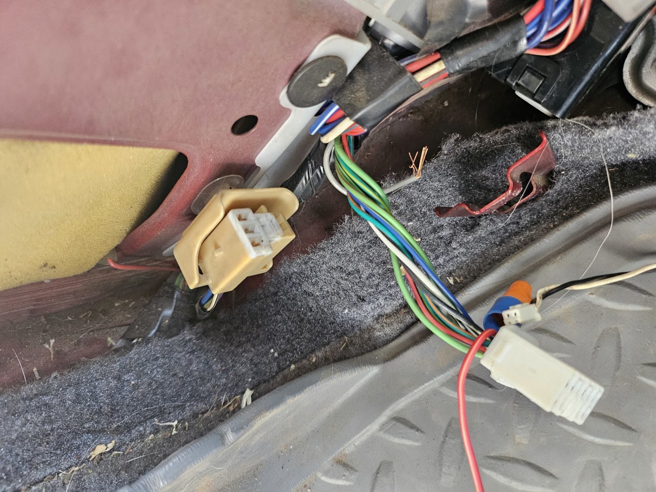

    So I've been waiting to do this mod and finally got around to it today. Come to find out someone already did it. Still the diff lock light stays flashing so will dissemble the actuator tomorrow and hopefully it was just covered in grease and nothing too serious is wrong with it. That out the way can anyone help me identify All these random plugs that clearly went to something but now is gone.?20230911_121728.jpg 20230911_121726.jpg 20230911_121720.jpg

    Is that behind the radio?
