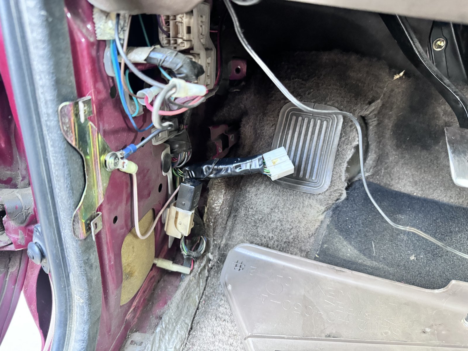

    No, it's under the kick panel on the drivers side. When you pull the cover off to get to the mod, these are what I found

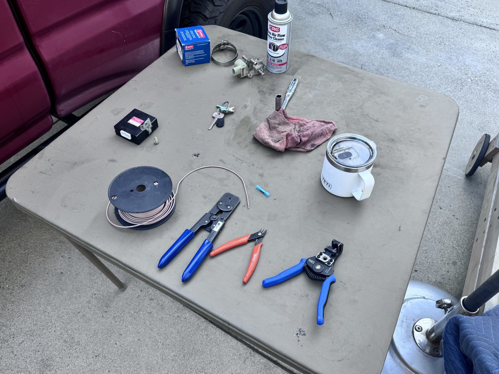

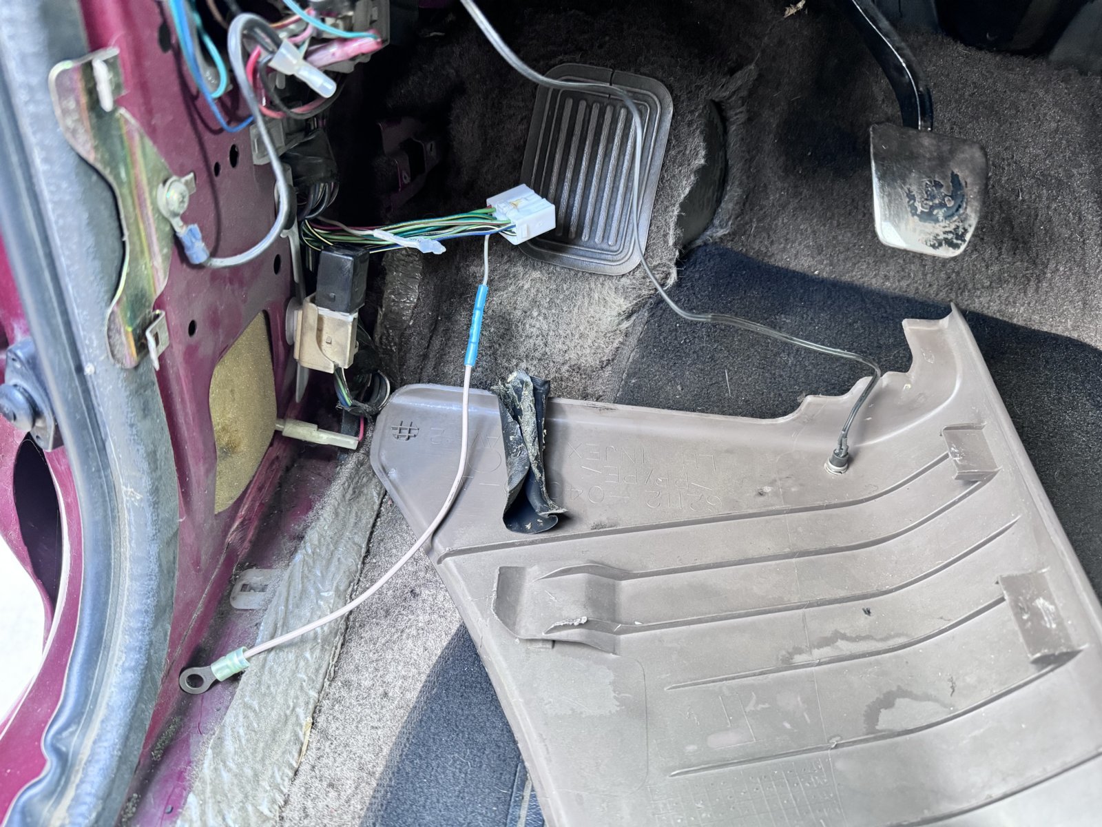

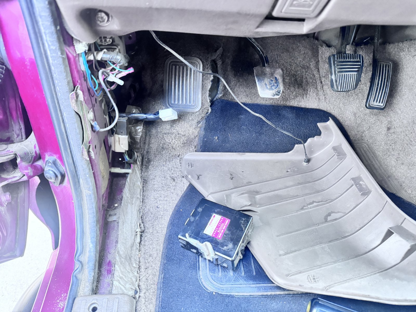

    The OP’s pic of the finished work isn’t easily discernible, so I thought I’d post a couple. I’m sure there’s probably some good pics in this thread from other users, but here’s what I did. Like most everyone has stated, only basic skills are needed to do this work, by the way. It took me about 20 minutes all in, which included running an extension chord a couple times(once because I was dumb and thought it would reach and the second was to get it right) for the heat gun.

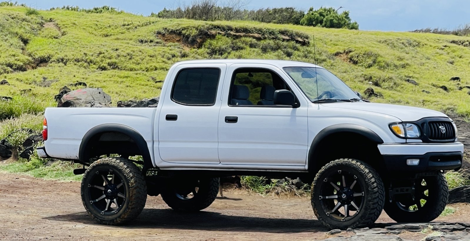

    Hi everyone. I haven’t been on any Tacoma forum for a few years. Life just gets in the way. To keep this short, a few years ago I bought a 2002 4 door V-6 4x4 Tacoma. I hated and sold my new 2017 after 6 months and only 1500 miles, no power and constant shifting. Anyway I think my old 2002 has something similar to this mod. The locker light on the instrument panel blinks instead of staying on no matter if I’m in 2wd, 4wd high or 4wd lo if I push the button. I’ve checked this in 2wd with the locker button pushed and the light blinking and both rear wheels will turn. Does anyone know why the light only blinks? Was there another mod to turn on the locker in any gear? Or maybe the previous owner did something different to make the locker engage in any gear. I’m only the 2nd owner of this old, near 290,000 mile truck. I believe the engine was rebuilt at some point. I was told the gears were changed because previous owner was running 35” tires on 20” wheels. But I didn’t know or remember to ask about other mods. I switched back to 15” Alcoa 90’s style wheels with 31” tires. Trucks runs perfectly! I haul 275 gallons of water up a steep 2 mile rd from 2000 feet elevation to 3200 feet. A lot of weight for that little truck, but thanks to the lower gearing, it does it with ease. Thanks for any comments, advice or questions. Yeah, sorry I’m commenting on a very old post. But it seems to keep going. IMG_2901.jpg IMG_2944.jpg
