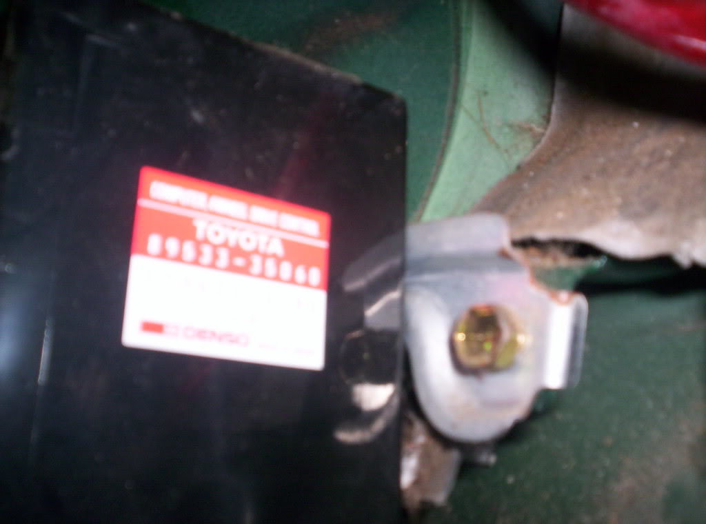

    did you guys have 6 wires or 5 wires like the diagram above. I really want to do this but dont wanna cut the wrong wire. I have a gray wire (the 3ed one over from the right is gray) but the diagram above says to cut a different one that what I have.
    What did you guys have in there? Please help

    i had 6 across like you(and like the pic). the gray one is the right one..... i had a thought though. instead of actually cutting the wire all you have to do is simply strip a short section of it then solder a jumper wire to the stripped bit. then ground the jumper wherever you wish.

    ok i'm a little lost here because i dont quite understand what a grey wire mod does

    it allows you to use your locking rear diff in 2wd 4hi and 4low. Stock you can only use the locker in 4low. if you noticed the diff light blinks when you try to use it in 2wd or 4hi. The light will turn solid when locked up. By doing this mod you will have a locked rear diff in any gear.

    ok wellt my truck has the grey wire on the harness but it does not have that module so i dont know

    SO YOU DON'T HAVE THIS BLACK BOX WITH THE RED STICKER?
    WHERE DOES YOUR GRAY WIRE GO TO THEN??

    just did it, works great!

    there is no plug at all the harness is just hanging there
