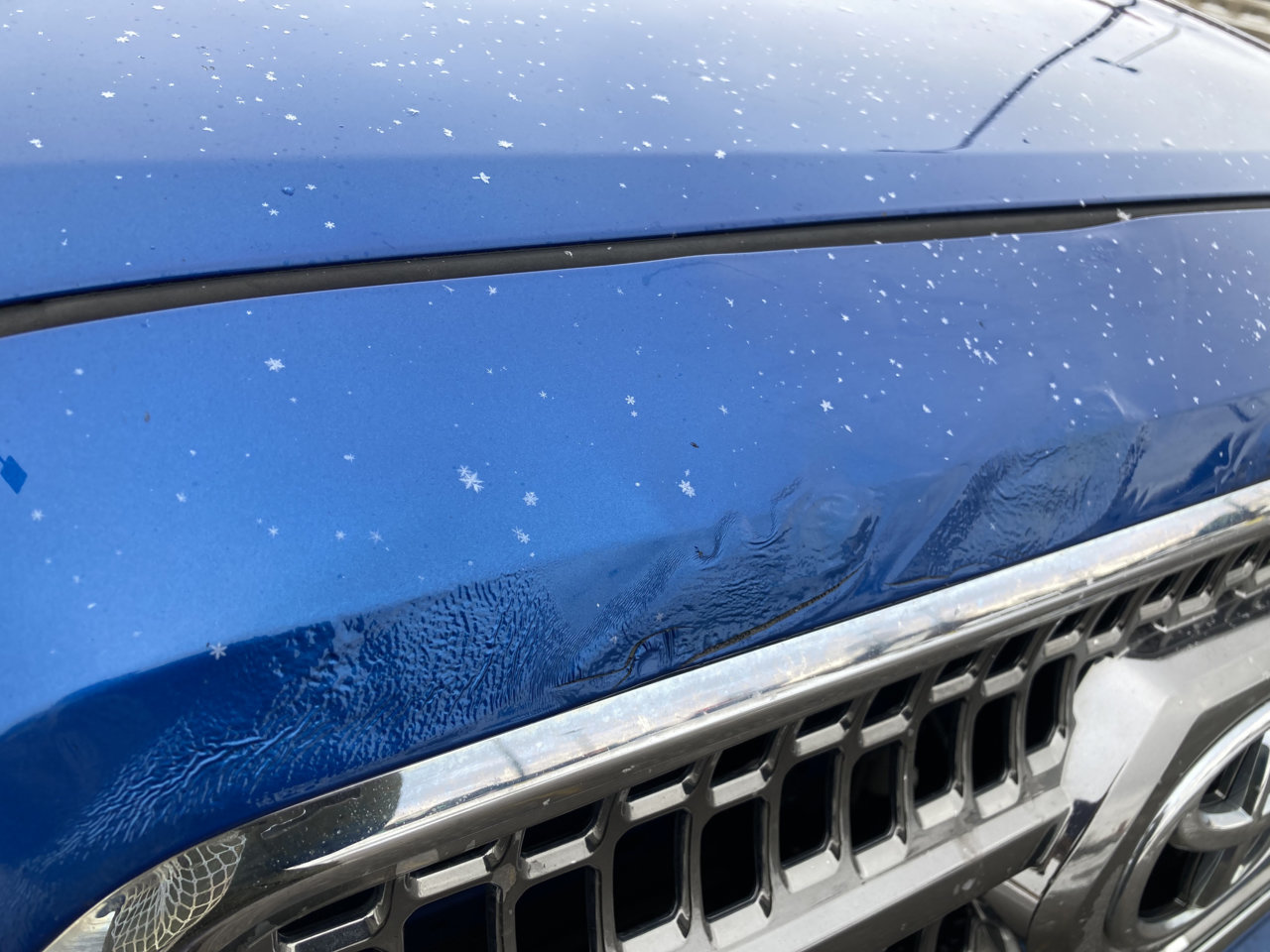

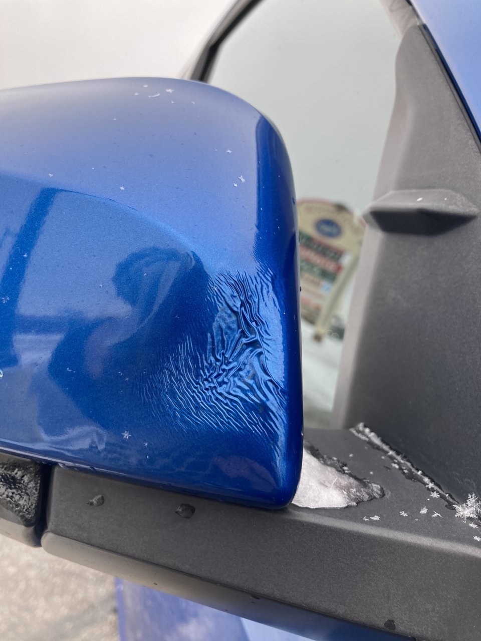

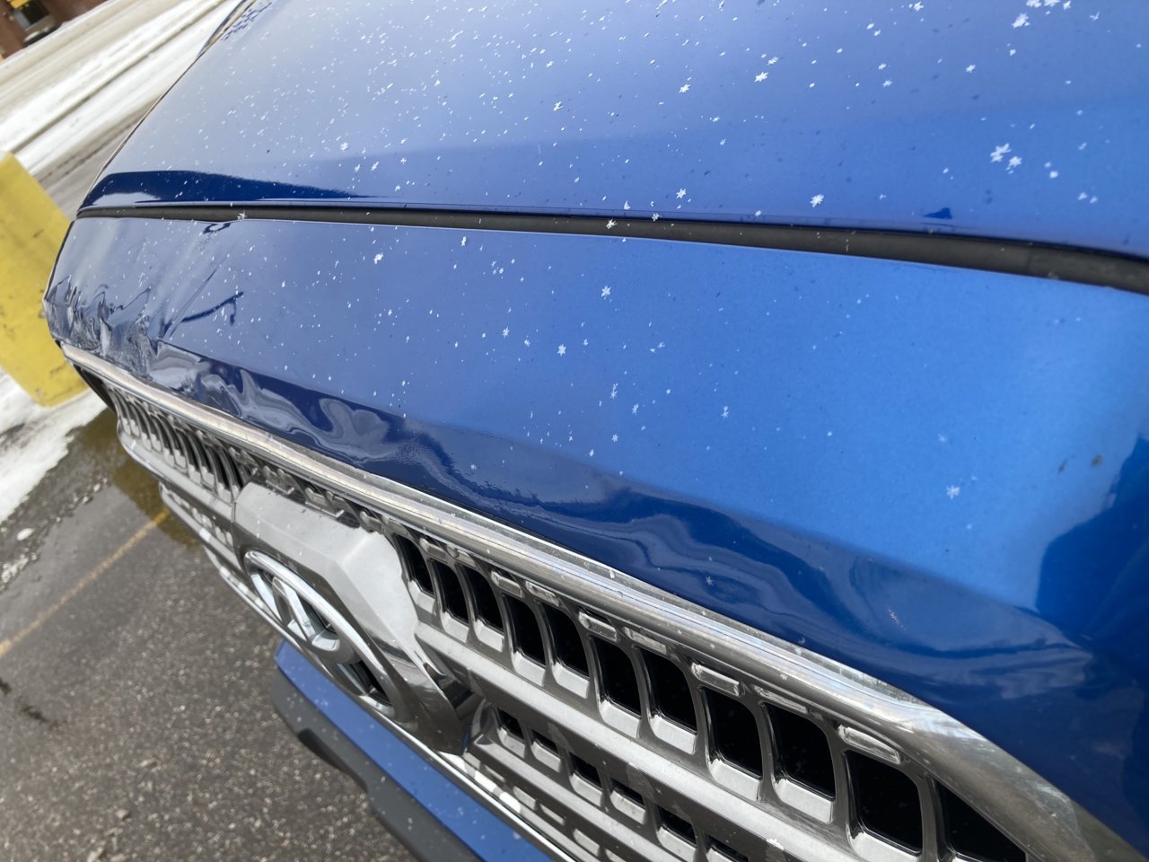

    Has anyone ever experienced this melting on your grill and mirrors?
    It’s the dead of winter here in N Indiana and because of the salt and snow I got an unlimited wash at the local carwash. I went 1-3 times a week this last month. I noticed some weird paint crinkling at the beginning and then it got worse and worse and started even warping the plastic. I took it to 2 dealership, body shops to get an estimate and both said it’s from heat and/or chemicals. As my truck sits outside in all the time the only heat or chemicals that come in contact with it are at the carwash.
    Has this happened to anyone else?

    The front grill melting is not uncommon, I have seen a few of them. But its not from the carwash or chemicals. 100% chance where your parking the sun is reflecting off a window and melting your truck.

    Holy shmoly, either your car wash has their dryer set on turbo jet heat or check you latest parking spaces for reflections in glass or other surfaces. You can file an insurance claim since that looks kinda expensive due to the bumper .

    I remember reading a story about something like this years ago.. about multiple vehicles being damaged from the sun reflecting off their office building. I’ll see if I can dig up the story…
    https://www.nbcnews.com/sciencemain/london-skyscraper-can-melt-cars-set-buildings-fire-8c11069092
    Looks almost identical to OPs damage.
    I’ve been watching where I park since then.
    Google ‘solar reflection’ and you’ll learn more about it.
    This is *NOT* from a carwash dryer as they do not use heat (just imagine the liability if they did use heat).

    It’s not from heat. It’s from reflection/radiation.
