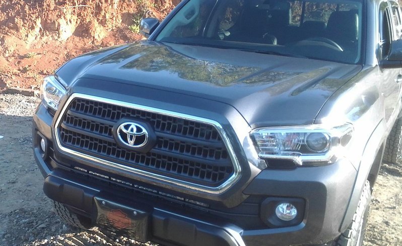

    whopper
    whopper 2016 MGM 4x4 double cab
    Jun 18, 2011
    #58464
    1,339
    wayne
    north carolina
    2016 tacoma double cab 4x4 MGM
    On going
    Plasti dip_20160505_105928.jpg 14000 miles no issues
