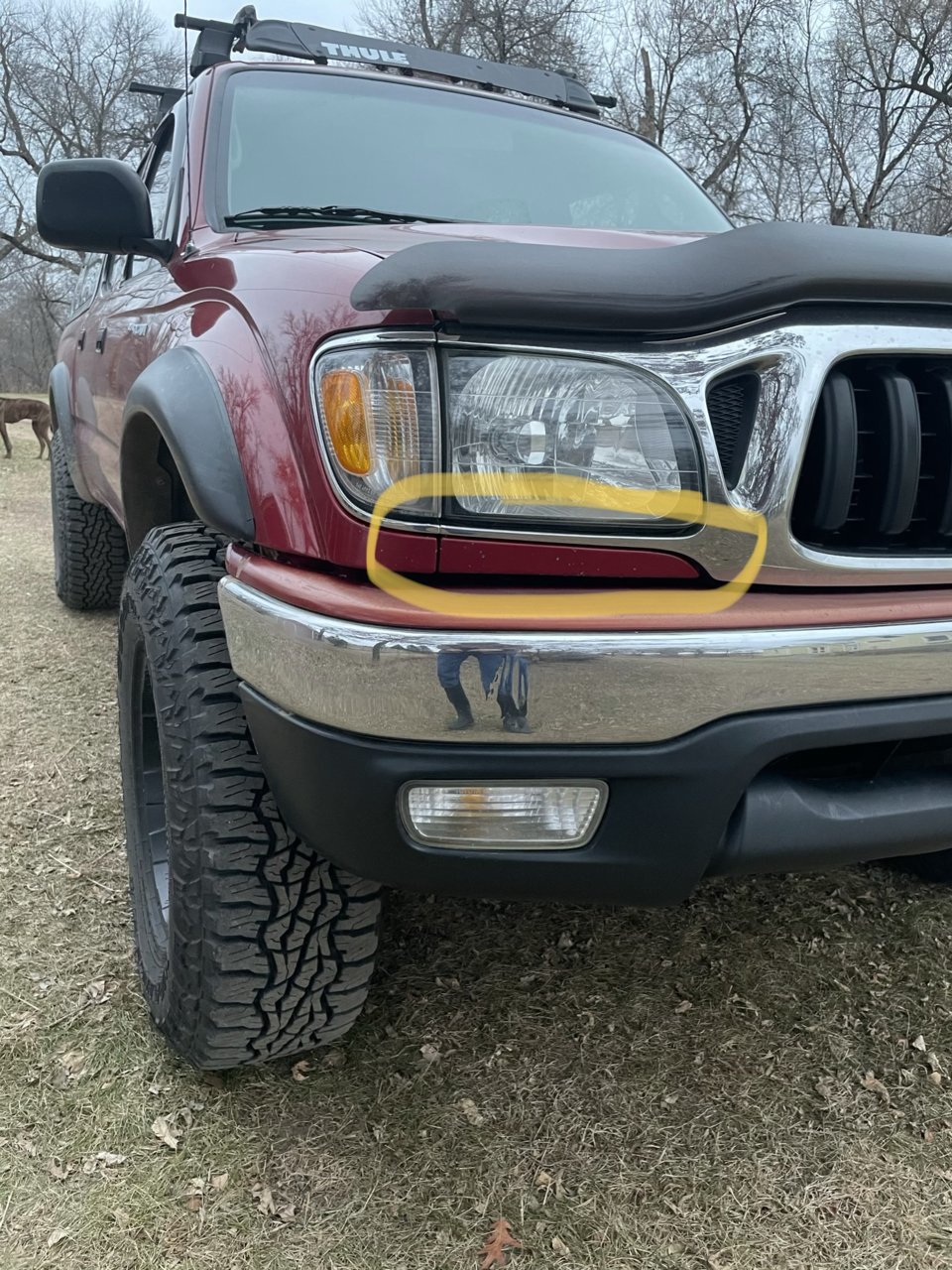

    Fixing up my truck after a deer hit, I’m taking the insurance money and installing an ARB bull bar. What is this part called? I’m looking for the driver’s side. I can’t seem to find it. Thanks

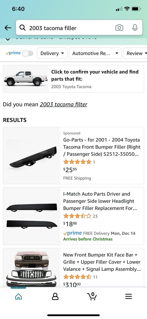

    It called a “filler”
    Some places call it a front bumper filler, others a Headlamp / Headlight filler.
    Most are paint to match.

    Wow thanks!

    I recently purchased an aftermarket one from ebay:
    https://www.ebay.com/itm/231178938229
    The fitment is ok but not great, I banged on it with a hammer a bit to get it closer. If I was going to do it again, I'd spend the extra $12 and get the OEM part.

    Also, once installed onto the grill (off the truck) you can run a zip tie around it on the backside so it won’t fall off in the future and no one will see the zip tie.
