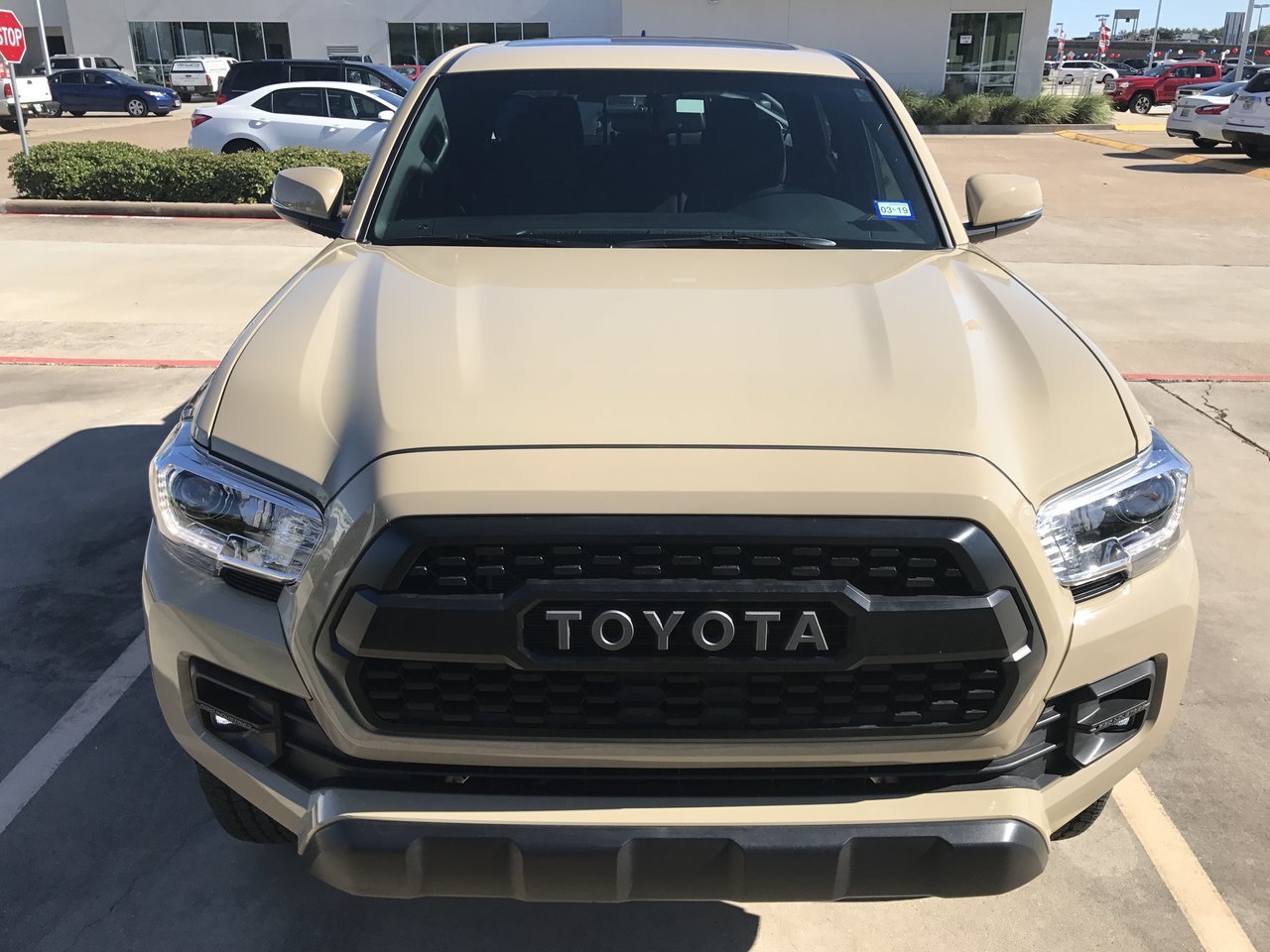

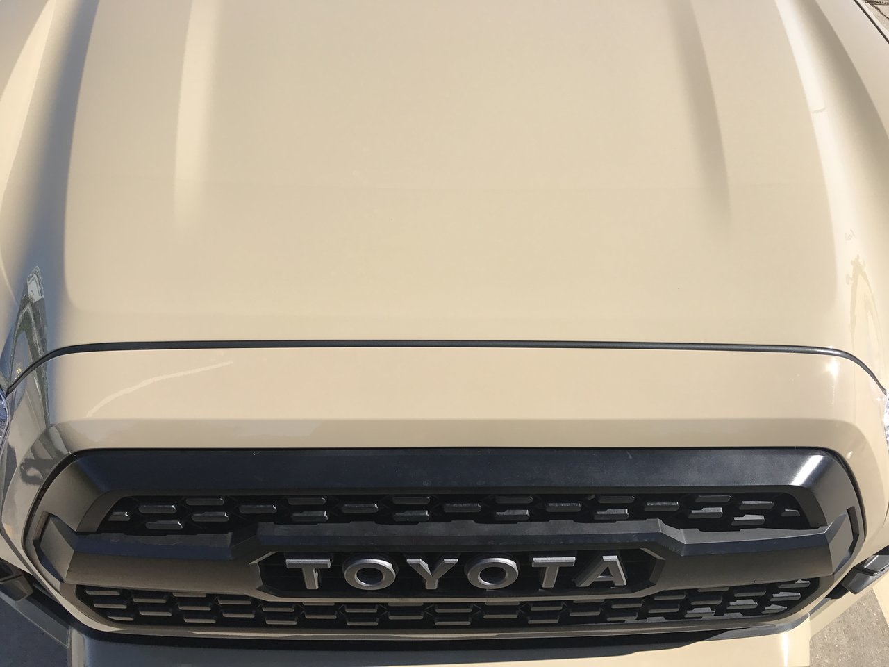

    UPDATE:
    The parts or shall I say the new grill surround arrived at the dealership on 10/05, only a few days after the dealership ordered the parts. Due to my busy work schedule I was not able to take my truck in for the repair until today. In addition my service adviser made sure that my preferred Toyota technician was scheduled to work in order to install the new grill surround. I dropped it off this morning, had the shuttle drop me off at my office as well as pick me up for my return trip to the dealership. Great dealership with a great staff providing excellent customer care and service.
    The new grill surround was installed UNDER WARRANTY and looks as good as I was expecting, like new. I'm glad to have the grill surround replaced and very happy with the service I received and look forward to NEVER having to deal with this particular problem again. And no the dealership could not provide any reason for the deformity. Regardless I'm happy this is complete.
    Here are the after photos:

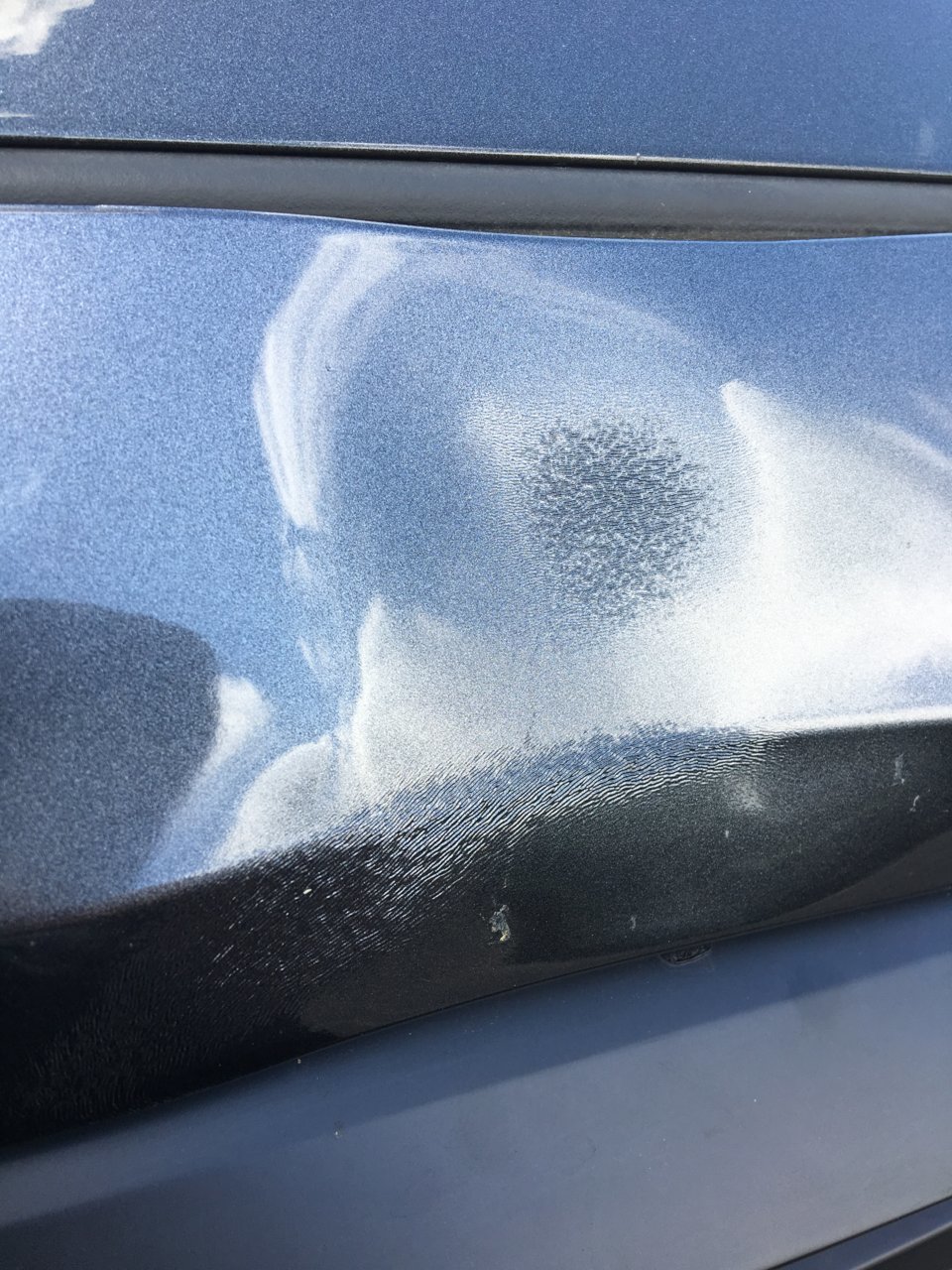

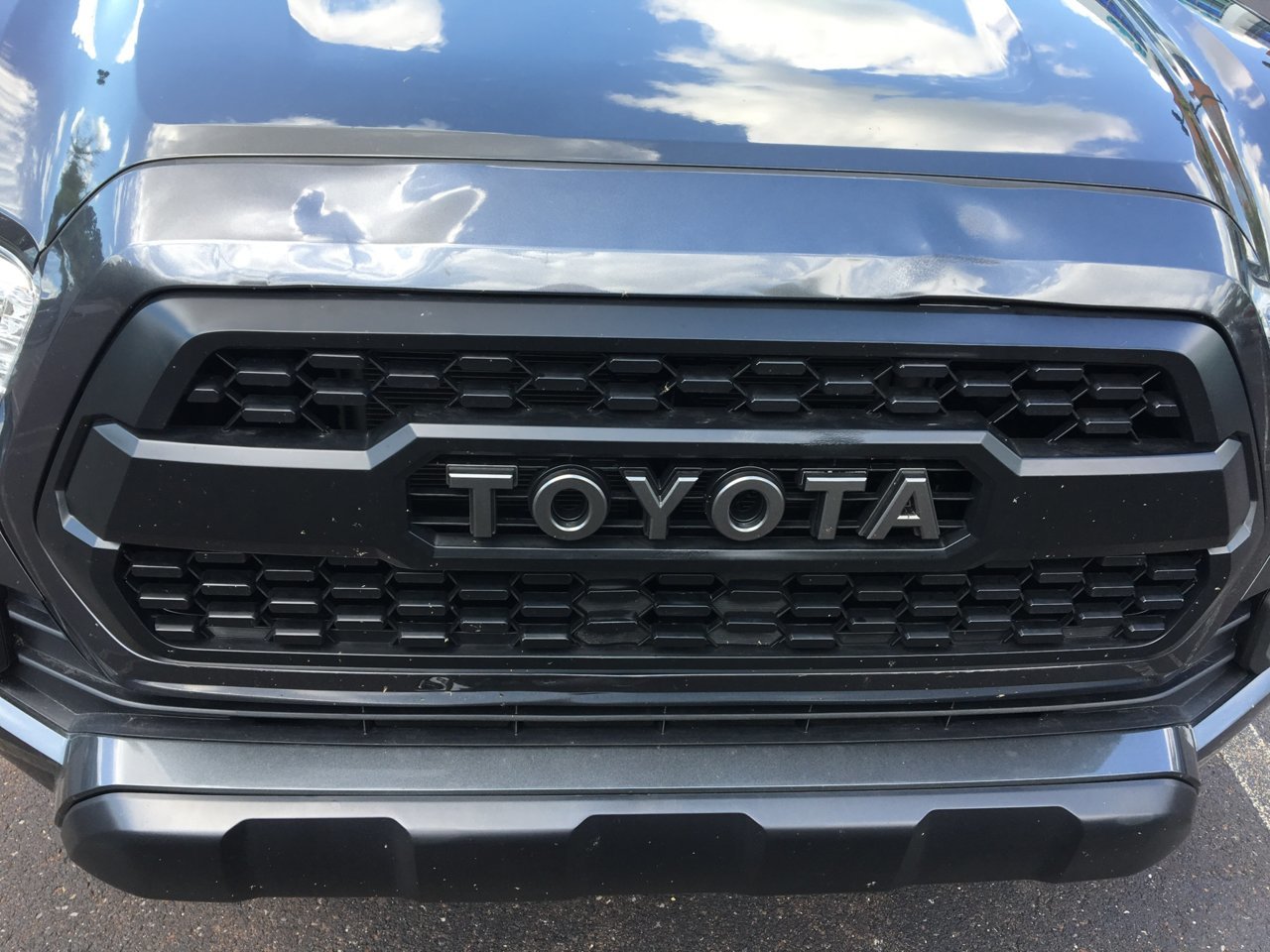

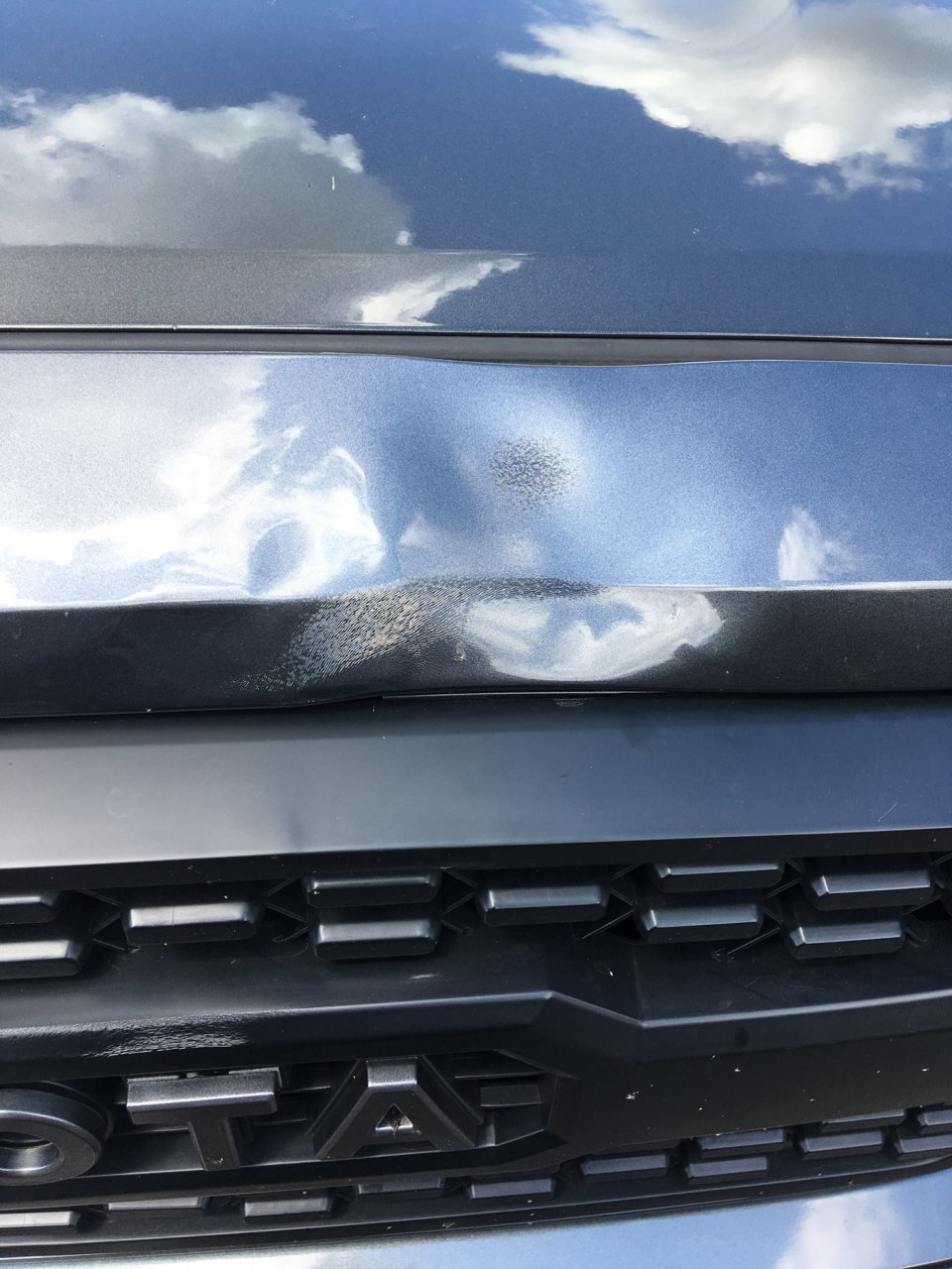

    00A05B39-4999-4460-AAB5-CC8688FDB490.jpg 3D8A5039-F091-4860-88E3-115AE069DA09.jpg B0631CE9-AED0-4614-90D1-96EBAD7FE1FC.jpg
    I’m running into this same currently. A few weeks ago a dent showed up in my bezel then another and now yesterday it’s literally like riveting and melting. I thought someone was doing this to me and even filed a police report. I knew it was happening at work though and we checked the cameras and NOTHING. I would drive to work with no new dents and leave with new ones. I did some googling and found this thread and some others.
    The building I work in is 100% glass windows and I park directly in front of them. Could this really be melting the plastic?
    I’m bringing my truck in on a Monday to Toyota but they just told me they’ve never heard of this even after seeing the pictures and they think someone is pouring some type of solvent on my truck causing this.

    Sad but true, the sun is reflected off the windows and melting the shroud. Happened to several guys here.

    Looks like the Grille melted above the "T" also.

    When I saw the photos I immediately thought of light reflecting off the glass basically causing a magnifying glass situation.
    Thats exactly what it looks like.
    I would not park infront of the windows anymore.
    I bet the damage will stop.
    Even the black plastic in the grille is melting.
