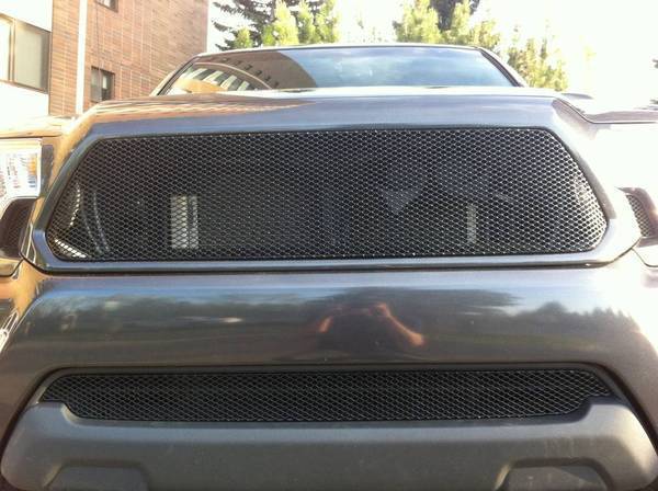

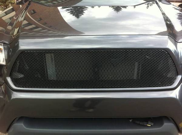

    I just installed one on my 2012 Off-Road along with a new body colour Toyota grill. It take about an hour for the upper and an hour for the lower if you have air tools or a dremmel. The lower you will need to remove the bumper cover as there are a few locking tabs hidden behind the crash bar. If you do not want to remove the bumper you can remove the 2 bolts that hold the bottom of the lower grill, 1 lock tab on either side that you can reach. Undo all tabs you can reach around the outside, grab the insert about 1/3 of the way in and give it a quick jerk, repeat for other side. Both tabs will break off cleanly. I have installed a few of these and I would say install is about the same as a t-Rex but fit and finish is alot higher quality with the GrillCraft.
    Upper only
    Upper and lower
