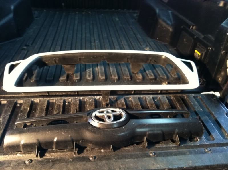

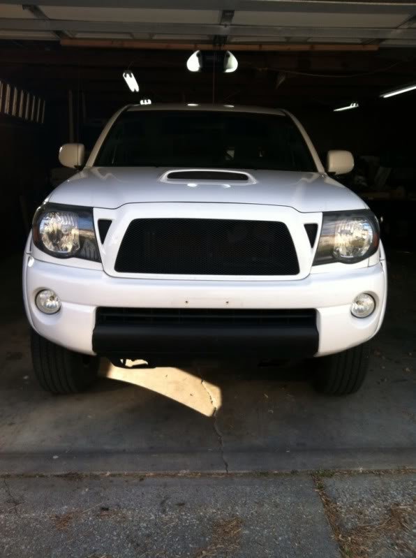

    Got my grillecraft installed today. Here is a little step by step.

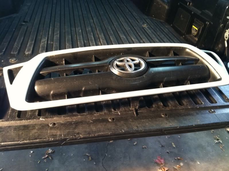

    Remove your grill and get it on a table of some kind.

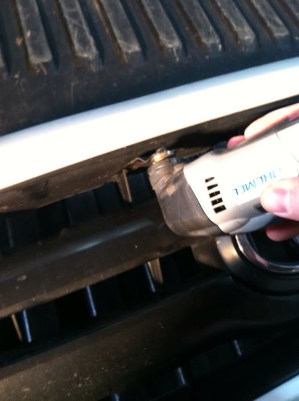

    Start cutting out the crossbars and center section, I used a dremel multimax.
    This is what you should be looking at now.

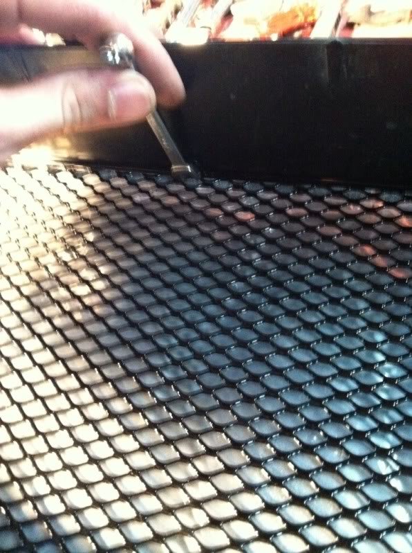

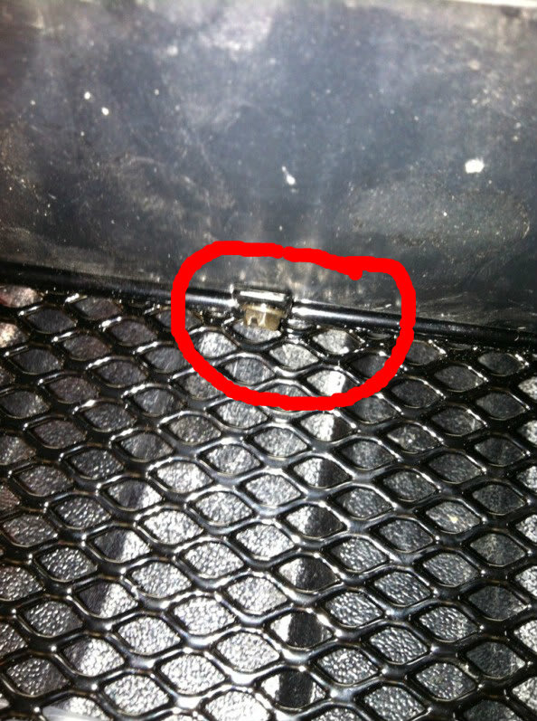

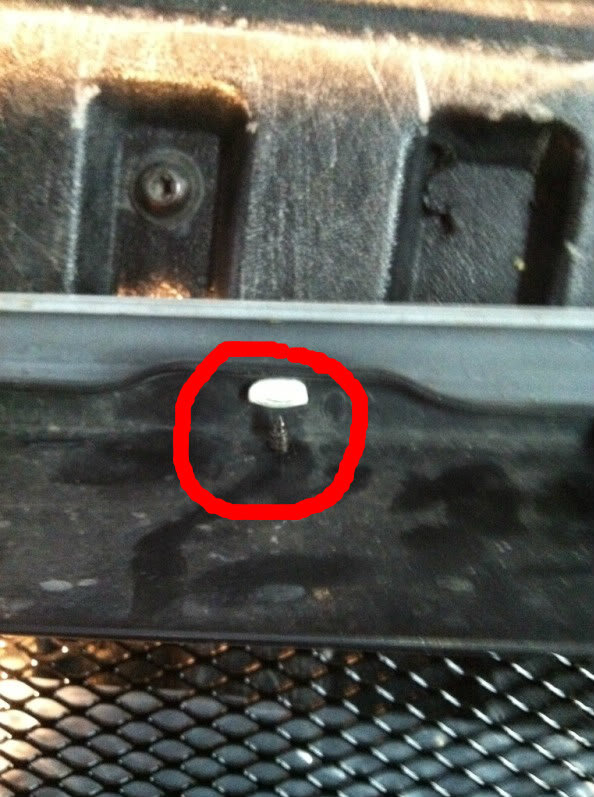

    Next, place the grillecraft grill into the shell from the frontside, mark the mounting holes with a pencil and drill them out using a 3/16 size bit.
    Insert the screws from the inside and put the backing plates on the opposite side and snug everything down, I used an open ended wrench, 1/4 inch.

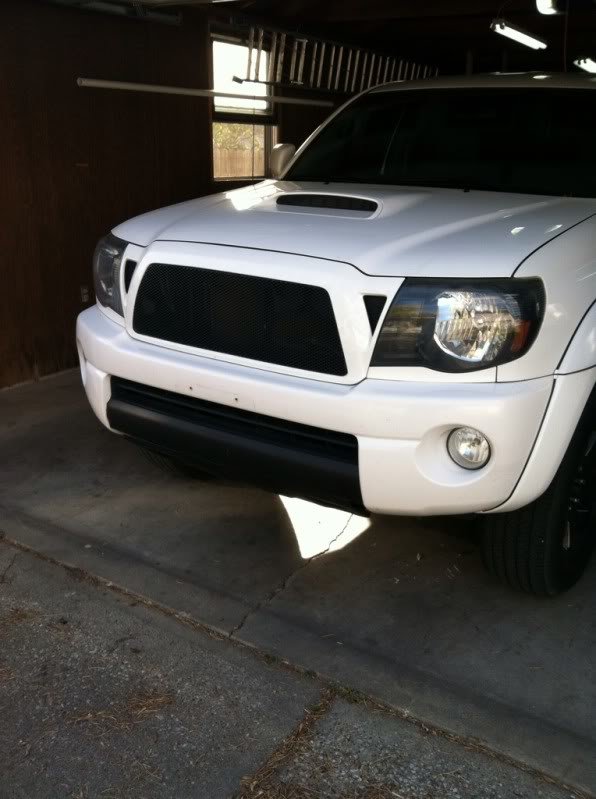

    Remount your grille and step back to admire your great work!
    Thats all for now, go big red ;)
