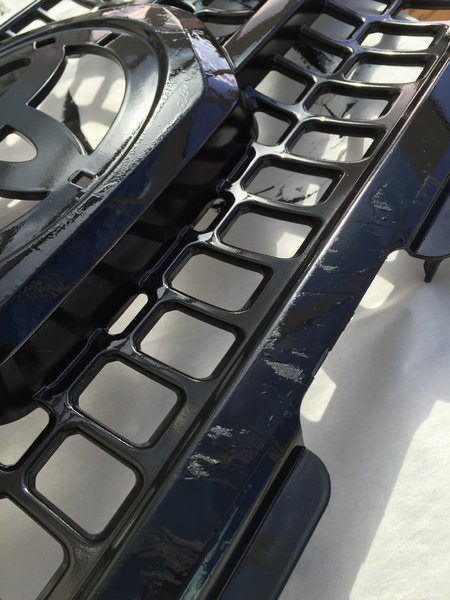

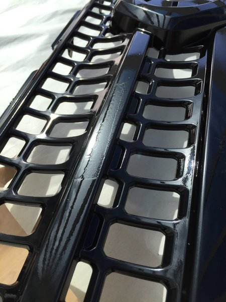

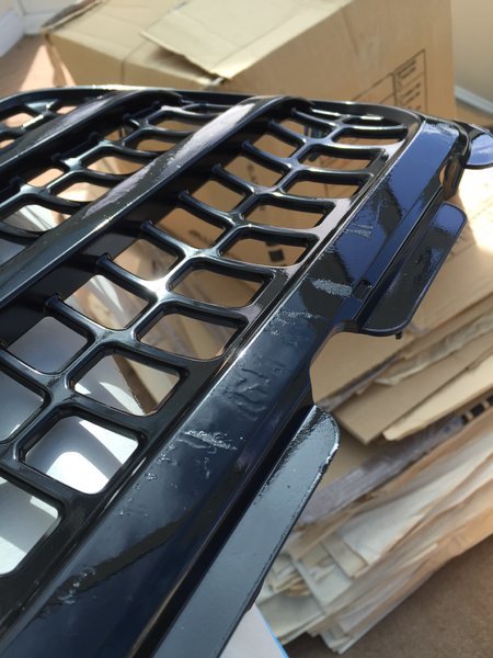

    Ok, dumb move on my part... I have been painting my grille all day and had a beautiful thing going on. Got to the last coat and figured since the sun was out I would let it cure in the sun room. Well Murphy got the best of me and it took a tumble. Face down. I took it back to the garage and covered the messed up areas but obviously they are really visible.
    I know I can't do anything until the paint is fully cured and when it is there will be loads of sanding to do. What is the best grit to start with. I was using a gloss acrylic based spray.

    To answer your question, 300 grit or higher. Use water with it, don't dry sand this issue.
    It will take much longer with the higher grit paper but you'll keep the integrity of the original plastic in check.

    Looking at it a 360 is where I would start. I'd see what your local hardware store has and stay around those grit ranges. The water will be the biggest part of this whole thing, higher the grit with the water the more time and smoothness it creates.
    Most folks are limited on fine grit paper like that but a Home Depot or the like 'should' carry around that 300 range.

    Yeah, that might hamstring this issue for you. Even a Scotch pad will probably do a good job for you. You can get those at a grocery store in the cleaning section. Same rules apply wet pad will keep it smooth but take longer.

    This is correct, with or without primer, it landed face down while still tacky... When I pulled it back off the paper it pulled most of the paint up and left some of the paper. This isn't my first rodeo here, just the first time I've had to extensively fix paint.
    Regardless of what's been laid down I just need to level out the damage and go from there. I was just trying to figure out the best place to start.
