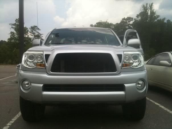

    i did this yesterday to my 08. it only took a couple hours of work, and overnight to let glue, JB weld and paint to dry. very sinple, looks great. i highly recommend it to anyone thinking of doing a new grill. much easier that Satoshi, and much much cheaper that grill craft. i think i spend around $30. i also did my lower bumper grill, just painted some lathe and zip tied it behind the stock. pics to come
    grill- wire lathe for plaster ------------free
    paint- primer and black undercoating-- 15
    JB weld / glue------------------------10
    i had some extra nuts, bolts, washers laying around, and thats about it.

    well its been about 3 or 4 days and some of the JB weld have failed. any ideas for another product? i was thinking gorilla glue or bondo

    I used ABS cement for all of my plastic fill on mine, and some pinhole filler post sanding. I did my triangles last night, put the mesh in with JB water weld- it seems to have done a good job.

    I used superglue and jb weld. May need to use both.

    i got some permatex 2 part 5 minute epoxy. it did the trick

    finally got my TOYOTA emblem and mounted it. i LOVE this mod, and suggest it to anyone who doesnt want to dive into a satoshi project and isnt looking to spend $200 on a grillcraft.
