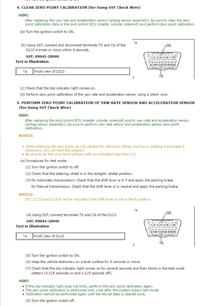

    I believe you have to recalibrate the vsc settings for the lift. Even if you turn it off. At 30-35 mph it automatically comes on (Reactivate).

    Here's the 3rd gen, just in case it's different.

    So far it’s working. I had to do it a couple times and the VSC turned on once now on me
