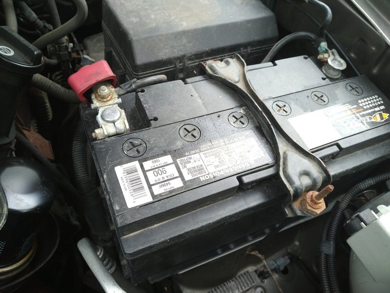

    yes it is that 649MF and here it is sitting in my 09 Taco CCLB 4x4

    As you can see the reserve is like 50% more and its much heavier than the stock one too.

    its like having 1.5 of stock batteries in one based on the reserve capacity
    That's why I bought it so I can play the radio at the beach all day and still start it up later on
