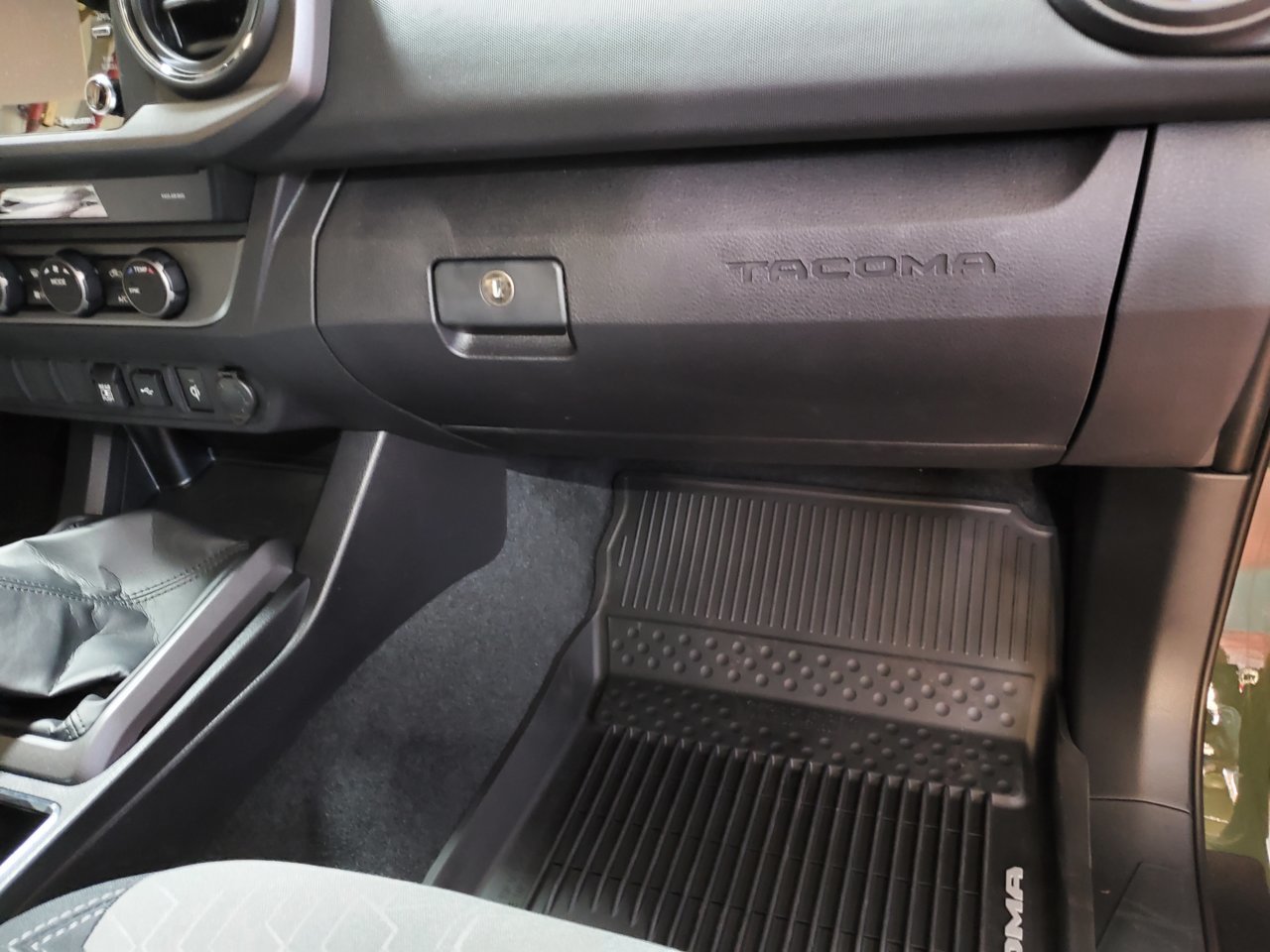

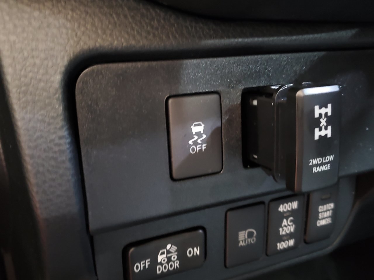

    Finally did the install today, thanks to all who did great write ups and photos on this! Everything went smoothly, except on my part....doh! I ordered the wrong switch size! Oh well, guess I'll order a new switch!

    Front and Rear lifts Tires ECGS bushing Lots of other crap +HP sticker
    were you able to fish the wire to the switch without taking the center dash apart?
    edit: anyone have pics of center lower switch installs?

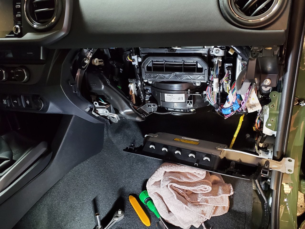

    The only way to install the 2LM is to pull the glove box and center vents. Some folks can reach behind the HVAC to pop out a switch, but most have to remove the HVAC also. Not hard at all. No fasteners, just clips.
    Here you go:

    I don't think anyone did get pictures of that part. Once you have the rest of the dash apart it's pretty straight forward. You can either struggle and use a coat hanger to get the wire over to the switch blank, remove the radio bezel and radio, or remove radio bezel and pop out the HVAC controls.
    The HVAC method is probably the easiest. You just need to pop loose the drivers side kick panel just below the ignition.

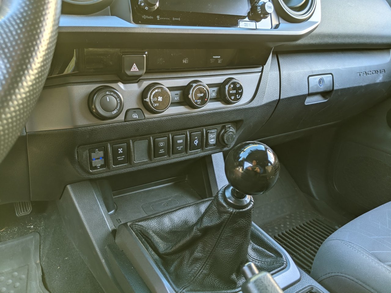

    I put mine in the center lower dash. I'm a pretty normal size guy and could snake my hand through from the passenger footwell to pop out the switch blank without any difficulty. Feeding the wire through to it was simple as well.
