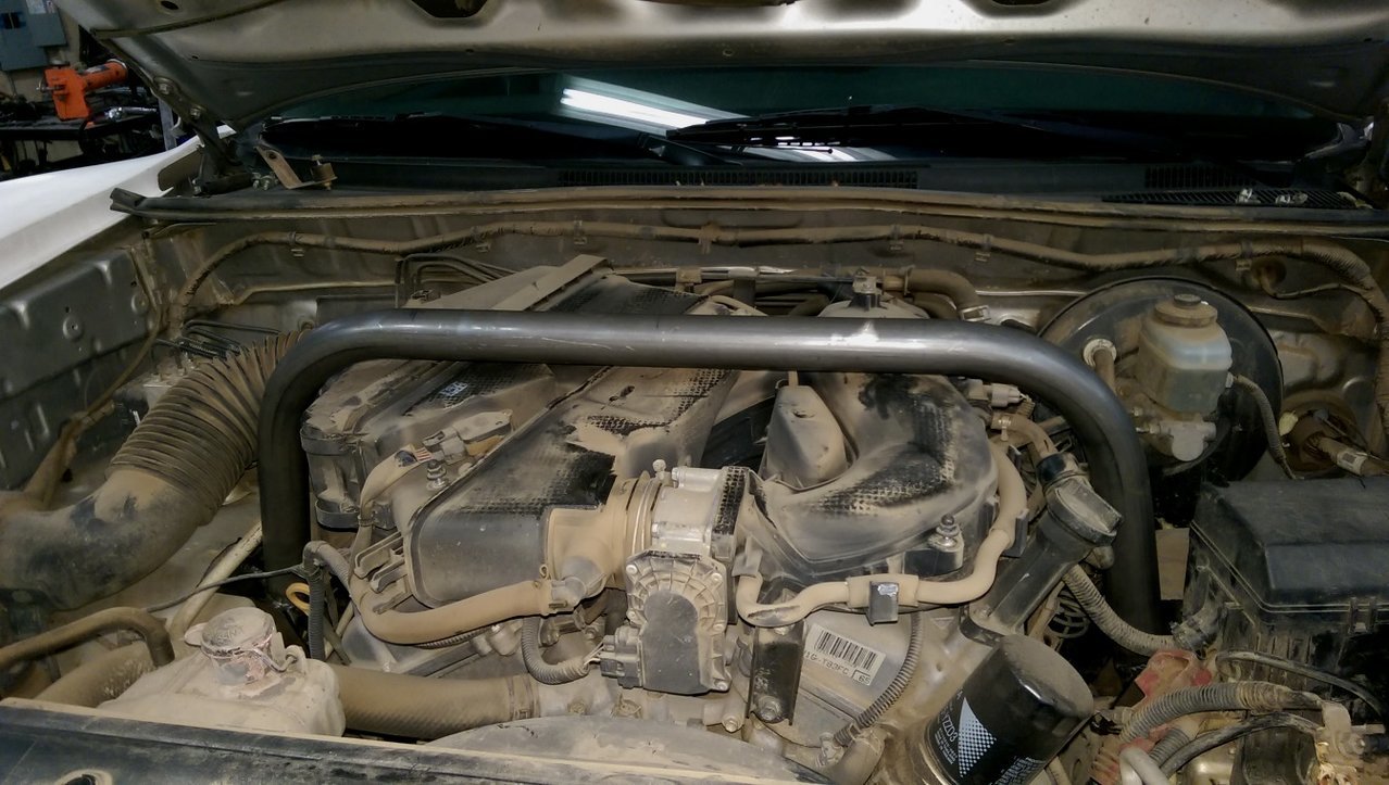

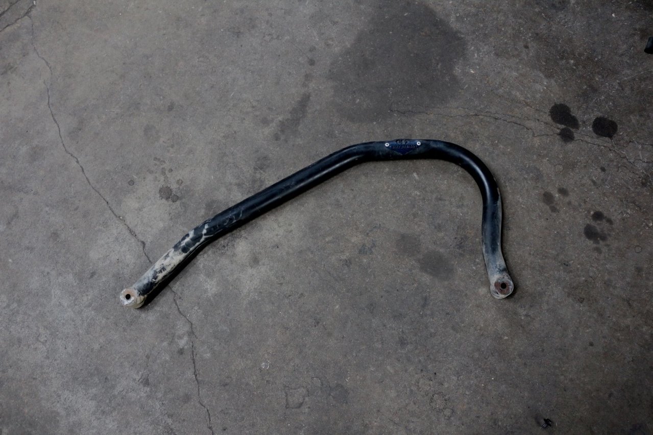

    We now have a jig for the engine crossovers. Im thinking of starting price at $150 for the welded crossover bar for standard 4.0L. It can fit with the engine cover, but the cover needs to be trimmed a little on the driver side. I havent shipped one yet so the shipping price is to be determined.

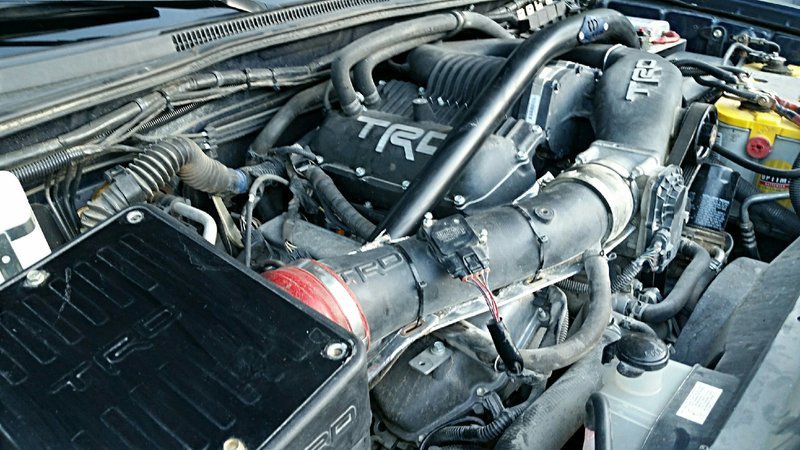

    And we will be making a jig for the TRD supercharger version soon. Its heavier wall tubing and harder to make so price will be ~$250. Same deal with shipping, not price yet

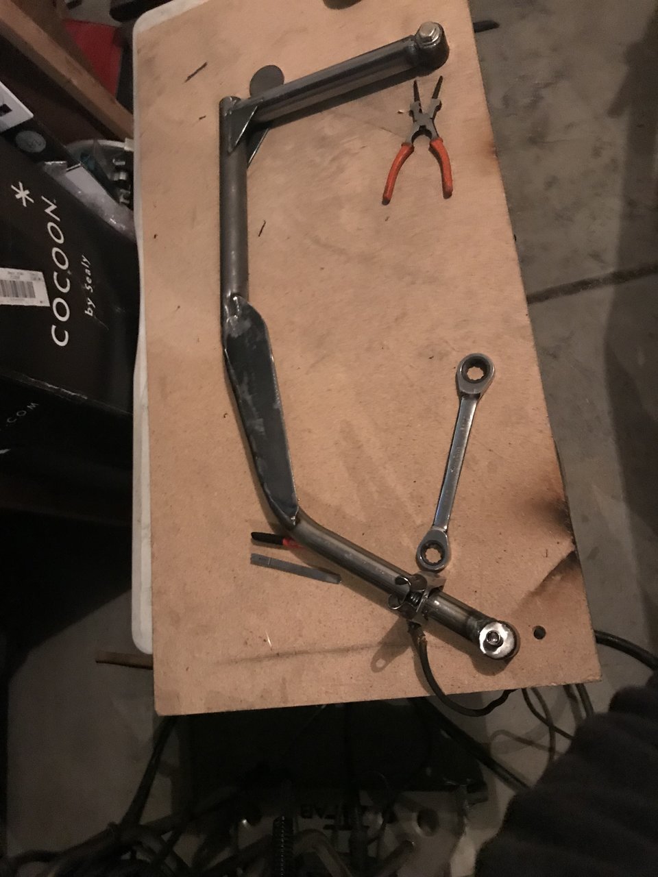

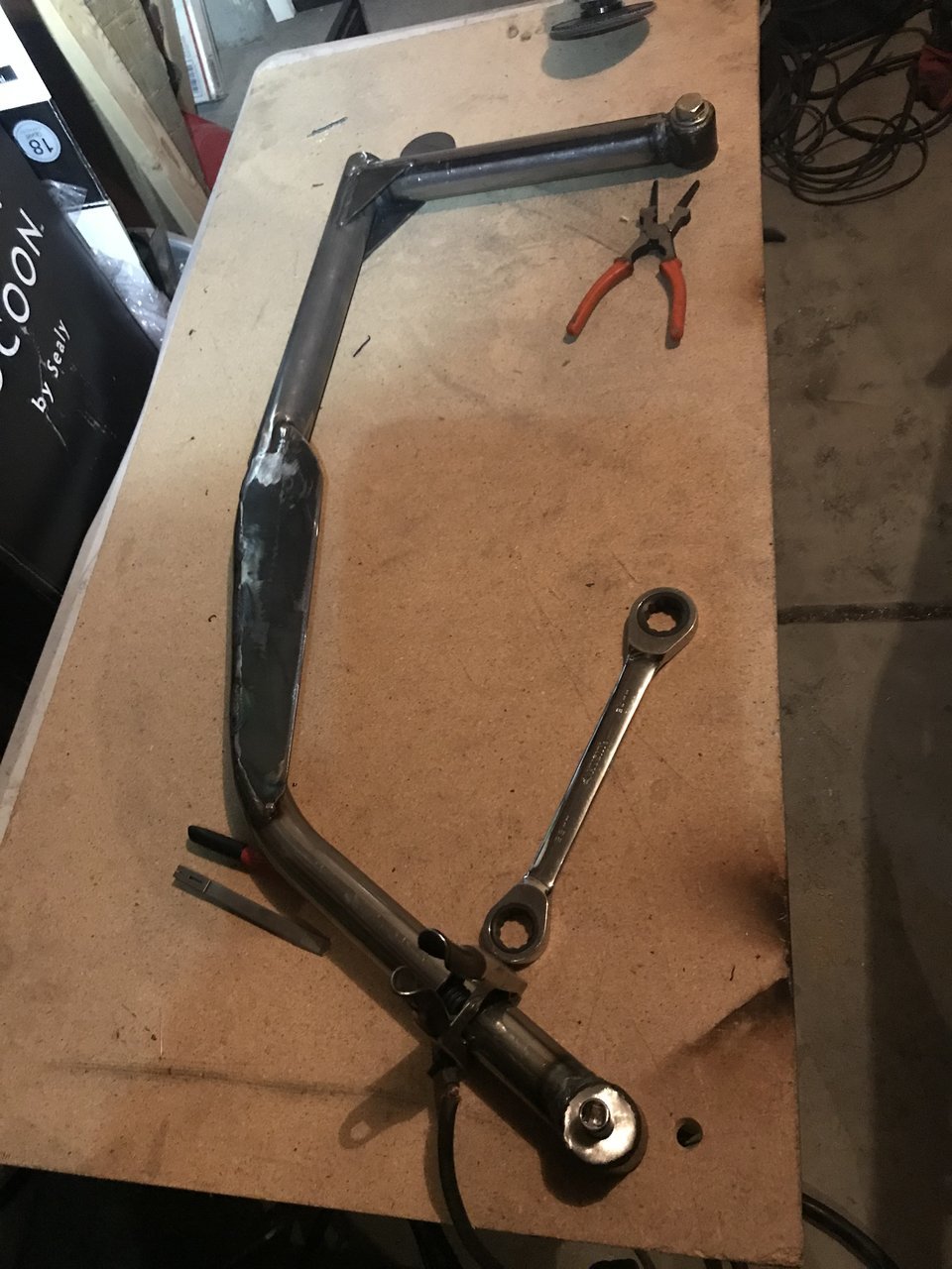

    Couple pictures of my cross member that fits with a supercharger and AFE cold air intake. I didn't have a die with a tight enough radius to fit around the supercharger on the driver side so I did joint and gusseted it on both sides. I also used 1.5" .120 wall sleeved inside of the 1.75" .120 wall on the straight areas to increase the strength as much as possible. Not as strong as a crossmember with more angle built into it but it is definitely better than nothing.
