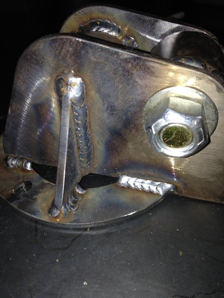

    image.jpg Got my parts today and finished burning them up, thanks @dirt designs!
    The_Black_Pearl and 2ndGenJonny like this.

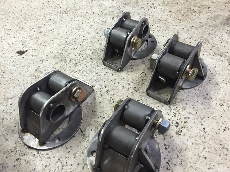

    Got mine today, already tacked together, which I was not expecting. Great looking product, thanks to Steve!

    Did you get the fully welded one or WIY? Mine had a small piece of tube tacked in that I am going to remove. Won't be doing secondary hoop now, but need to leave that section out for down the road. Mine will look like this one for a while.
