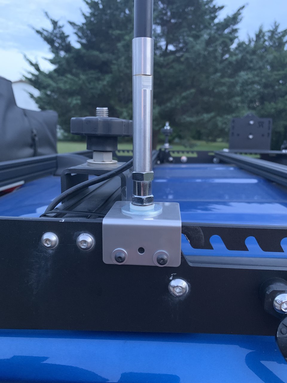

    So after getting tired of having the RAM mount get to the point where it was just laying back against the rack/rooftop, I ordered an L bracket from Gigaparts. It has three small bore hole in it, so I fit the bracket over the outside edge of my roof rack, drilled two holes (I think they were 1/8", and then tapped two M4 machine screws through it with nuts on the back side for security. Just got it on today, so haven't had a chance to really test it out yet. But anything is better than the RAM mount.

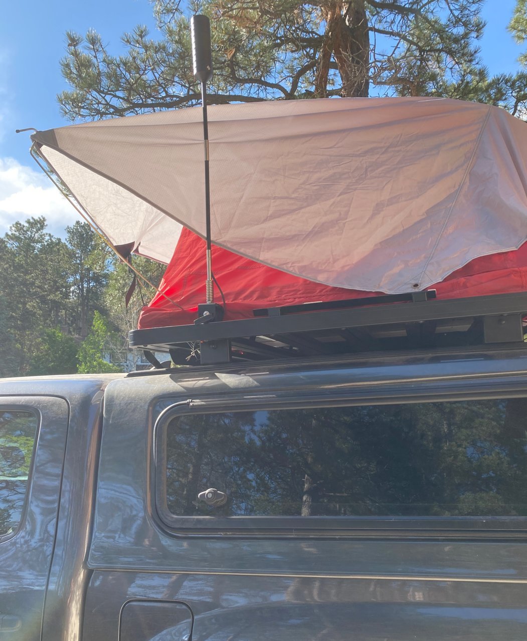

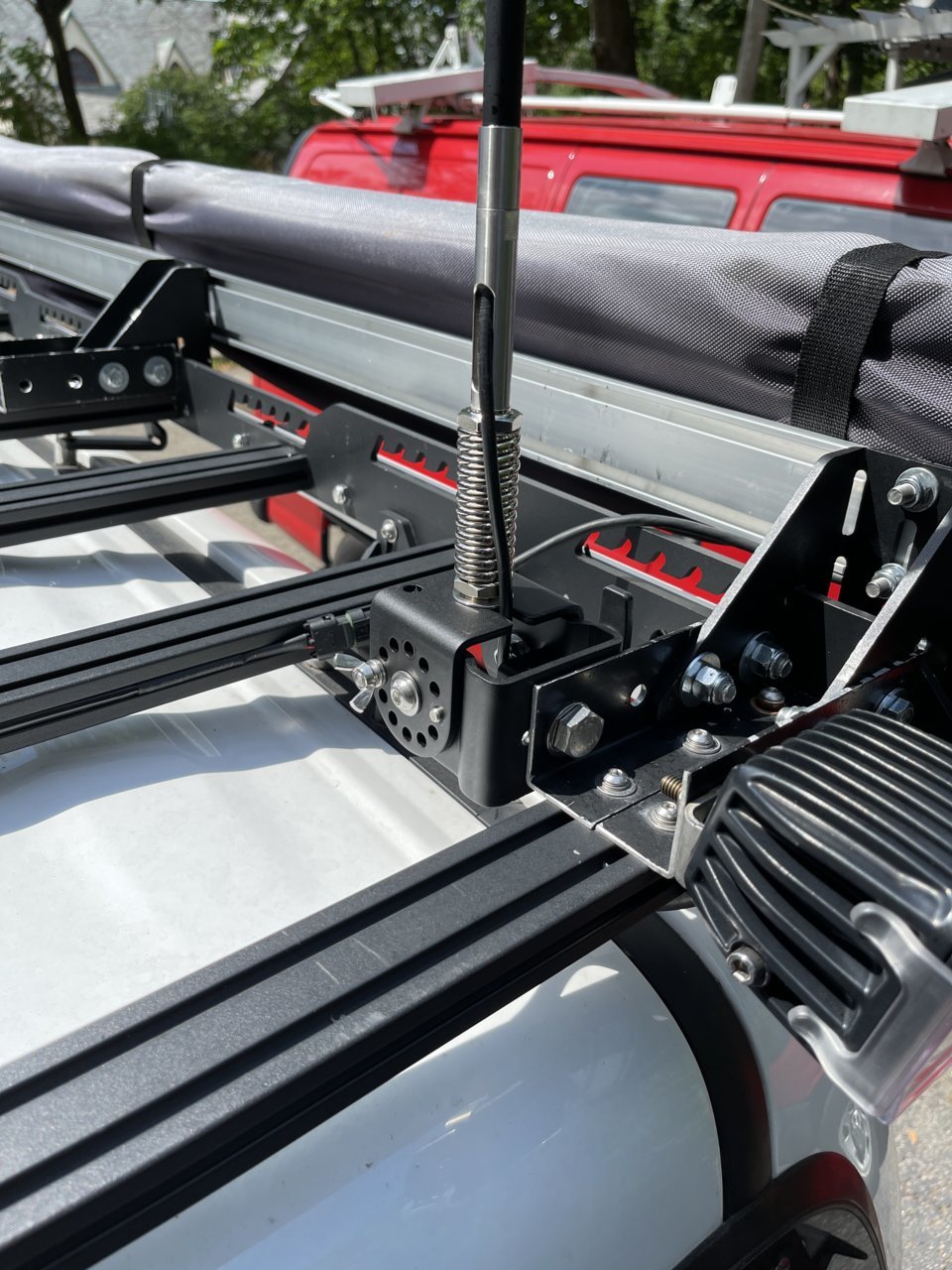

    Finally got around to doing the installation and grabbed a few shots as I was getting my tent prepped for the upcoming trip.

    thats nice!

    so rhinorack fits on front runner

    Yup. Worked like a champ.

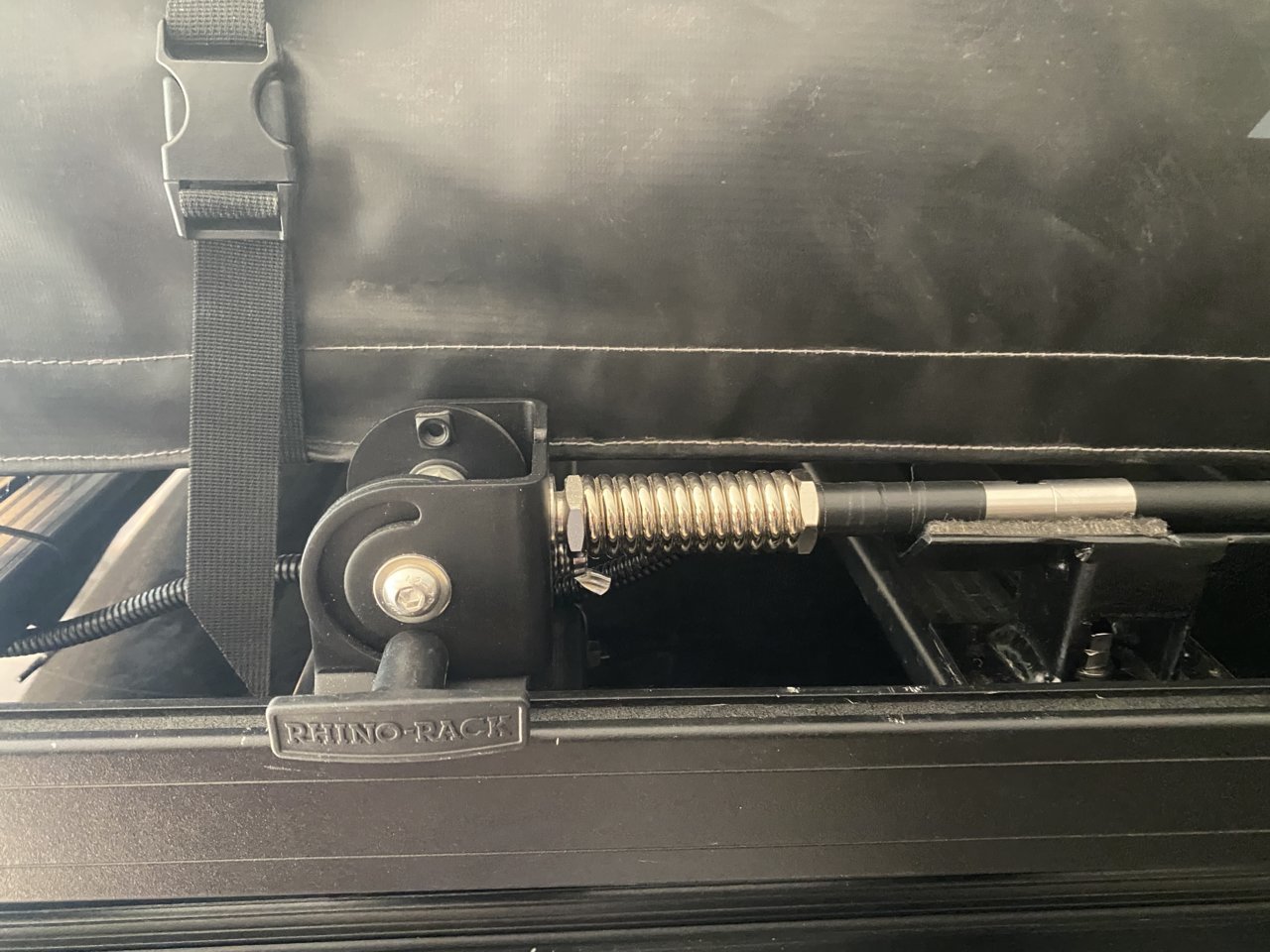

    Also works on any other roof rack with some ghetto ingenuity…

    i would call that creative, not ghetto.
