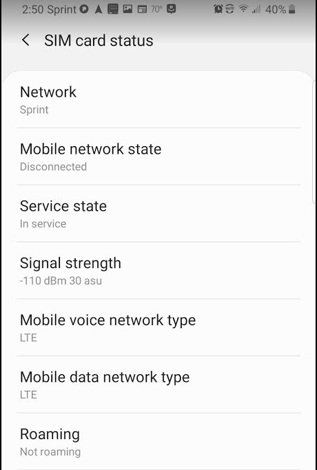

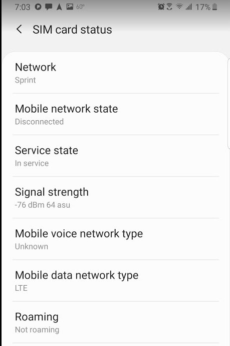

    Some screenshots as promised.
    After I made a comment on another member's post about signal strength, I received a PM from someone giving me a more technical explanation of how to measure signal strength. I think my comment was something along the lines of "So you went from 2 bars to 5 bars for the laymans like myself." Regardless, it seems as though the number of bars is not a good measure of signal strength as it can vary by phone (i.e. iPhone vs Samsung vs LG, etc.). For those who want to dive into a little more, here's the article: https://www.weboost.com/blog/how-to-test-signal-strength-on-your-phone
    For those who don't want to read the article, I'll summarize. Signal strength is measured in decibels, much like that of sound. However, it isn't the same dB as sound, but rather dBm. Don't ask what the m stands for. If you cared that much you'd have read the article. but the closer to 0 the better.
    Before turning on my WeBoost Drive Reach OTR Fleet model, I was pretty constant at -110 dBm. As you can see on my phone, I had approximately 2 bars (again, arbitrary and not a good measure). This dBm measurement was not constant. It fluctuated a bit. The worst that I saw was -114 dBm and the best was probably -97 dBm. Regardless, -110 dBm seemed to be the "return to normal" after brief changes in signal strength either direction, so that's what I'm going to use as my baseline for the un-boosted signal.
    After powering on the booster, it seemed to be pretty consistently -76 or -77 dBm.
    So that's an overall improvement of about 34 dBm. and a 38 dBm improvement if you go from worst to best.
    I found that signal strength was best when the phone was within about 3" of the internal antenna. My WeBoost owners manual calls for mounting the internal antenna 18 to 16" away from the intended use area of the phone. I did find signal improvement in this range, but not as good as the 2-3" area.
    I often find myself using the Bluetooth in my truck and keeping my phone in the cupholder area of the center console. I think I'm going to permanently mount the internal antenna in the area below the AC controls.

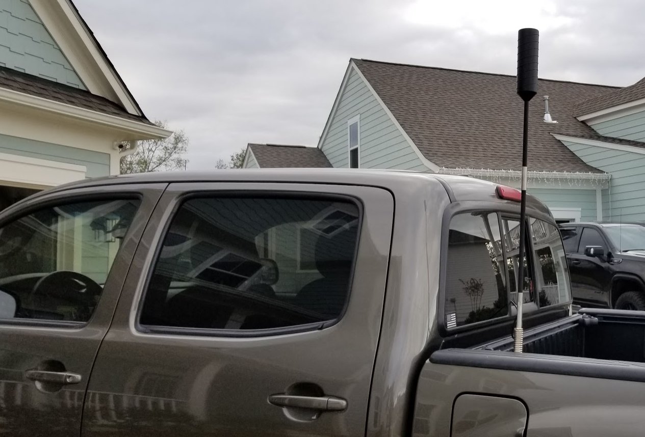

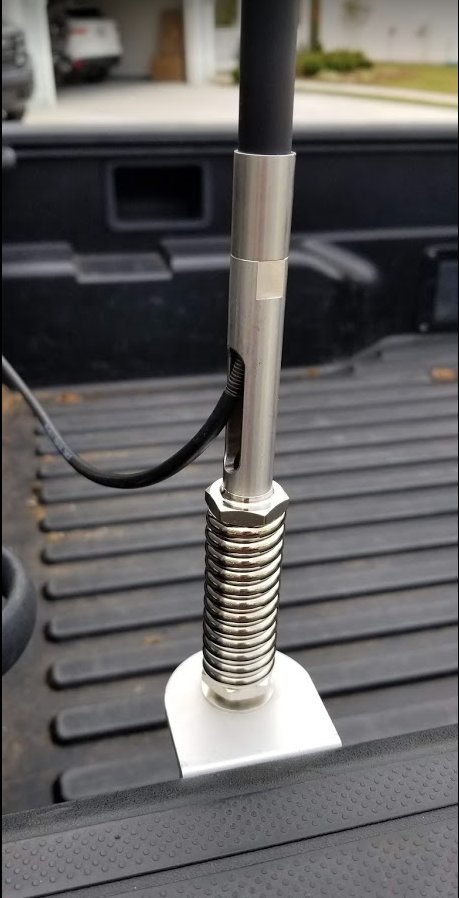

    Oh, I also used one of the antenna extensions and the side exit mount with the spring.
    It's a pretty tall setup, but I figured it would be best to have it above the cab for best results. I'm going to look into a folding mount so that I don't have to keep it upright the entire time. As it is now, I can't get into my garage.

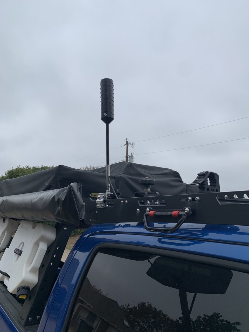

    Got mine installed this morning.
    This will NOT be the antenna mount that I will keep. I plan on switching it out for either a powered model, or a folding one.

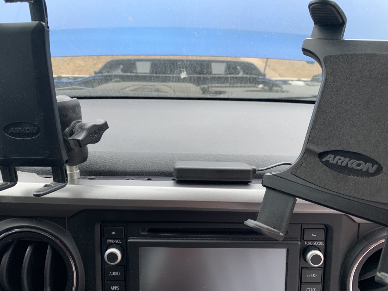

    Installed mine under the pax seat, and used the power supply plugged into the center console. This will also be replaced. I have a hardwired power supply coming, and this will be wired to a switch in one of the empty switch blanks soon.
    I routed the internal antenna from under the seat to the center console body, up forwards to behind the HVAC/head unit, and out the top of the DIMM so that it rests on the top of the dash.
    The external antenna wire was routed down the front side of my roof rack, and then tucked into the windshield channel down into the engine bay, under the body, and up into one of the grommets on the floor. I ran the tail of the cable under the carpet to one of the OEM cutouts, and then attached the connector to the amp unit.
    Once I powered it up, I got 2 bars of improvement, which is pretty good here at home where at times I have 1 bar.
    Anybody know a good rack-friendly antenna mount that folds down?

    @llod did a fold down style mount using a RAM ball mount. He goes over it his Comms part 1 video.
  19. Nov 23, 2020 at 5:45 AM
    #99
    Landpirate
    Landpirate Strong like horse, smart like tractor
    Jul 17, 2018
    #259719
    951
    North Texas
    2018 Tacoma BBP SR5 4x4 DCSB
    OME HD leafs, 5100s, CaliRaised skids, UpTop Overland Bravo, KB Voodoo rack, Overlander RTT/awning, DECKED
    If that actually held up in slipstream I would be amazed. RAM mounts can usually be moved just by hand, much less 70MPH wind pushing against a milk jug 17" over the roofline.

    That's true. It might be more for when he isn't on the move. There is one that folds down, made by Front Runner, but no idea as to how that would mount up on any rack besides the Front Runner one itself.
