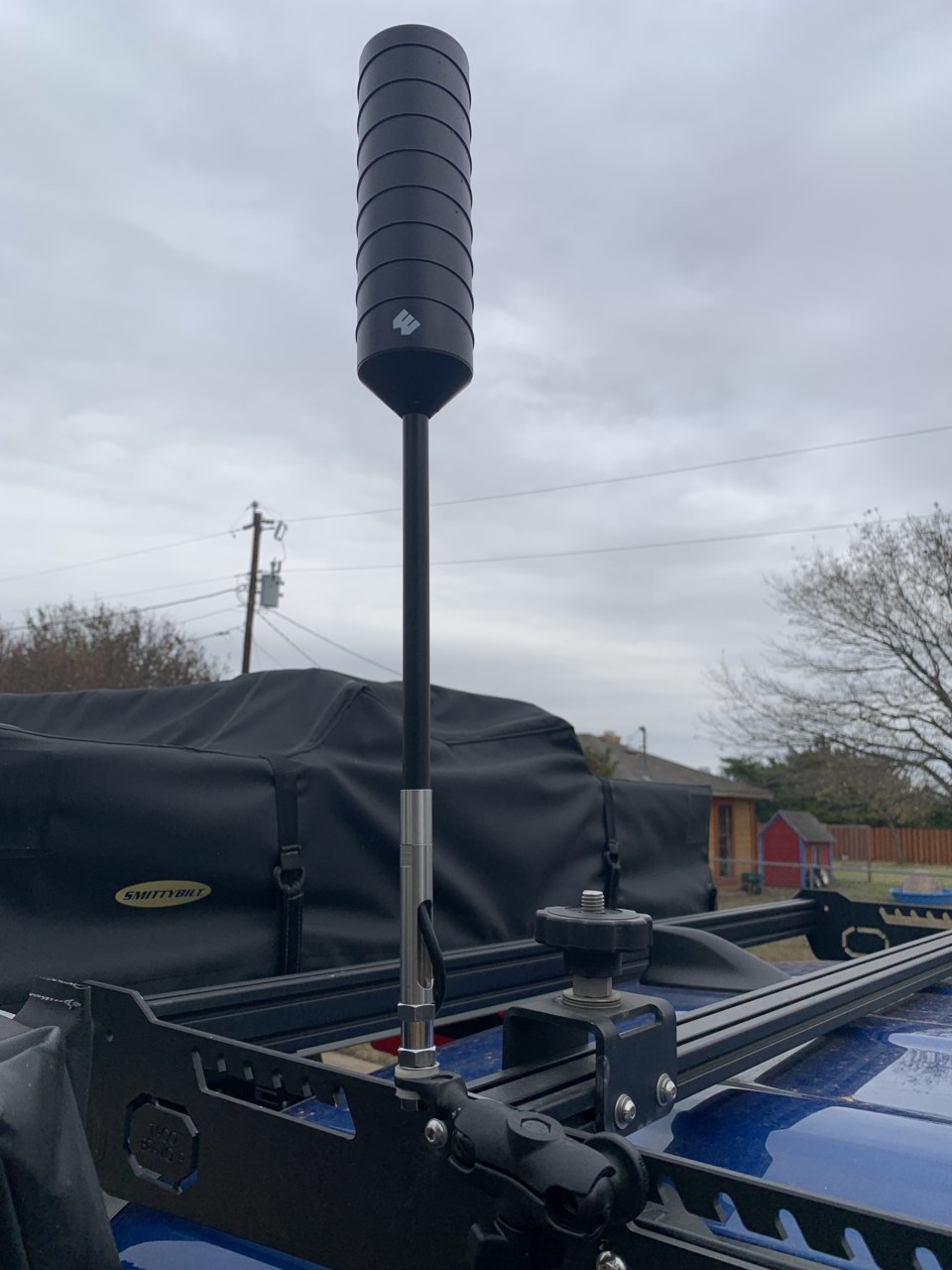

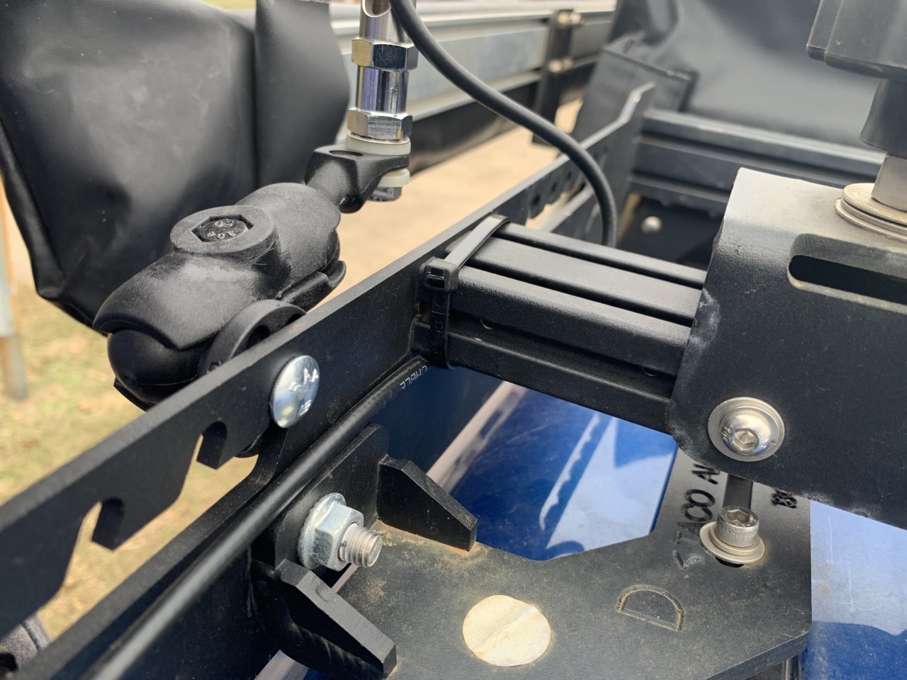

    @CttAznRanger here are some new pics of the mount and how I changed it today. I've noticed that the antenna cable is getting pulled on quite a bit with the way the antenna mast gets pushed back by slipstream. I also didn't like the crappy rail system bolt hardware that the ball base used. I went in to look for a fender washer and 1/4" bolt to use on the mount for a little more purchase. I couldn't fine any that would work, but I did find a carriage bolt that was 3/4" long. I figured the square should on the carriage bolt would probably fit the slot in my roof rack, and it did. So I moved the base forward to make the cable a little more slack, and put the carriage bolt in the bungee slot of my rack. Very close fit, and it helps to prevent rotation. I cranked it down pretty good and the mount stayed in place for the drive home. I'll see if it stays in place or if it was the antenna cable tension keeping the mount from going further back.
    Here's the head of the bolt, pushed up into the bungee hook slot. The antenna cable now loops back forward over the load bar so there is a little more slack.
    The mount moved forward one slot set. Shows the ball base, knuckle, and 9mm ring pieces.
