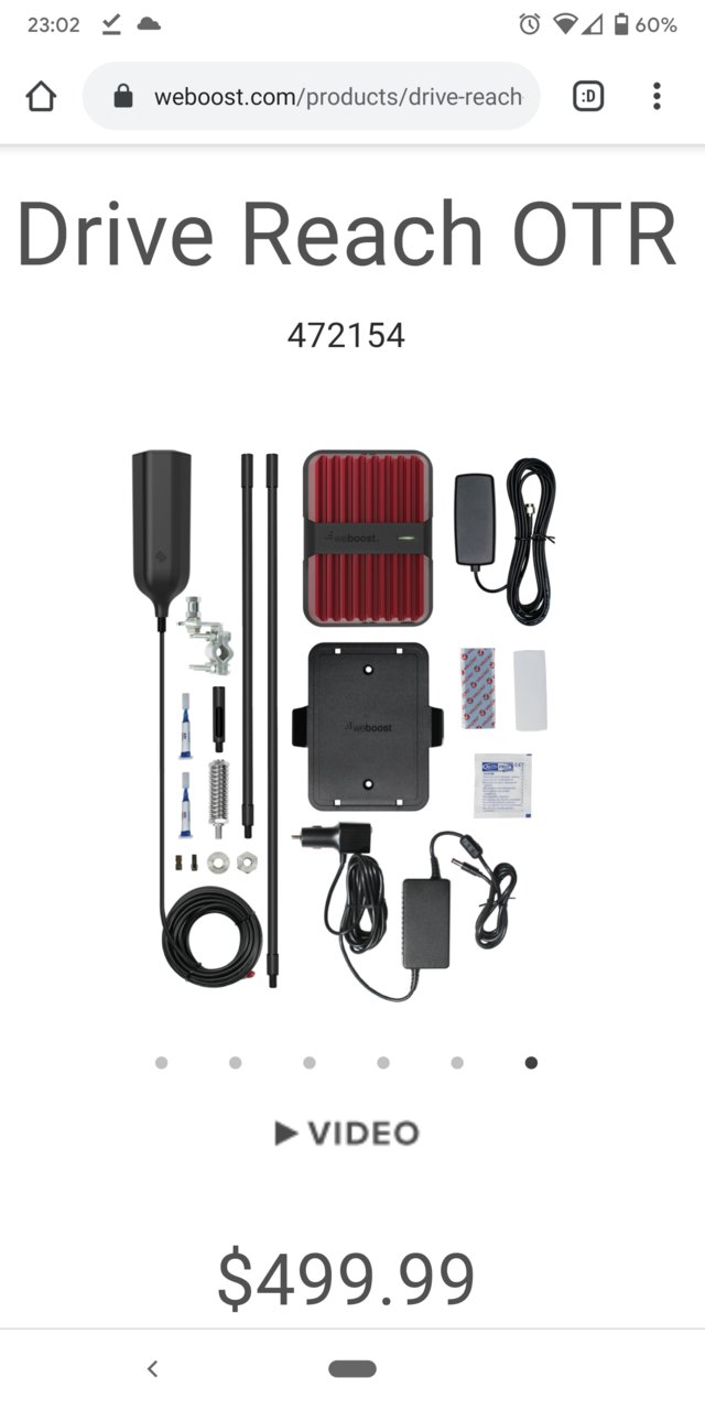

    But did anyone notice that WeBoost released an actual Drive Reach OTR bundle without an increased price, and a fancy new antenna?

    I did notice that. According to this youtube video, the new antenna is also better. 2.4-4.3dBi gain vs 2.5-3.5dBi gain of the the antenna most of us just bought. The antenna that came with the fleet package most of us just bought, came out in 2016. The new antenna came out in October of this year. The only difference I can see between the two packages is that ours came with the cigarette lighter plug cut off and an in line fuse in the box. Not sure what we paid extra for. The Amplifier seems to be the same.
    https://www.youtube.com/watch?v=6gElY4G4W8E[​IMG]

    I also noticed this and decided to email them to ask... I was thinking of purchasing the new antenna. Here is what they said:
    "The new 311229 trucker antenna has a slightly larger decibel gain range than your current antenna (311229 2.4 - 4.3 dB; 304415 2.5 - 3.5 dB), the cable is 1' longer, however, the 311229 can only get as high as 40" where the one you have can get up to 45" with all masts added. If you were to switch to the 311229 antenna I cannot guarantee you will see too much of an increase, so I would stick with what you have."

    Good info on both of these. Good to know that we won't need to upgrade our antenna.

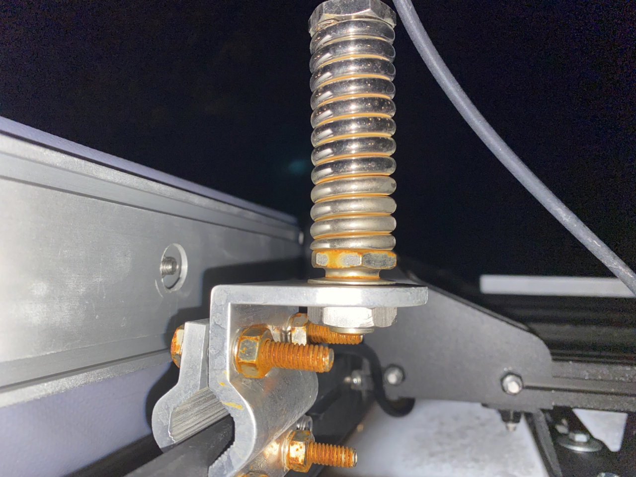

    On an unrelated note, if you haven't already set yours up and if you plan to use the spring/mount supplied with the antenna, spray it with something to prevent rusting. I went for a drive on the coast and the salty air rusted the spring and bolts in a matter of hours. Chrome is tacky anyway ;)

    Also, that's crazy about the spring. I'm gonna have to think about what to spray mine with...my other antenna (CB), on what I think is the same spring, has been on the truck for years and not rusted.
