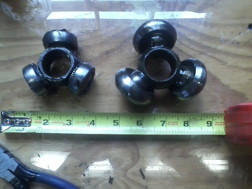

    Done. Boot installed, clamps salvaged until I get get good hose clamps. And....comments about aftermarket vs OEM strength holds out visually speaking.
    Left side is GSP aftermarket inner CV bearing Right side is OEM Toyota inner Cv bearing.0909121445a_aca157bf0cbb795aeef3af546abcbbed7e936139.jpg

    Yeah. I pretty much consider aftermarket ok for getting me home and that's all. Pavement only.
