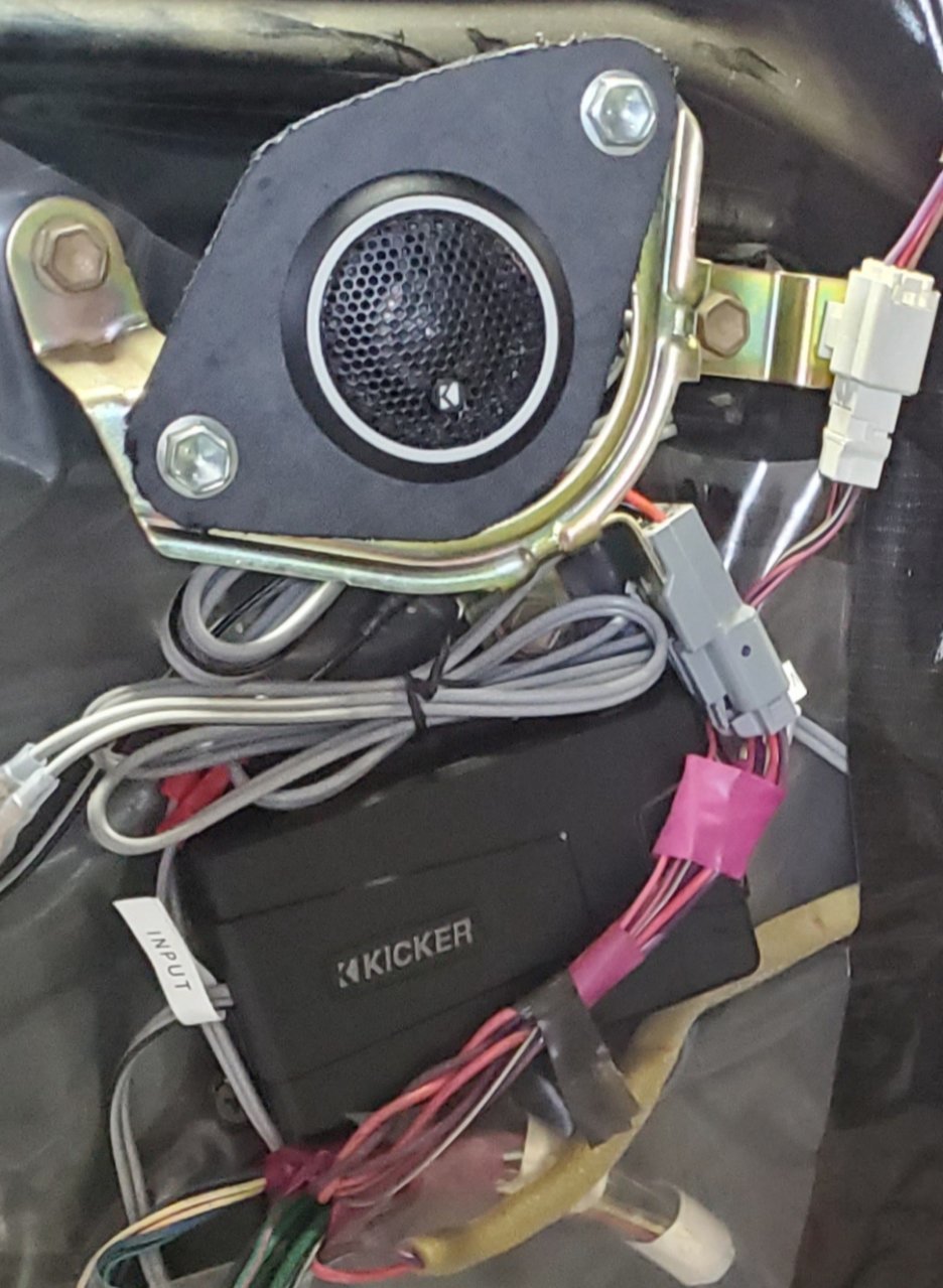

    Add on.. speakers installed and working!

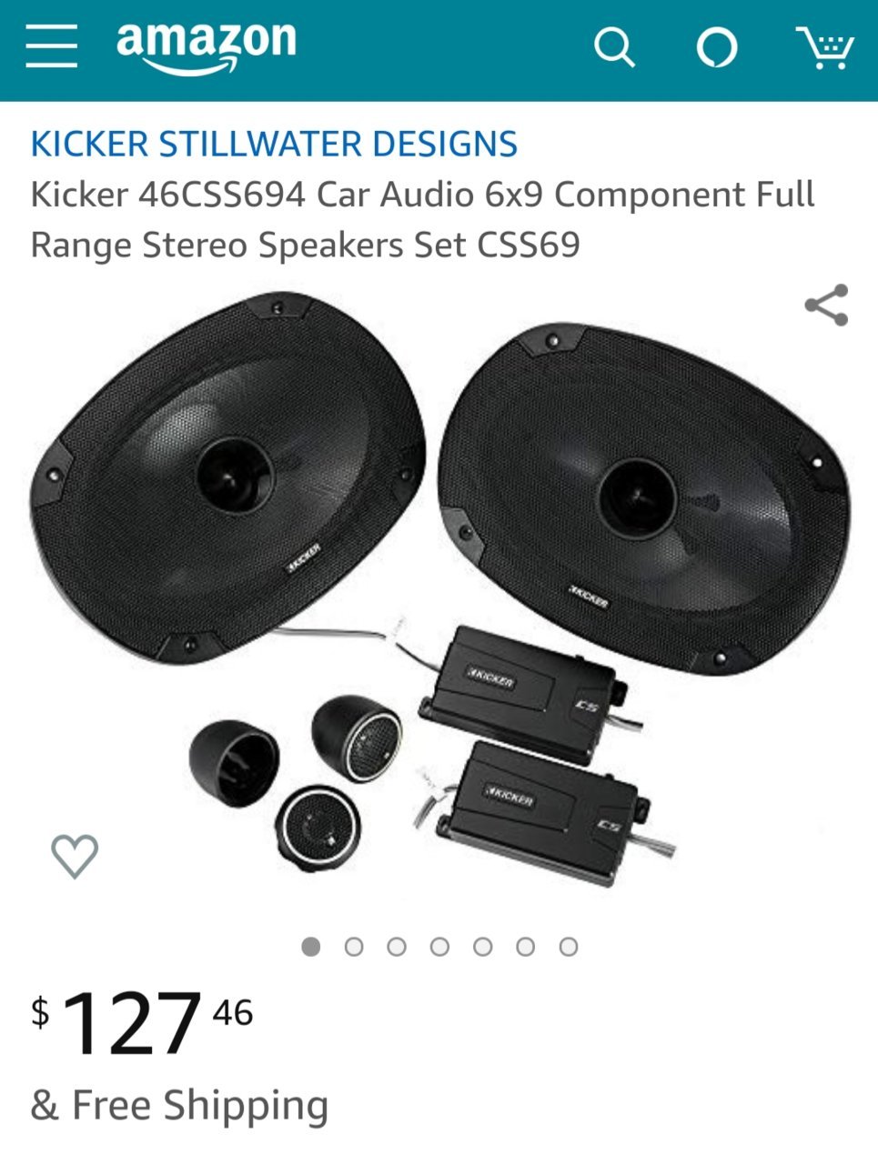

    That Subaru tweeter is made by Kicker! At $94 a pair you've got to be kidding! Lol! I bought the entire set on Amazon for $128 that included the woofers and crossovers. That's a $34 difference for a complete proper front set of speakers instead of a decent tweeter and a complete crap woofer with no crossover.

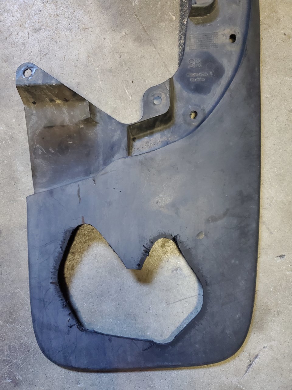

    The tweeters require a mounting plate
    but I finally found a use for that one mud flap I had

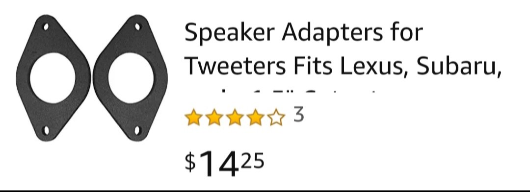

    Speaker mounts, called speaker adapters, are available to mount the tweeters and the 6x9's into Tacomas. I fabbed mine only because I'm out of cash. They're available at most any car stereo shop, eBay, Amazon, Crutchfield, etc... I get that electrical confuses a lot of people but it's still only two wires per tweeter and misinformation only makes it more confusing.
